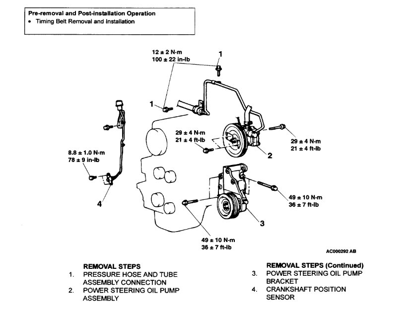

Hello my name is Justin. i have the car listed above Spyder GT. i was driving home the other day when out of no where the engine just shut off i pulled over and tried to restart it but no luck. it cranks fine but wont start. I changed the fuel pump with no luck. so i check the spark plugs and was not getting spark. i had a spare set of coils so i changed the coils and still no spark. Then i changed the cam shaft position sensor and still no spark. any ideas?

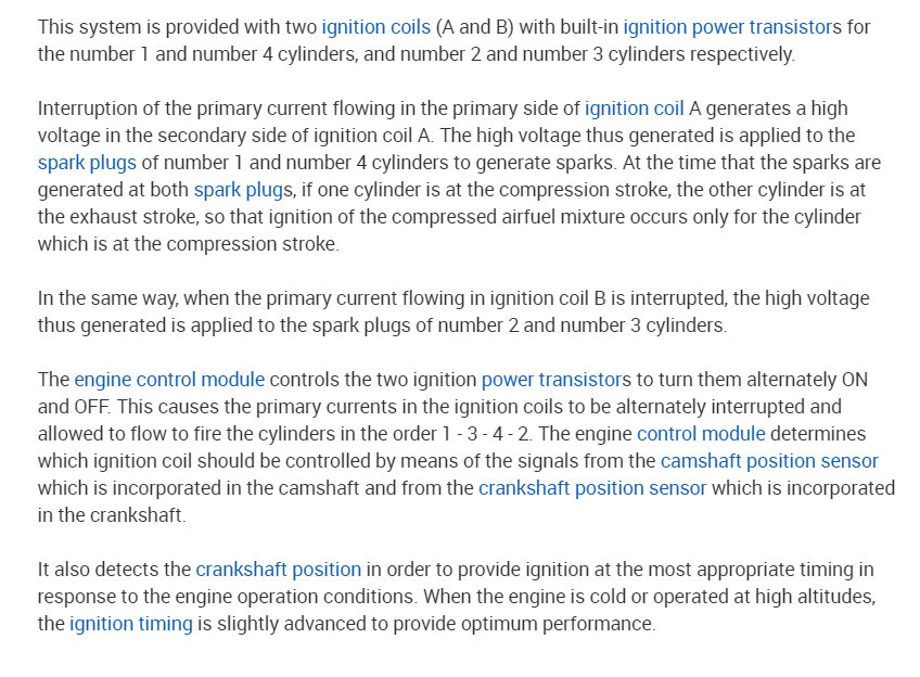

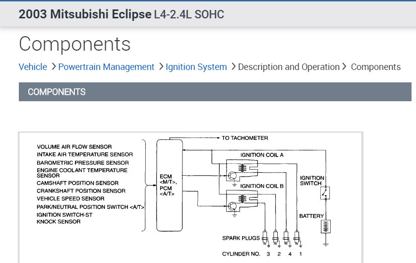

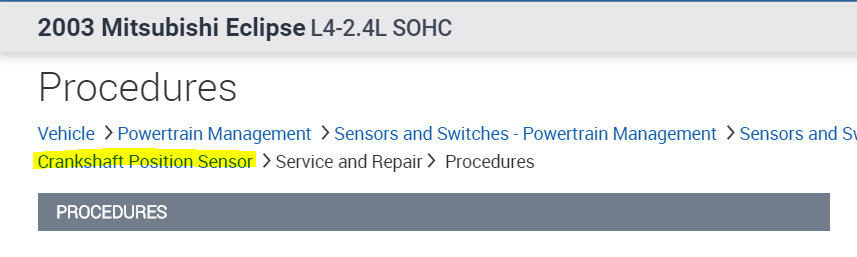

This could be a problem with your vehicle's Crankshaft Position Sensor [CKP] which is responsible for sending a signal to your vehicle's Power-train Control Module [PCM] telling it where the crankshaft is in the engine's 4 stroke process. The PCM uses this information to synchronize the ignition timing for the spark plugs and for the misfire monitor. In the diagrams down below I have included a wiring diagram of the CKP sensor circuit and a diagram showing your vehicle's CKP. Here is a link describing how to change it below:
Please get back to us with how everything turns out.
