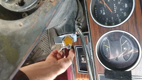

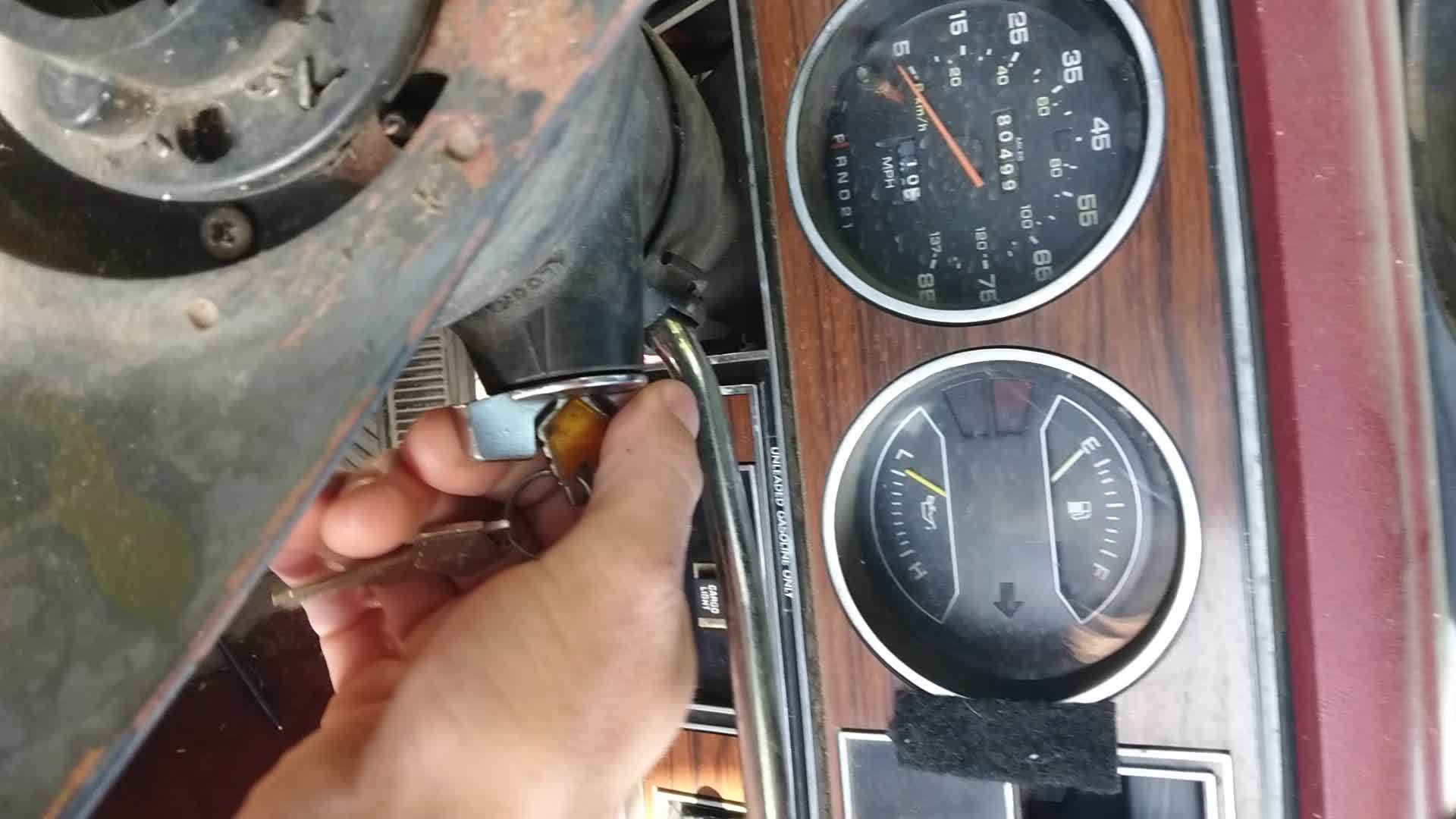

It does crank slow yes, never have seen a spark and I've tried every method to test for spark. I'm buying a new ignition switch today. It's only me doing all of this. I have to stand outside the truck to try and start it and check for spark. I'm praying you can help me. I've spent so much money trying to fix this truck.

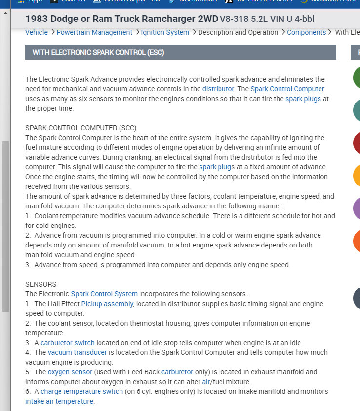

If it is cranking slow enough then that is the cause of the no spark. You need a minimum speed of the distributor to create the voltage spike in order to generate the high voltage needed.

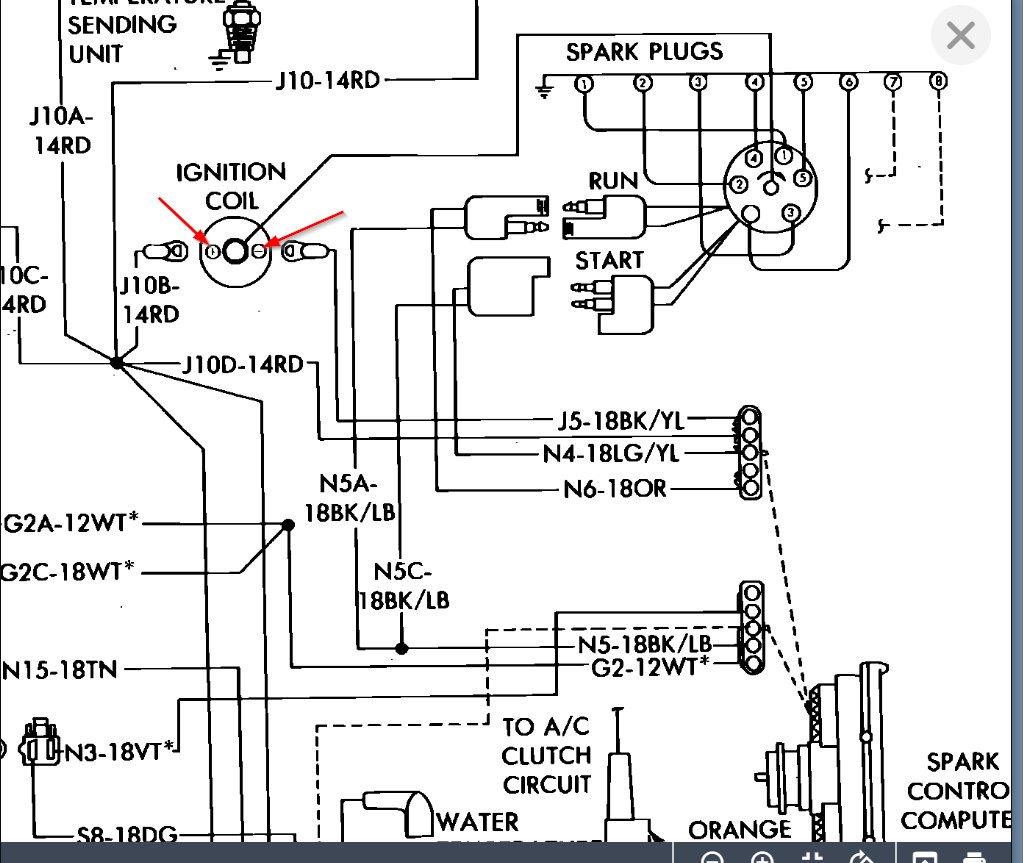

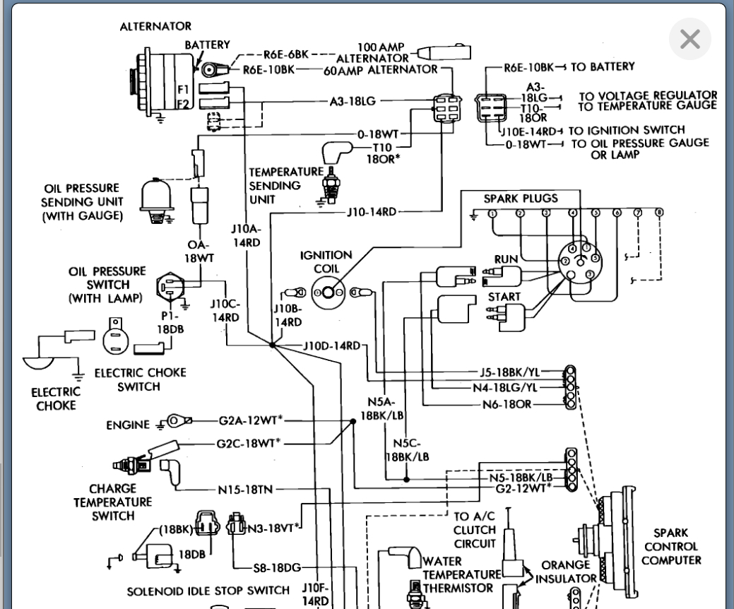

It is cranking slightly slower than normal but that is enough to fire the engine.
If we are getting no spark, then we need to check power through the system.
I understand that you have changed the coil and the distributor, but we need to find out if we are even getting power to the coil.
We should have 12 volts on the positive side and then ground on the other. This is going to tell us if the issue is before or after the coil.
