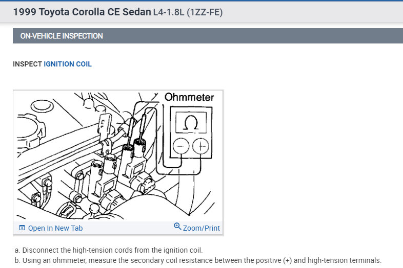

No spark, how do i check the coil pack?
1999 TOYOTA COROLLA
540,000 MILES • 1.8L • 4 CYL • MANUAL
MACCARTHY
I'm getting no spark, I've got new plugs.

Do you have spark at any of the spark plugs? If you don't, I don't think both coils would have failed at the same time. Chances are it would be a faulty crankshaft position sensor. Take a look through this link and let me know if anything mirrors what you have experienced:
https://www.2carpros.com/articles/how-to-check-for-ignition-spark
If you have a live data scan tool, check for an RPM signal when cranking the engine. If there isn't one, the crankshaft position sensor is my first suspect.

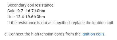

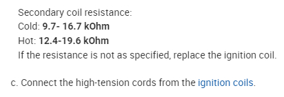

As far as testing the coils, you need to test secondary coil resistance. If you look below, I attached the directions and the manufacturer's specifications.
