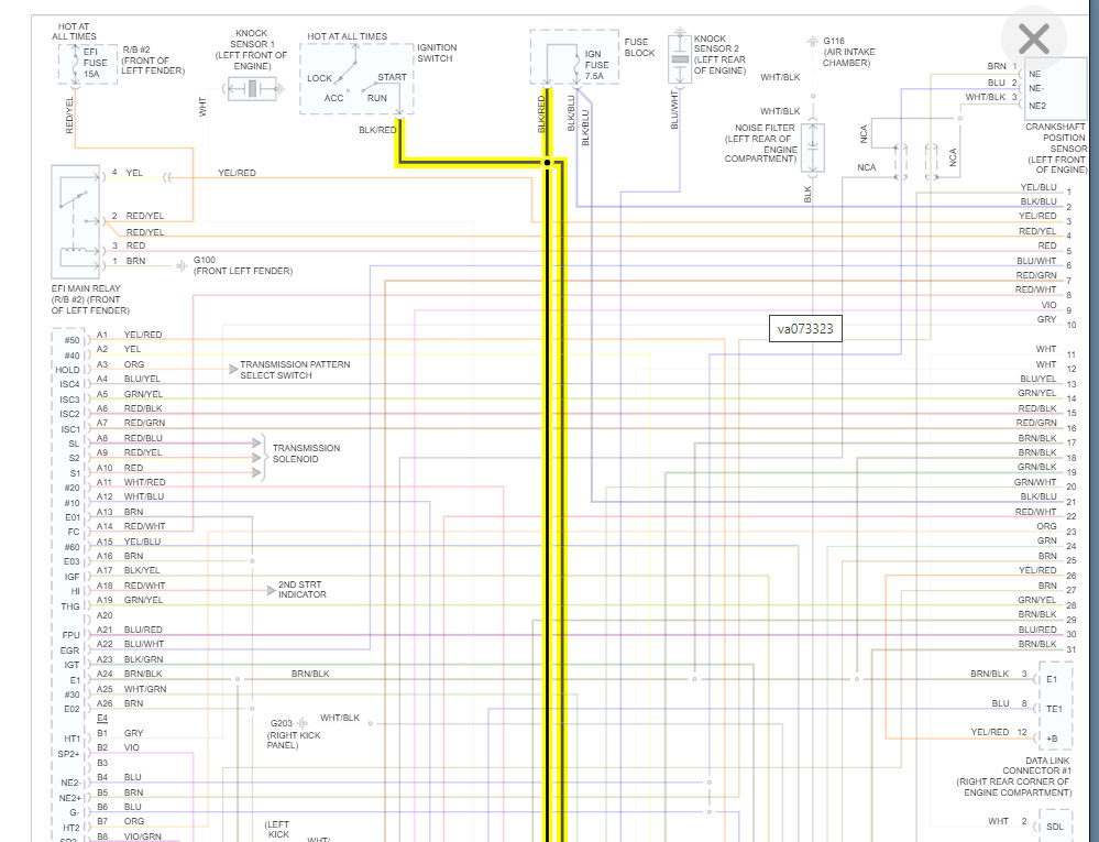

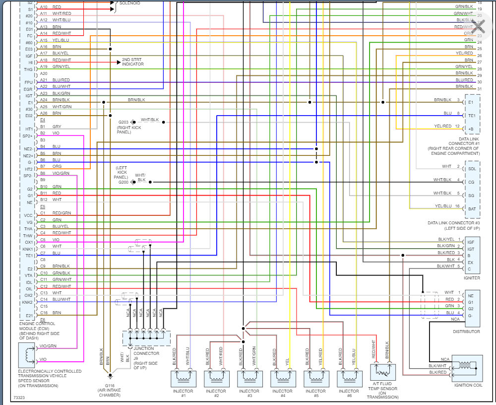

No spark, carburetor type engine, Distibutor type Delco, single coil 12-volt power is presented at coil. How to check pickup coil ignition module? Please give a wiring diagram of coil, ignition module and pick up coil. Thanks a lot
Feb 14, 2022 at 11:31 AM
If you have no spark, then you are on the right path. Here is a guide that will talk about how to test a coil:

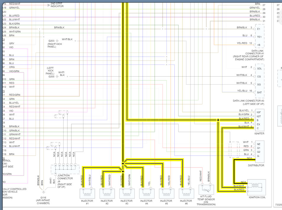

I am attaching the wiring diagram on the entire powertrain system and then I highlighted the coil circuits.
Basically, we need to check for voltage coming in from the igniter and make sure we have proper voltage.

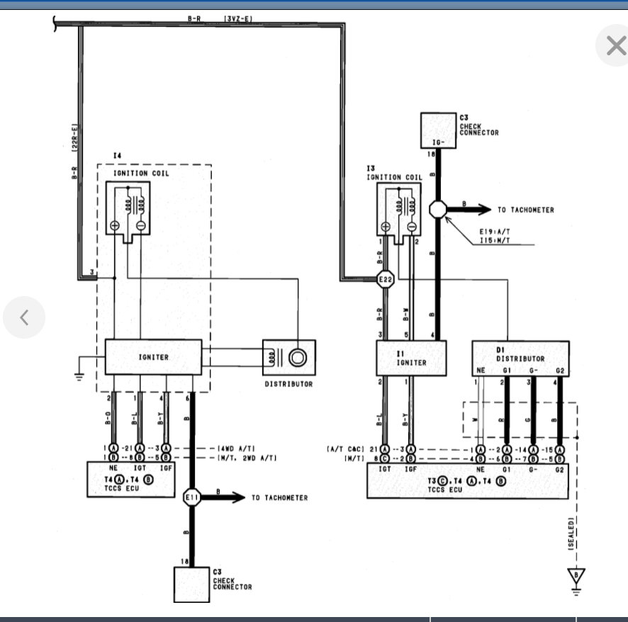

I understand. That means the closest we have to this is the 22R. I am not sure this is going to help you as even if it matches your system the wiring is not going to be the same.
However, I am attaching the diagram below anyway.

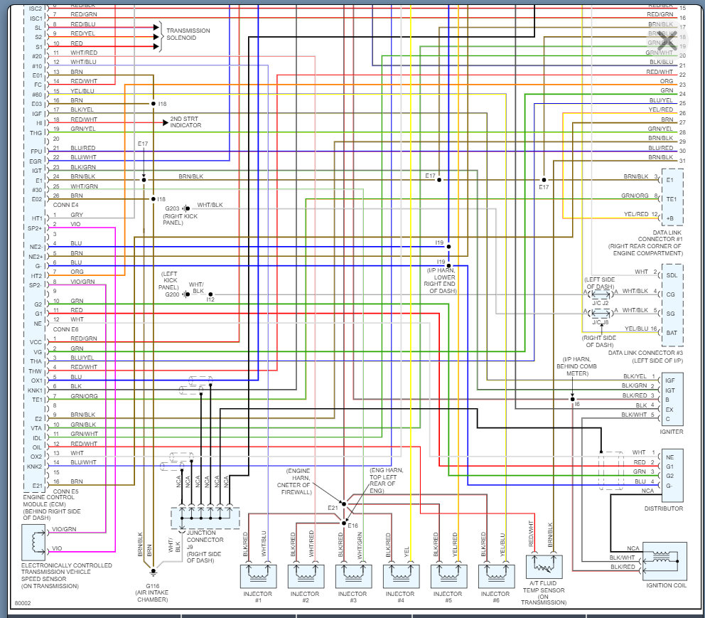

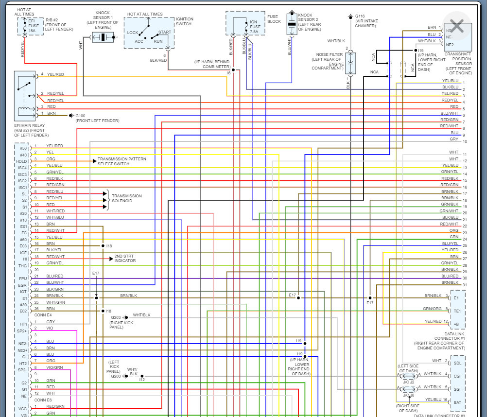

Hello sir good evening, today I found the details. Year=1997
ENGINE=IFZ-F
MODEL=FZJ75LP-MNUV
CC=4477CC

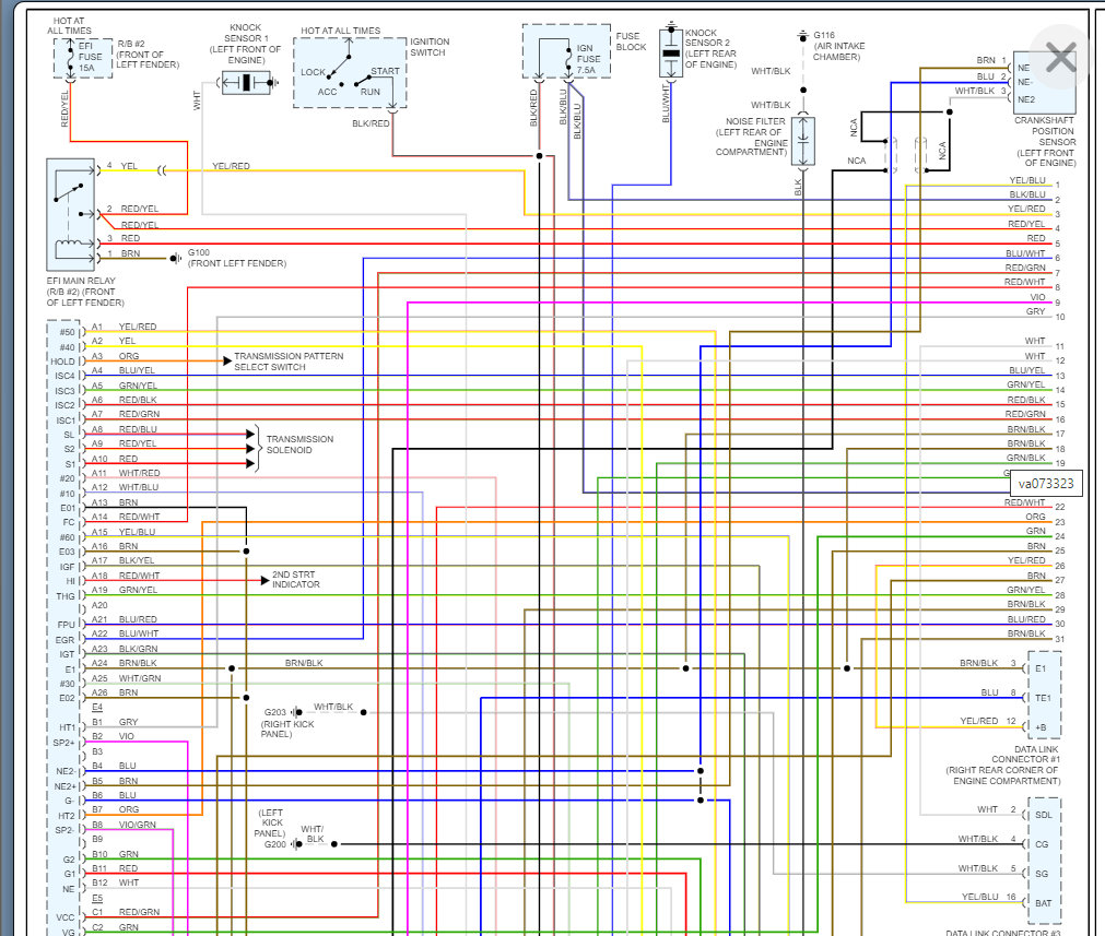

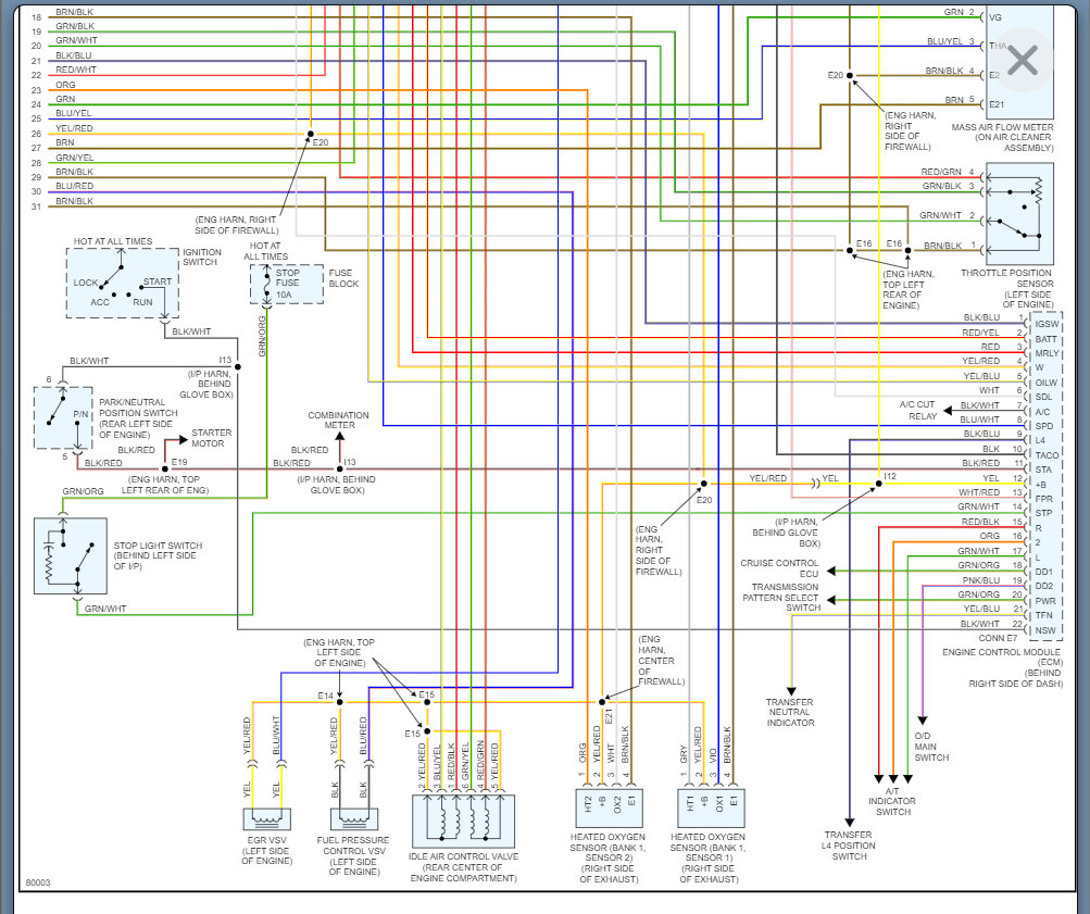

This type of Land Cruiser is present in Saudi Arabia . I need wiring diagram of the ignition system (distributor, ignition, coil and igniter) thanks.
Mar 4, 2022 at 2:06 AM

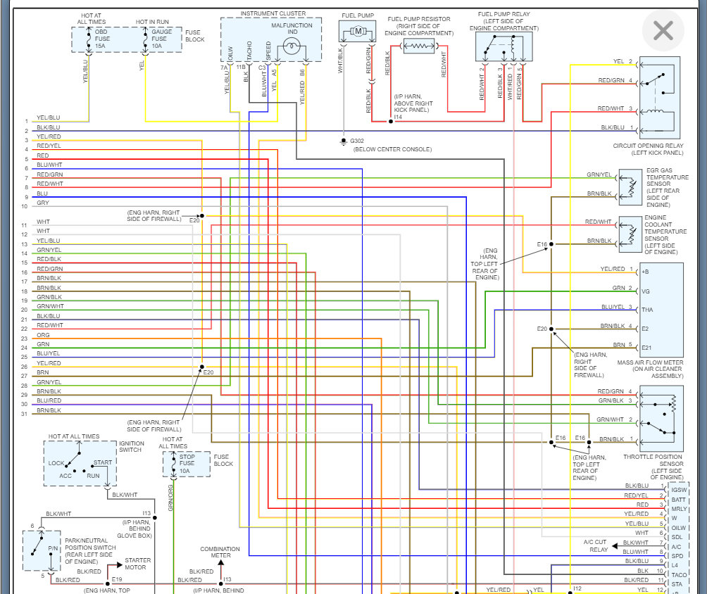

Per your request. Here are the complete wiring diagrams for this vehicle you listed.
Hopefully this gets you where you need to be. Thanks
