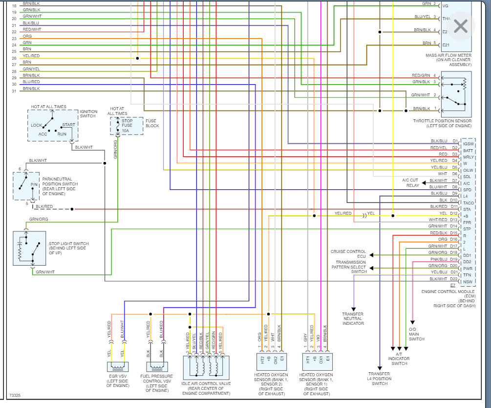

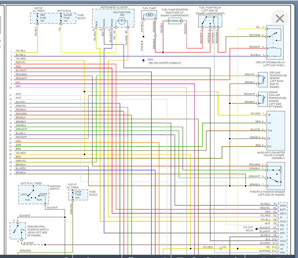

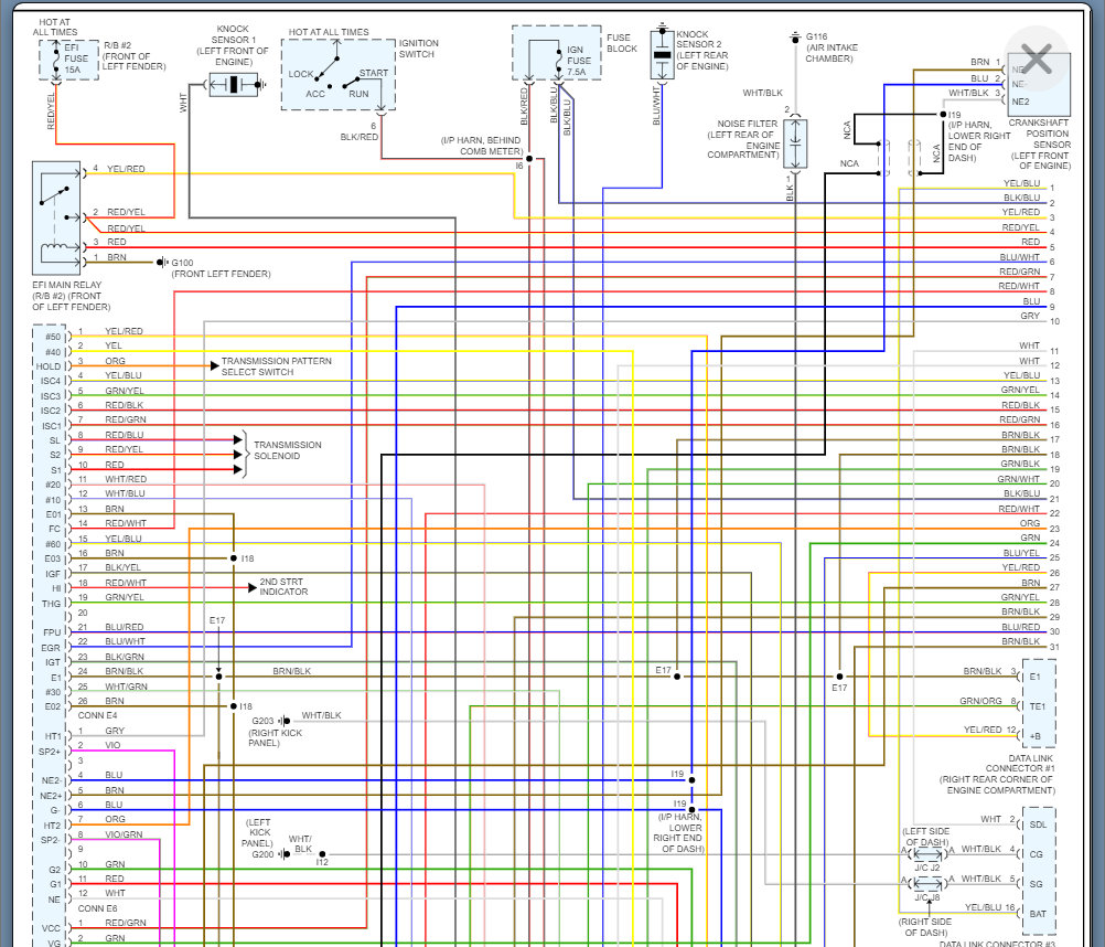

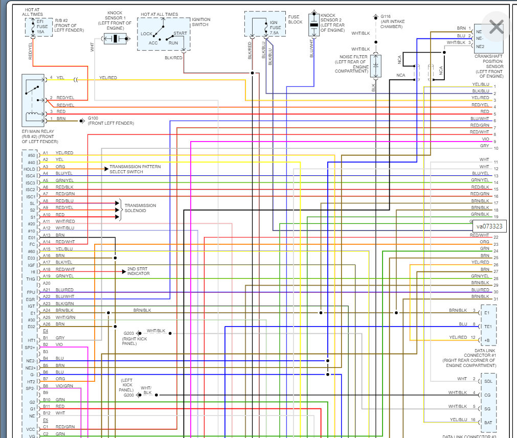

No spark, carburetor type engine, Distibutor type Delco, single coil 12-volt power is presented at coil. How to check pickup coil ignition module? Please give a wiring diagram of coil, ignition module and pick up coil. Thanks a lot
Feb 14, 2022 at 11:31 AM
If you have no spark, then you are on the right path. Here is a guide that will talk about how to test a coil:

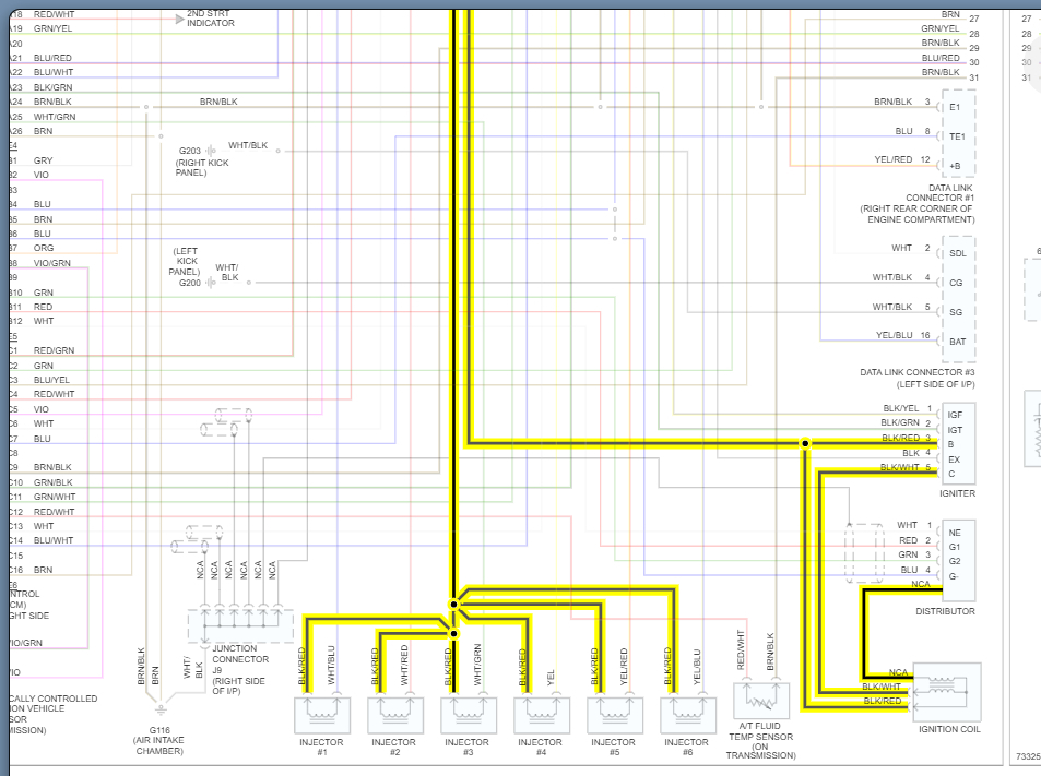

I am attaching the wiring diagram on the entire powertrain system and then I highlighted the coil circuits.
Basically, we need to check for voltage coming in from the igniter and make sure we have proper voltage.
Here is a guide that will help:
Please run through this info attached and let us know what questions you have.
Thanks

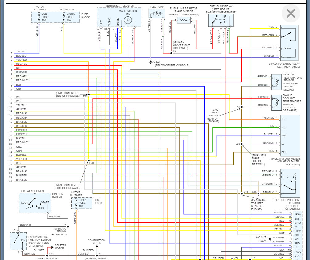

Sir, my question was related to a carburetor engine, but the answer is for EFI engine. please help.
Feb 15, 2022 at 3:07 AM
Sorry. I missed that. So, it appears this is not located in the USA as we did not have a carbureted engine option in 1995. The 1FZ -FE engine was the only option for that year.
Do you know the engine code of your engine? Was it 3F-E?

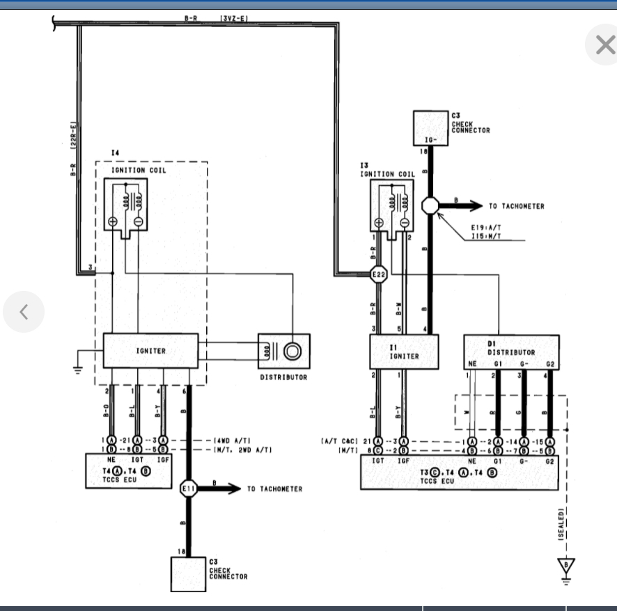

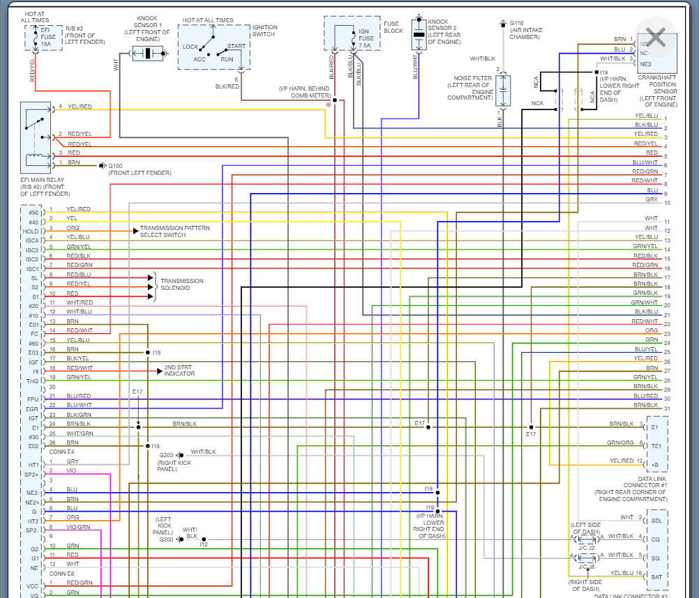

Sorry I am not sure about engine code but 2F or 3F has contact point in distributor. This Toyota land cruiser has pick up coil in distributor and ignition module near to coil.
Feb 15, 2022 at 3:16 AM

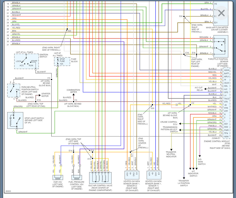

I understand. That means the closest we have to this is the 22R. I am not sure this is going to help you as even if it matches your system the wiring is not going to be the same.
However, I am attaching the diagram below anyway.

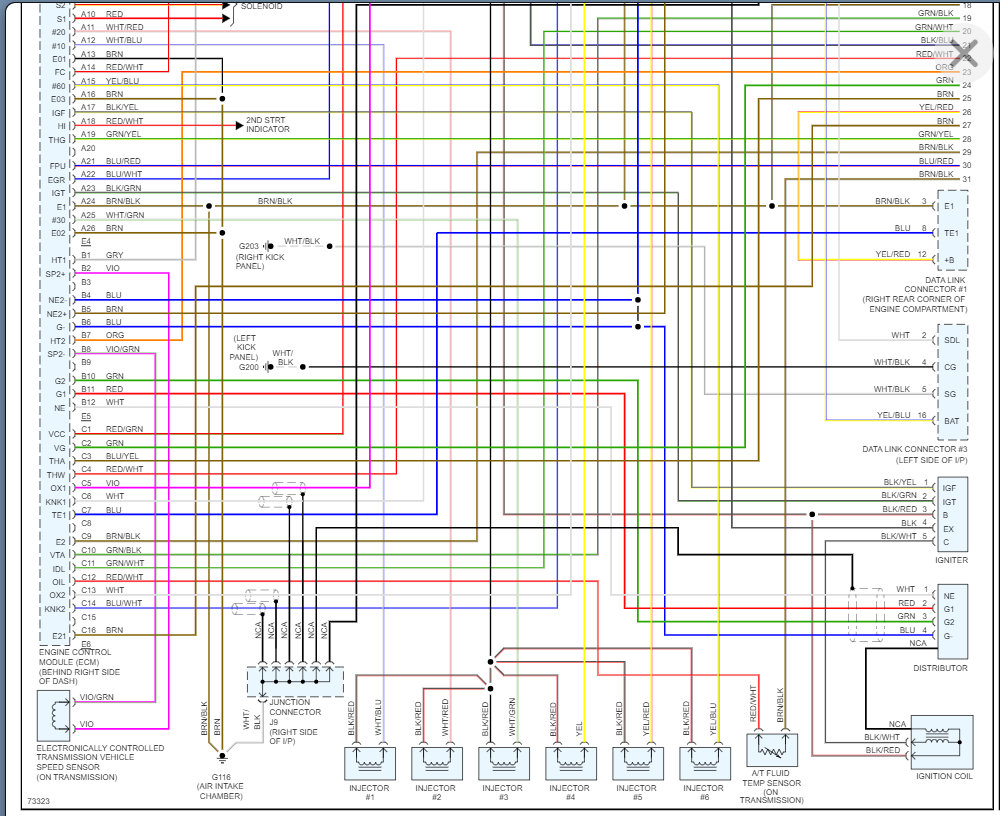

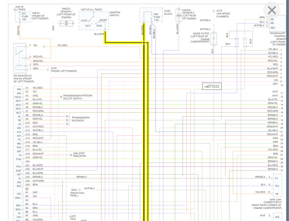

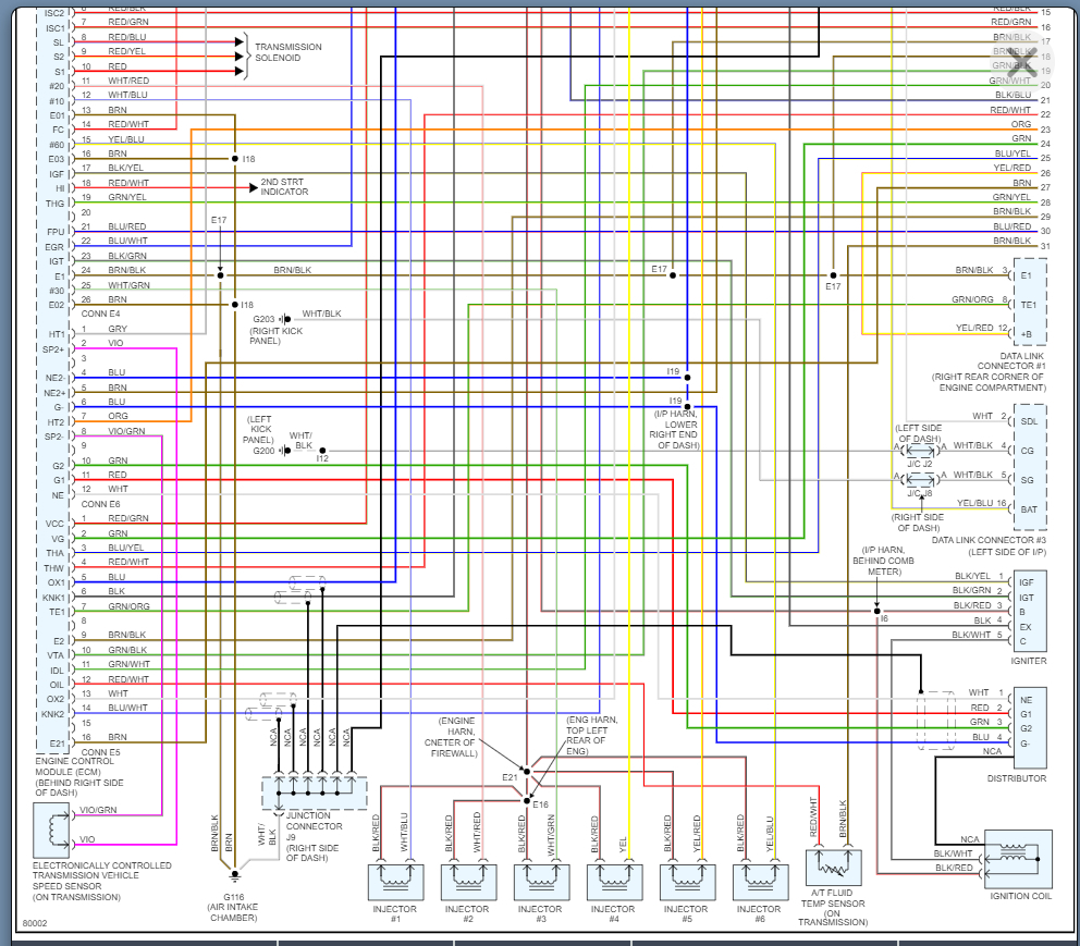

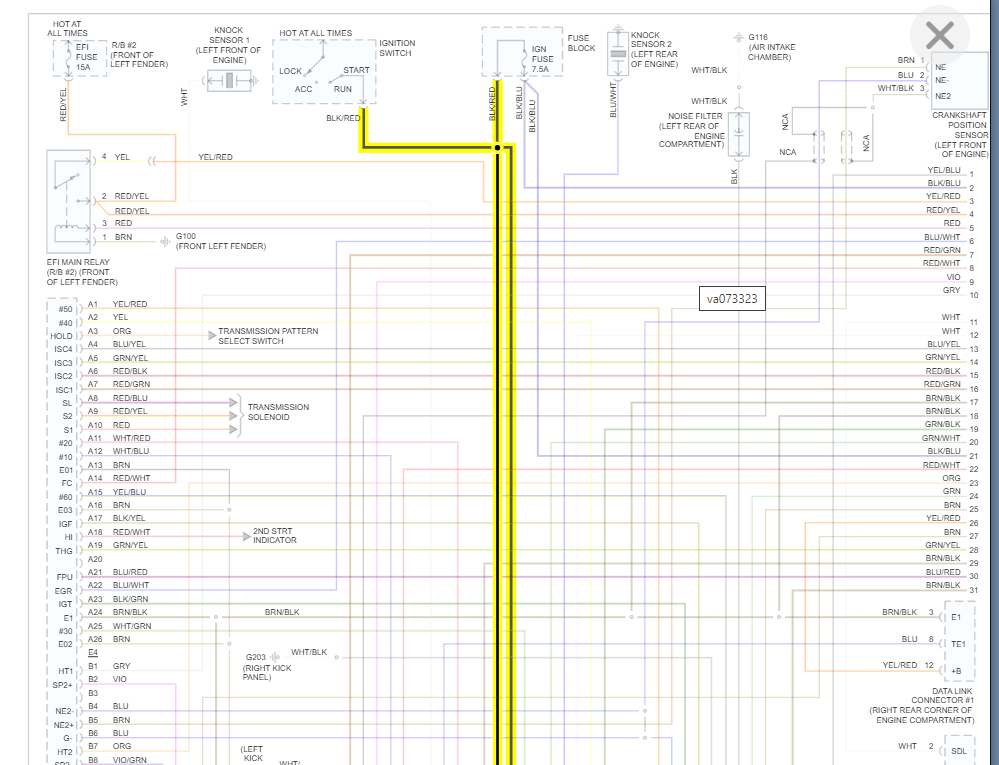

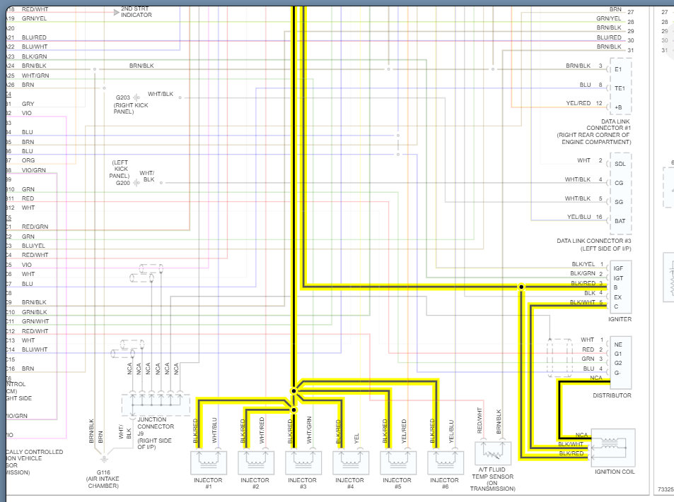

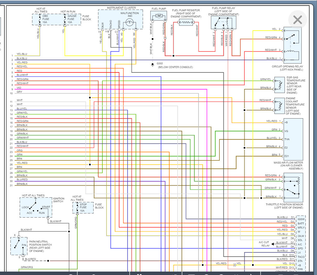

Hello sir good evening, today I found the details. Year=1997
ENGINE=IFZ-F
MODEL=FZJ75LP-MNUV
CC=4477CC
This type of Land Cruiser is present in Saudi Arabia . I need wiring diagram of the ignition system (distributor, ignition, coil and igniter) thanks.
Mar 4, 2022 at 2:06 AM
Per your request. Here are the complete wiring diagrams for this vehicle you listed.
Hopefully this gets you where you need to be. Thanks
