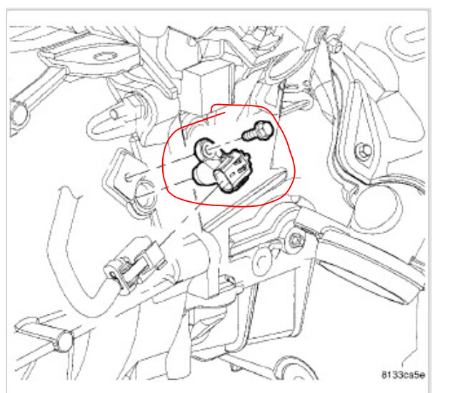

No spark after replacing the timing belt?
2009 DODGE CHARGER
216,000 MILES • 3.5L • V6 • 2WD • AUTOMATIC
RENEESOUP
Changed timing belt now won't start sprayed either in throttle body still nothing no spark.
Apr 18, 2023 at 3:21 AM
  • 110,240 POSTS
The timing belt in and of itself won't cause a loss of spark. By chance, do you have a scan tool that has live data? If you do, could you check if there is an RPM signal while the engine is cranking? If there isn't, check to make sure the crankshaft position sensor is still connected and not damaged. It's at the rear of the engine, so I'm doubtful that it was touched, but that is my first suspect when there is no spark at the plugs.
See pic below for CKP sensor location. It's on the passenger side of the engine/transmission.
