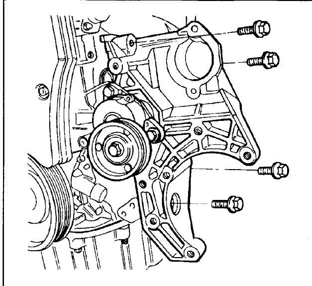

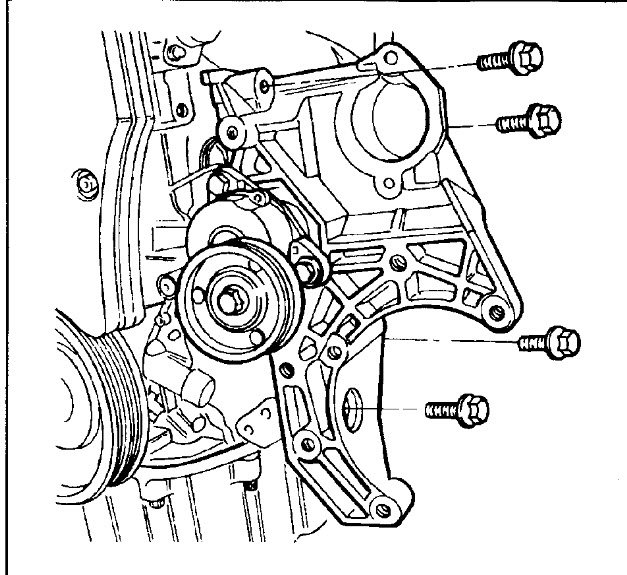

I have no spark! Two codes that are the same P1627 and two PO337 any help?

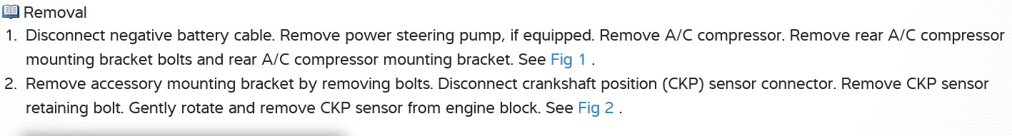

we have no code listing for this car but a chevy 2.2 it's pcm for 1627 and crankshaft sensor for the 337 code. try the crank sensor first then reset check engine light if 1627 comes back it may be a bad pcm
