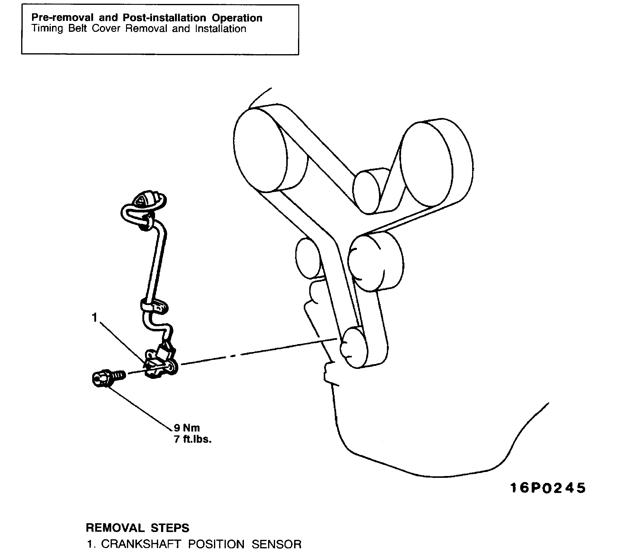

Drove home okay. Turned off vehicle.
Next morning . Engine wont start. Turns over but wont start. Pulled spark plug lead . Turned over engine, no spark.
Possible cause?

Any time spark is lost, my first suspect is the crankshaft position sensor. Now, testing it really isn't that hard, but it requires a live data scanner. Basically, plug in the scanner and check for an RPM signal. If none is found, the sensor is the most likely cause.
Here are a few links you may find helpful:
https://www.2carpros.com/articles/how-a-crank-shaft-angle-sensor-works
___________________________-
The attached picture shows the sensor and location.
Check this first and let me know what you find.
