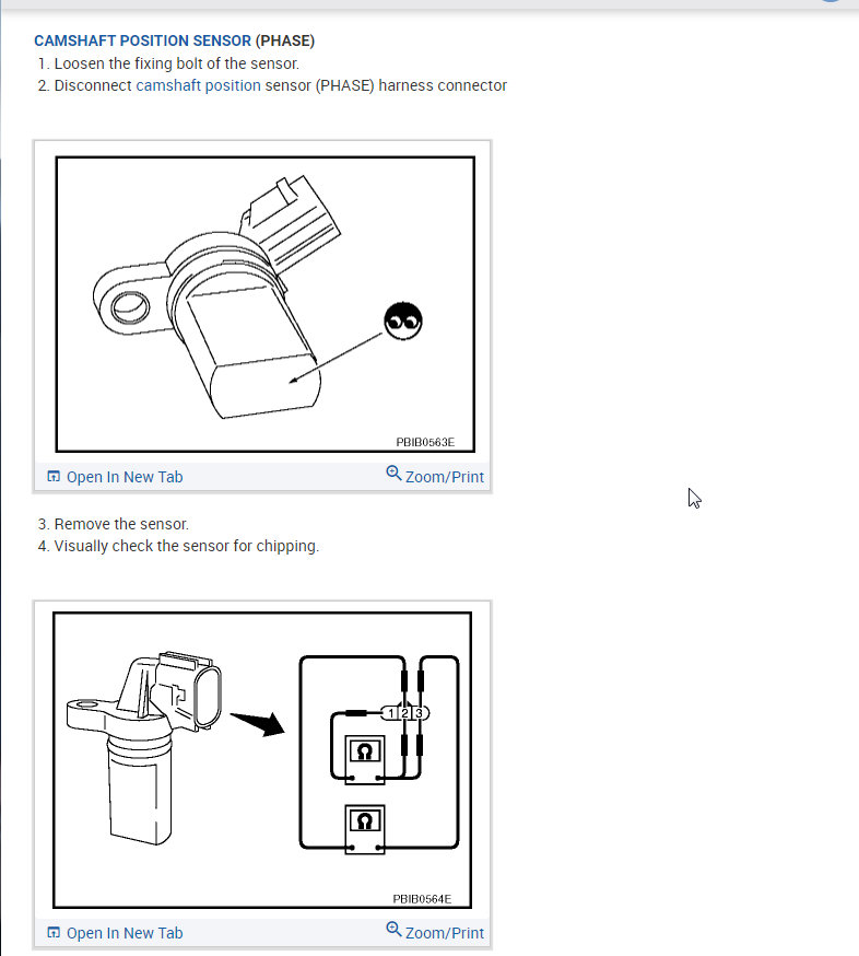

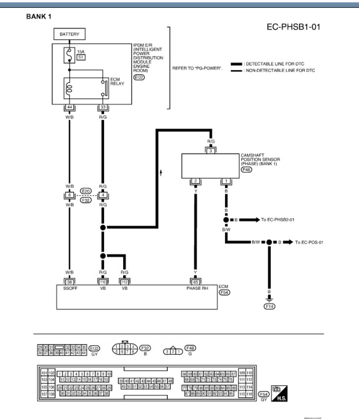

Hi. Any help is greatly appreciated. I tested the cam sensors for 12 volt and ground and I have both. Cam sensor is new and the resistance tests okay. But when I test the signal wire and turn the engine over by hand all I get is 10 volts. Off signal. It never switches to 0 volts. Both cam sensors do this. Cam sensor is from AutoZone and as I have learned they need to be OEM. So is it that these sensor just don't pick up the cam?
Nov 29, 2020 at 6:18 AM

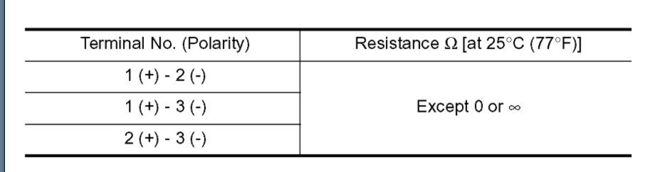

If you are turning the engine over and the sensor is reading 10 volts then it does sound like the sensor is faulty. I attached resistance testing that we need to run through just to see if there have an internal issue. I suspect the resistance readings will be off and show that they are the issue.
I have seen a number of times where the sensors are just wrong and do not function the way the PCM is expecting. So if your resistance is not correct then that would explain why your voltage is not changing.
Another way to confirm the sensor is the issue is to remove the sensor and connect it to the harness then monitor the signal wire and pass the magnet over a piece of metal. You should see it change. If not, it is confirming the sensor is not operating. Plus this is confirming the air gap is not the issue as well.

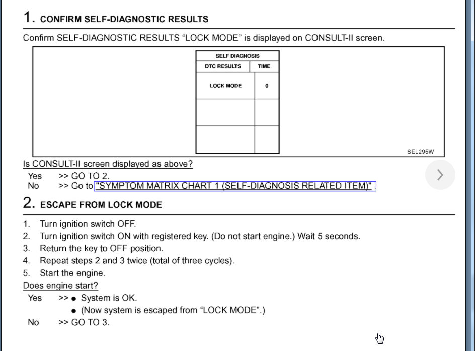

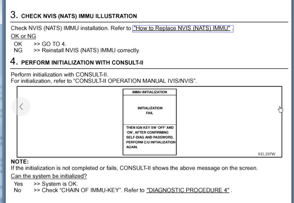

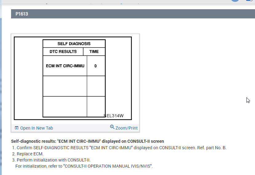

Hi. I just recently got another scanner, turns out I have a code 1610 and 1613. Any thoughts?
Nov 30, 2020 at 5:28 PM
Well that makes a little more sense. I am attaching the info for both codes. However, that is the cause of the no spark. The NATS system disables spark when there is an active code for it like this.
Let's run through this and go from there. Thanks

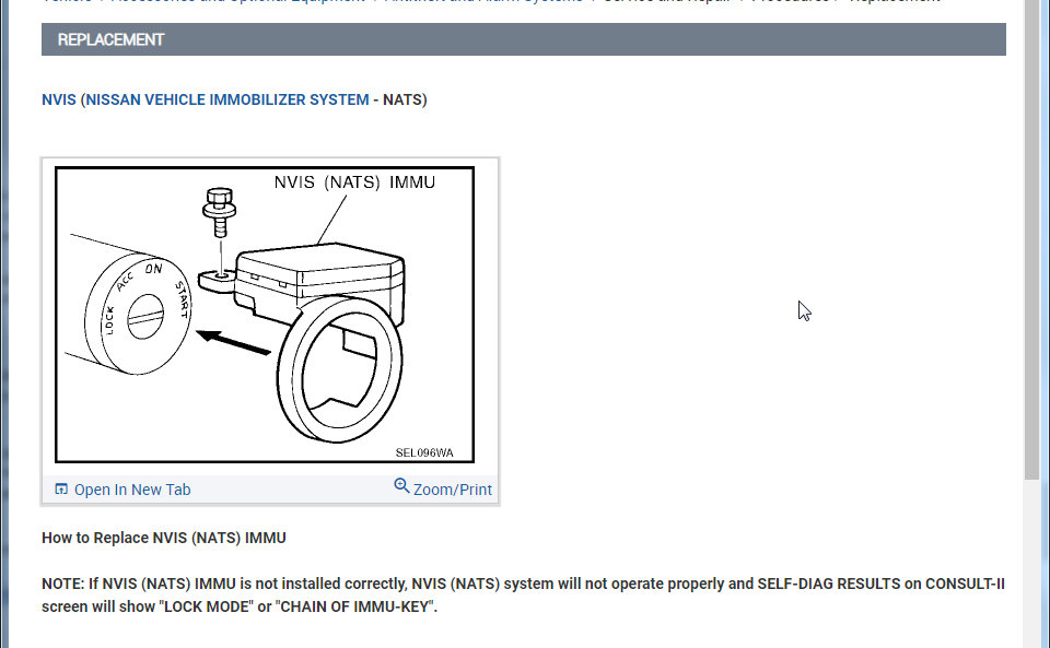

I waiting for a locksmith to reprogram me a key. I replaced the ECM and IMMU. I'll let you know what happens in a few.
Dec 1, 2020 at 10:20 AM
MSITTLE5
  • 11 POSTS
Okay, so the locksmith just reprogrammed me a key for a new IMMU. I also changed out the ECM but I didn't tell him that, because he would say it has to go to the dealer to reflash or whatever, but I'm not so sure I believe that. anyways, I am getting different codes now and the NATS malfunction is gone. Code for TCC lockup, crank sensor, and IAT. So I've made some progress. Still hasn't fired up, but I think it's crank sensor related. I have to change the battery right now. I'll be back.
