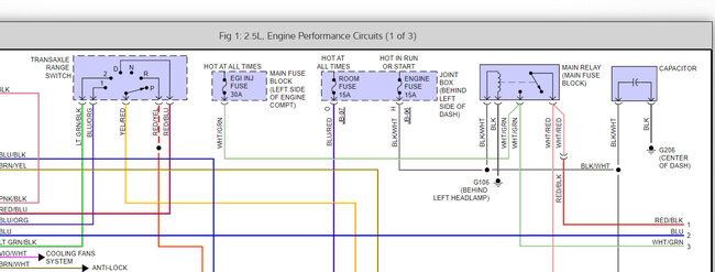

MY CAR HAS A NO SPARK NO START CONDITON. I REPLACED THE CRANKSHAFT POSITION SENSOR AND STILL NO SPARK. WHAT ELSE COULD BE THE PROBLEM AND WHAT ELSE CAN I TRY?

I would check the fuses int he diagrams below I have seen the coil short out internally so I would replace that if the fuses are okay. Check out the images (Below). Please let us know what you find.

I DID WHAT YOU SAID AND THAT DID NOT WORK, ANY OTHER SUGGESTIONS?

did you scan for codes? then check fuses under hood and main relay. then check resistance of crank shaft sensor 520-580 ohms between A & B

I DID CHECK FOR CODES AND I DO NOT HAVE ANY CODES. I CHECKED THE FUSES AND THEY ARE ALL O.K. I DID WHAT YOU TOLD ME I CHECK ED THE RESISTANCE OF THE CRANKSHAFT SENS0R THE READINGS ARE 210 OHMS. WHAT DOES THAT MEAN COULD THE SENSOR HAVE GONE BAD. IT IS ONLY A COUPLE OF DAYS OLD.

Re check the fuses and I found the EGI , inj fuse bad could that be the problem

yes and the crank sensor has to be checked out o f the engine
