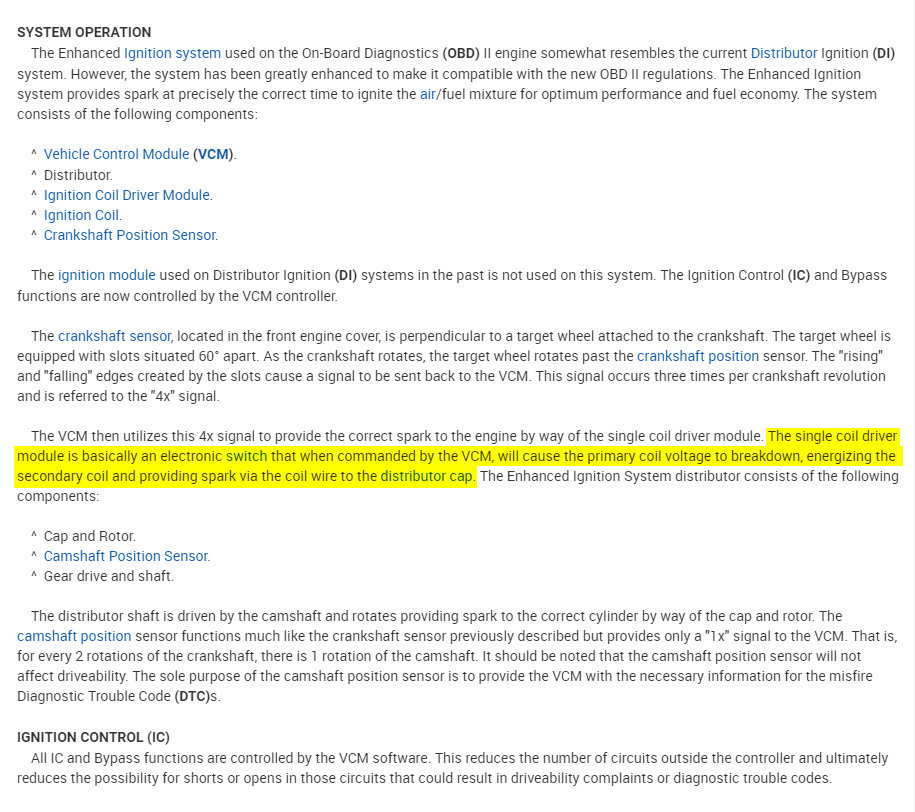

Spark at coil wire, no spark at plugs.
Nov 24, 2019 at 8:36 PM
Do you have spark at the distributor cap? Basically the coil delivers spark to the cap so if you don't have it there then the coil is the issue. If you do then the cap/rotor/distributor is the issue.
Take a look at this attachment let me know what you thing. Thanks
