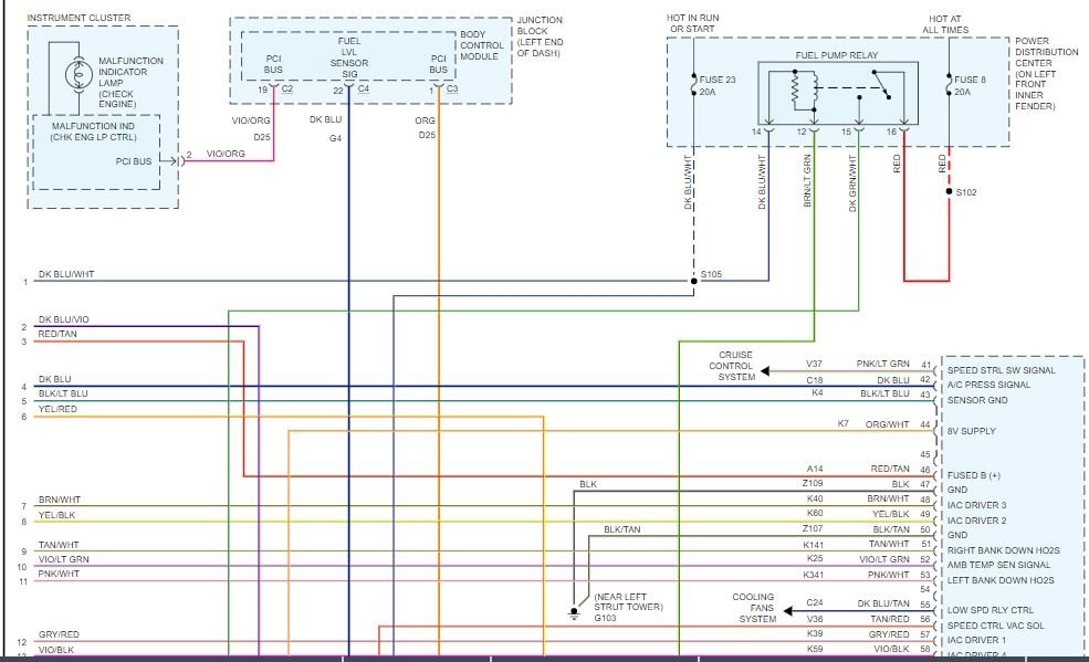

injector coil fuse blows with key in start position.
Feb 6, 2020 at 2:09 AM
Good morning,

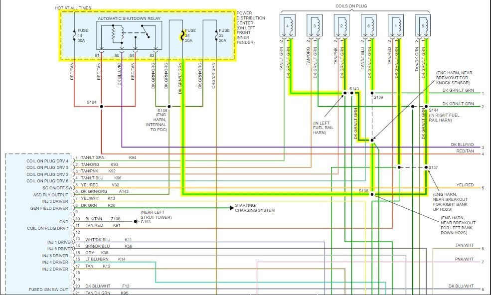

In the on position, do you have power to the injectors and the coil?
Do you have any codes set?

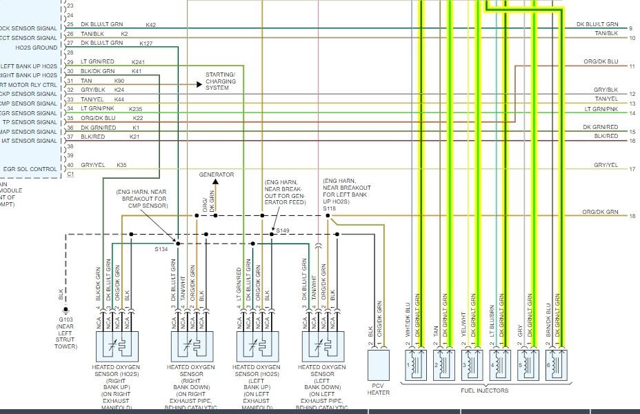

I attached a wiring diagram for you to view. You could have a shorted coil or a shorted injector. You will need to disconnect the coils and injectors to see if the fuse still fails. The dark green wire is the feed to both.
