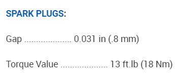

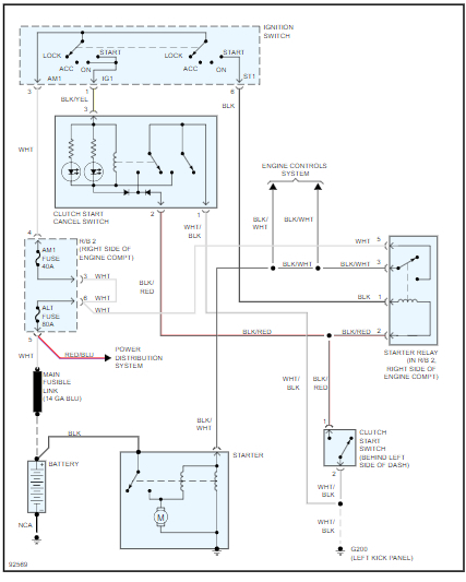

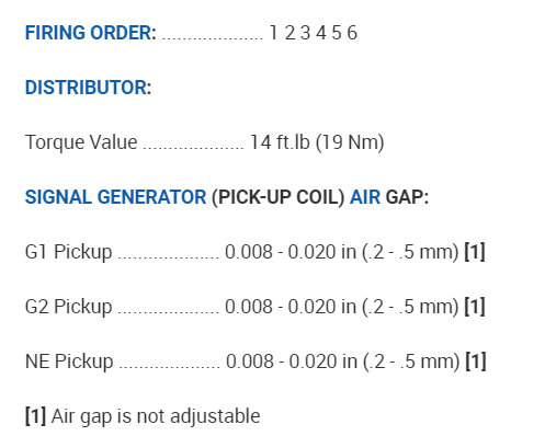

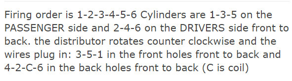

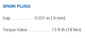

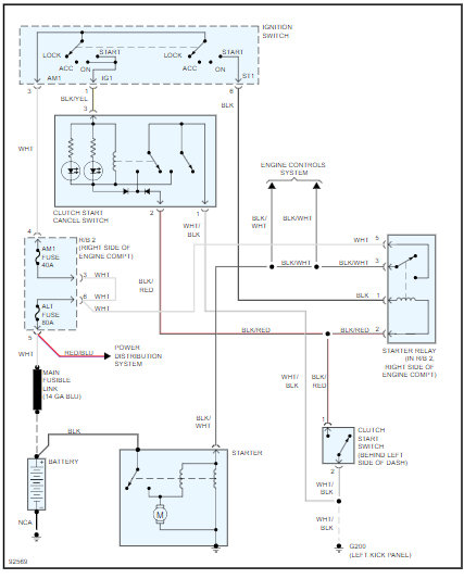

Yes Sir, if you could kindly sent me the ignition system wiring diagram, spark plug wires and firing order. Thank you
Jul 22, 2020 at 7:42 AM
DANNY L
  • 5,648 POSTS
Hello again.
Here again is the information you requested for diagrams. I've attached pictures below.Hope this helps and thanks again for using 2CarPros.
