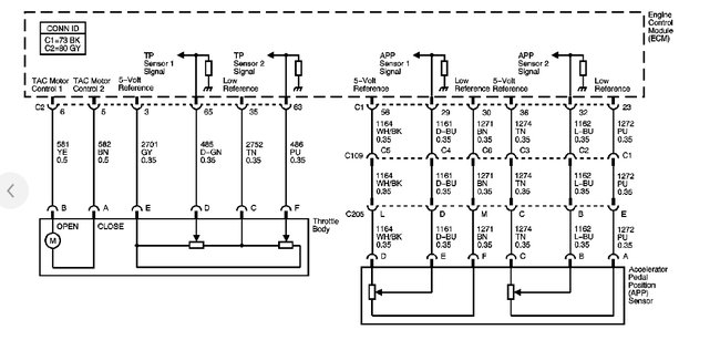

I am rebuilding after it had a fire in the engine compartment. I have got everything done except for I do not have the throttle positioning sensor wire as of yet. Does that have to be wired for the car to start?
Jul 14, 2018 at 1:11 AM
Good afternoon.
Yes it does. All the wiring needs to be in place for it to go.
Did you replace the harness?
Jul 14, 2018 at 7:17 AM
PSOUTH
No I did not, but I replaces most of the connectors. I have a scan tool and it seams to be communicating. So I believe the PCM is okay. I am waiting for the TPS connector to come in mail. It is the last one to replace I am just not 100%s ure how to wire it. Got any insight? I spliced a lot of wires one at a time.
Jul 14, 2018 at 3:44 PM
Here is a diagram for you to follow.
