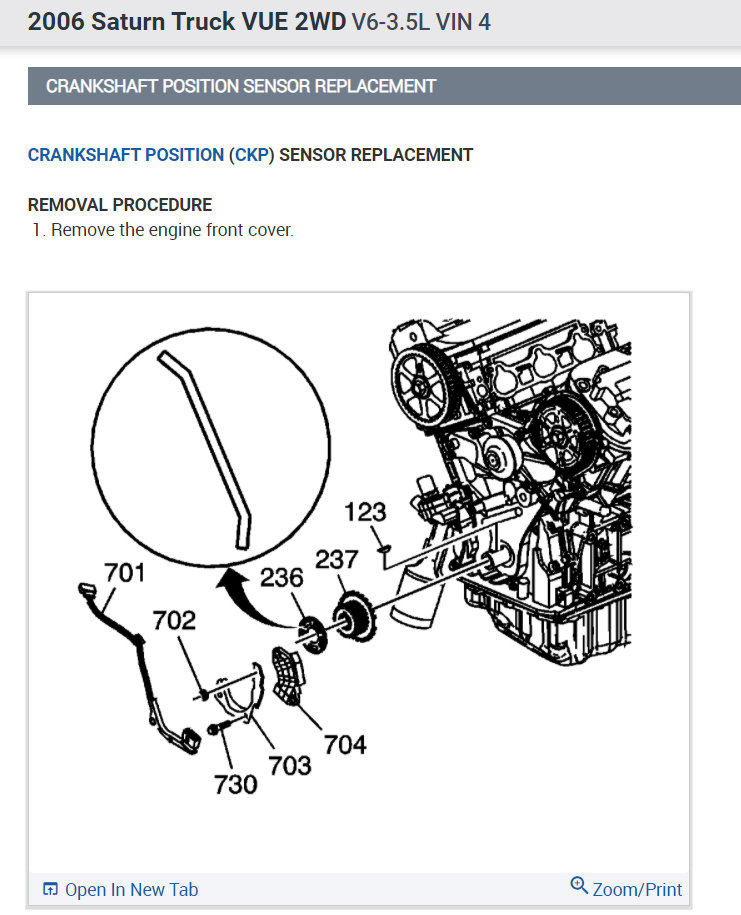

I changed the timing belt all marks are on point. I also I changed the camshaft position sensor, harmonic balancer and the serpentine belt. motor cranks but there is no spark.

it is common for the crankshaft angle sensor to go out or still be disconnected from the repairs. this guide can help with diagrams below to show you the crankshaft sensor location:
