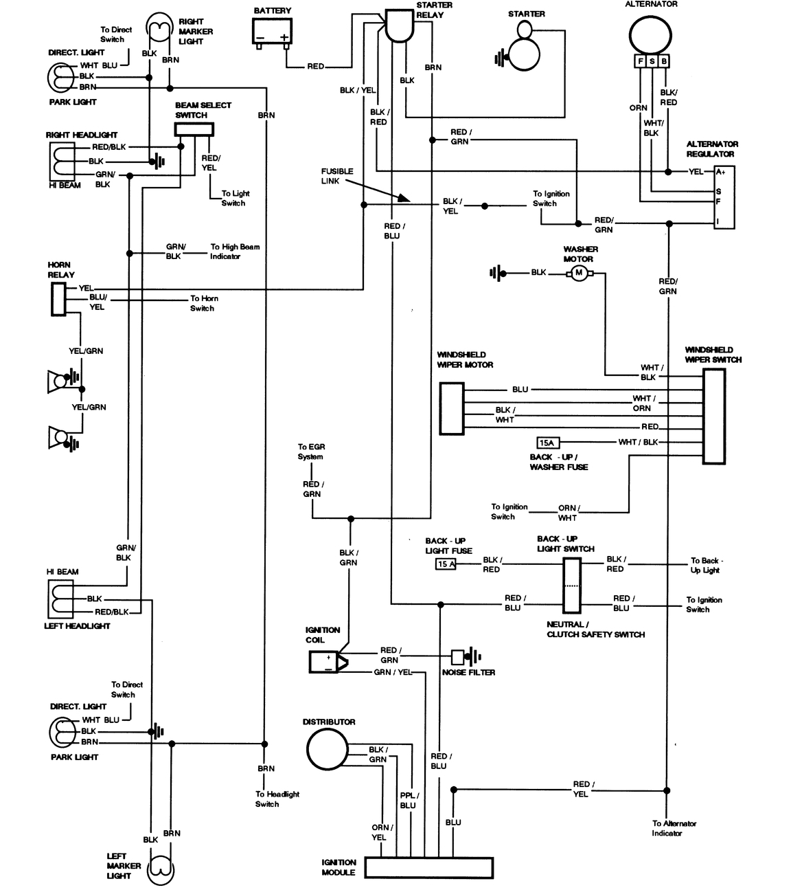

I have replaced ignition coil and, control module pick up coil.

There is no 0.7l engine. What engine is this and also check that you do have voltage available to the ignition coil when the key is on both run and start.

This should be the wiring diagram and the wire color to the ignition coil positive side is black/green and comes from the starter relay.
