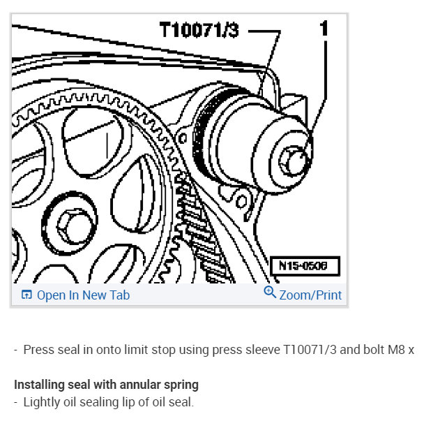

No spark at the plugs, camshaft sensor replacement instructions needed
2002 VOLKSWAGEN POLO
200,000 MILES • 1.6L • 4 CYL • 2WD • MANUAL
M.MOKARA

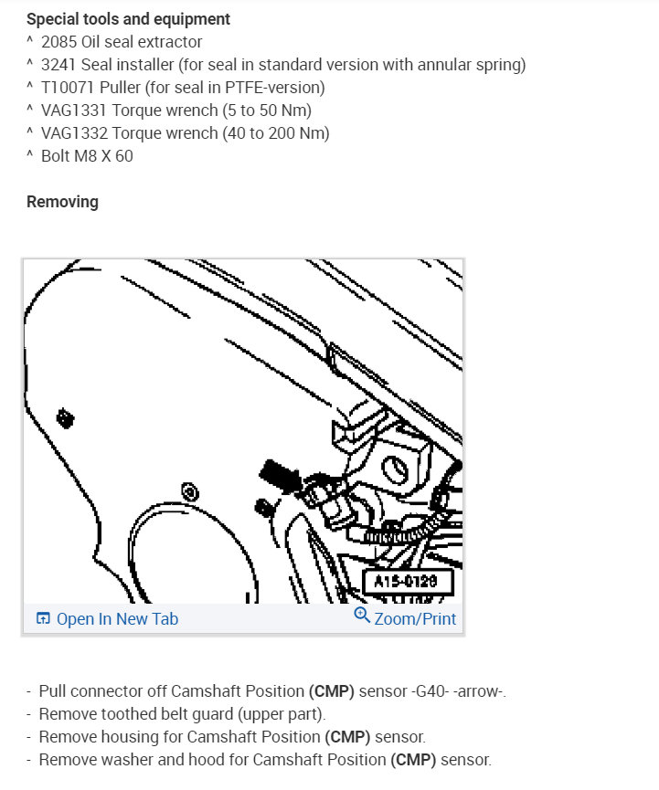

The car just cranks,it does not start at all.petrol is coming okay,we realized there is no spark at the plugs.so we wanted to change camshaft sensor.now we don't know where it's located.please help

Hey M.MOKARA@YAHOO.COM,
Have you done any tests to confirm a cam shaft sensor fault?
I would advise starting by checking for the engine management fault codes?

The car doesn't have engine light and spark.

Where is the crankshaft position sensor located in a Polo Playa 1.6 2002 model?

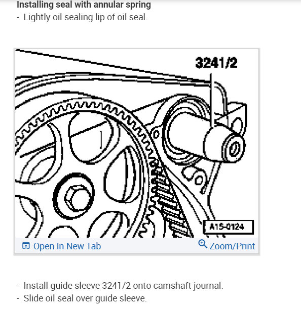

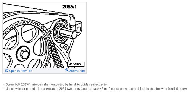

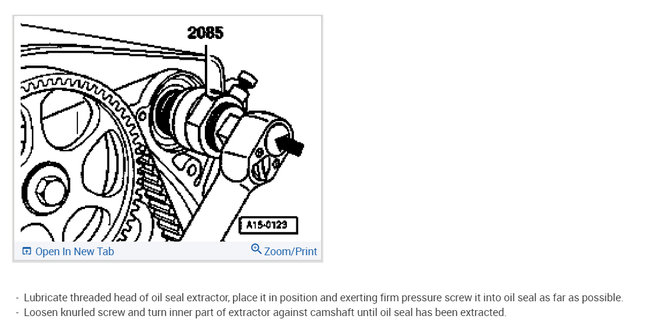

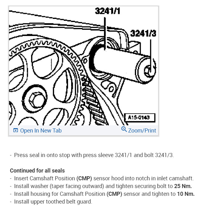

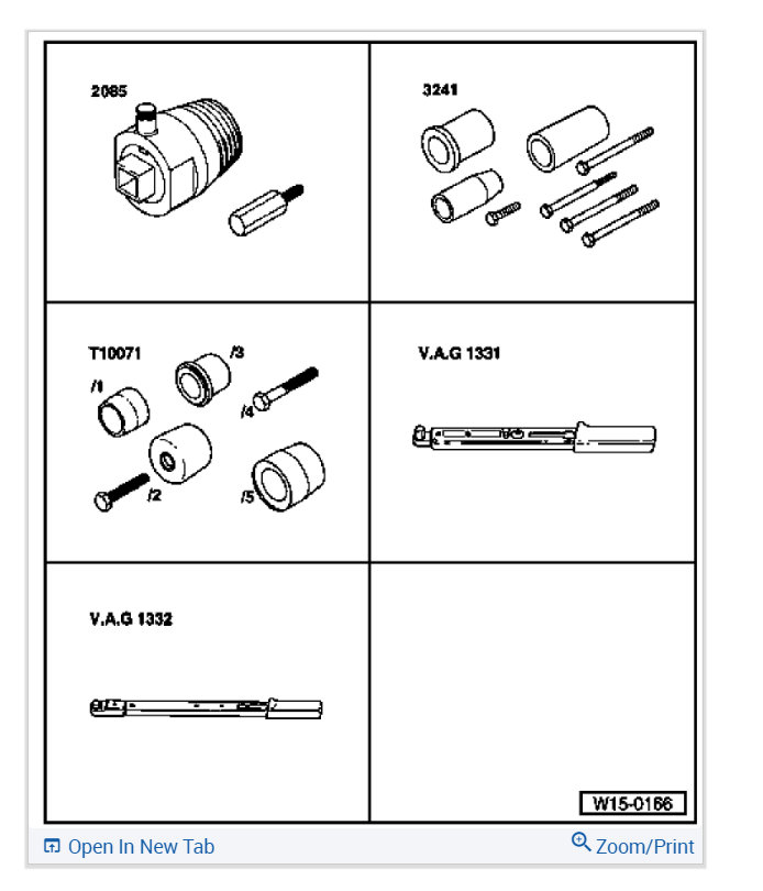

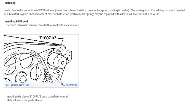

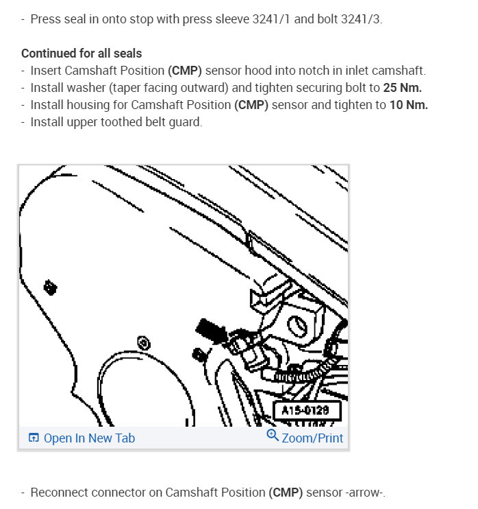

Can I ask if the engine sounds normal when cranking over? Can you please shoot a quick video with your phone so we can hear the noise? that would be great. You can upload it here with your response. Here are the camshaft sensor replacement instructions in the diagrams below.
