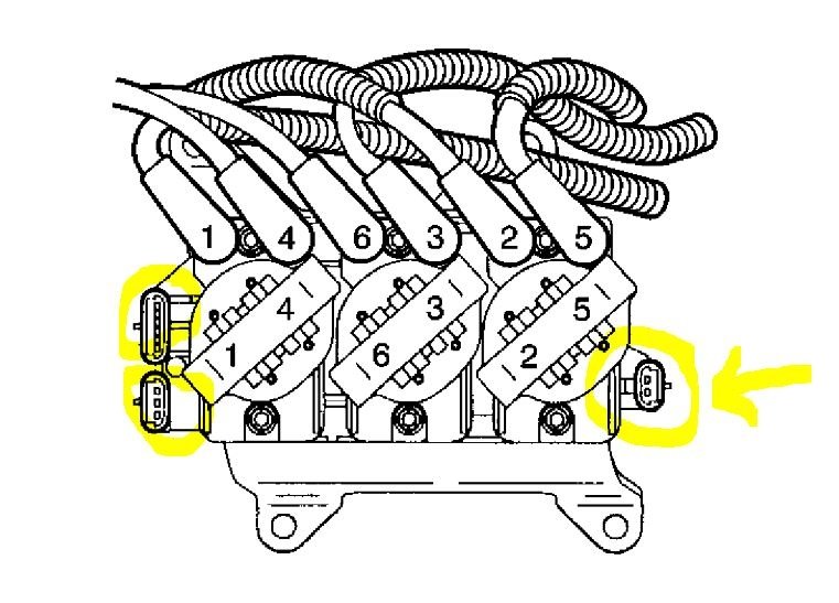

I changed head gaskets on my car now I have no spark and I think I'm missing a wire to the control module, but can't figure out what wire if any is missing.

Good evening,
There are three connectors to the ignition module.
Double check the connections. One is from the engine harness and is tough to find.
The one with the arrow in the picture is the common one to forget.
