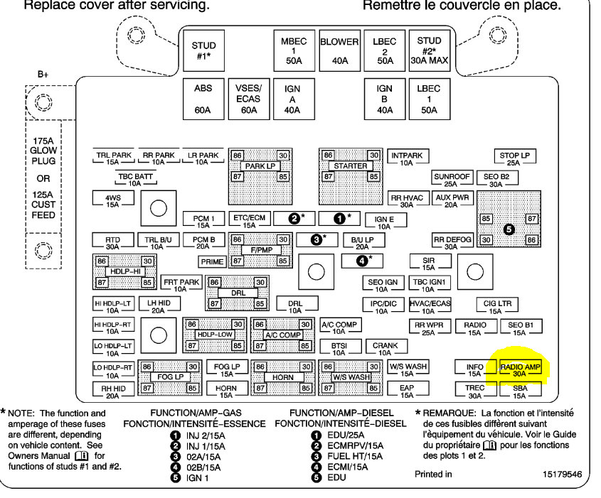

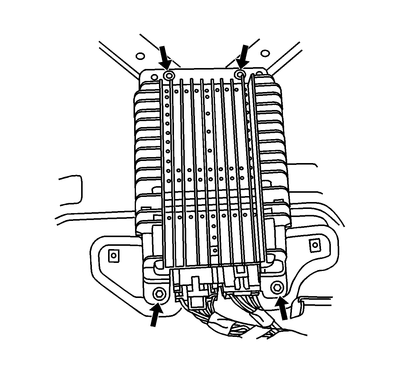

My SUV has the Bose sound system. The radio works. But no sound comes out. The speakers work because i took them off and put them on anther truck to check if they were good. I thought might be the radio but i bought one and it still did the same thing. The fuses are good so anyone got any ideas?
Dec 10, 2019 at 4:42 AM
  • 110,244 POSTS
If the radio is on, then my first suspect is either a fuse to the amp or the amp has failed. Take a look through these directions for replacing the amp. Locate it in your vehicle and confirm nothing is disconnected or damaged. Also, make sure there is power to it.
If you look at the last pic below, it shows the fuse box under the hood. I highlighted the amp fuse. It is a 30 amp fuse.

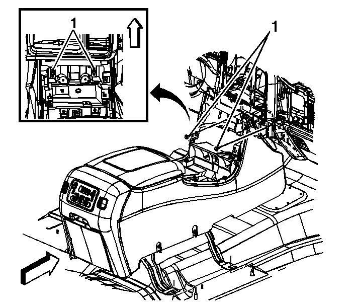

2. Remove the floor console bezel.
3. Remove the cupholder.
4. Remove the bolts (1) retaining the console to the instrument panel (I/P).
5. Remove the console storage bin.
6. Remove the center console end panel.

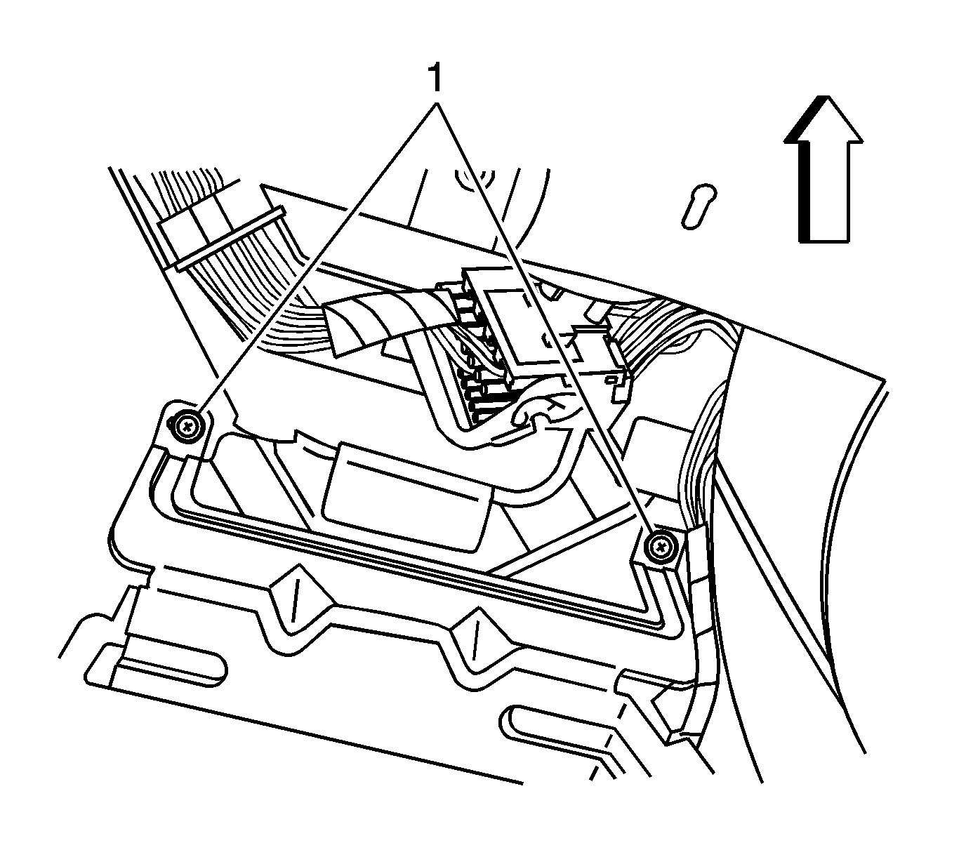

7. Disconnect the audio amplifier electrical connectors.
pic 2
8. Remove the 4 screws retaining the upper console bracket to the lower console bracket. The front 2 screws (1) are shown in the graphic.

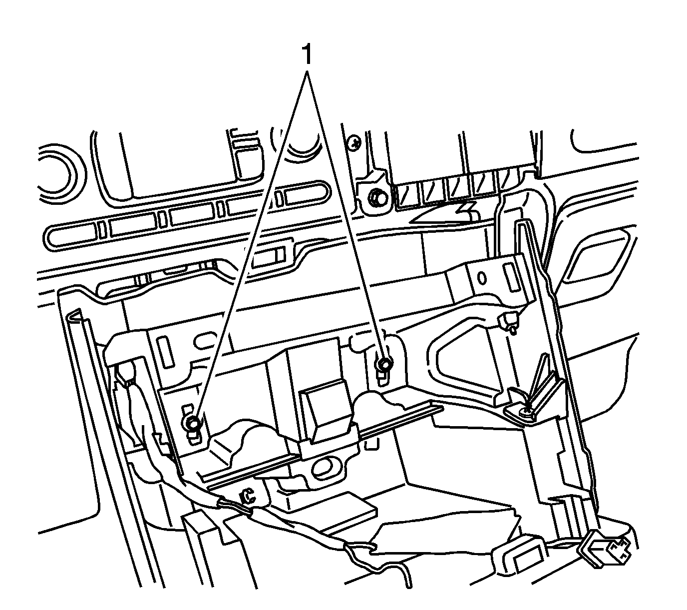

pic 3

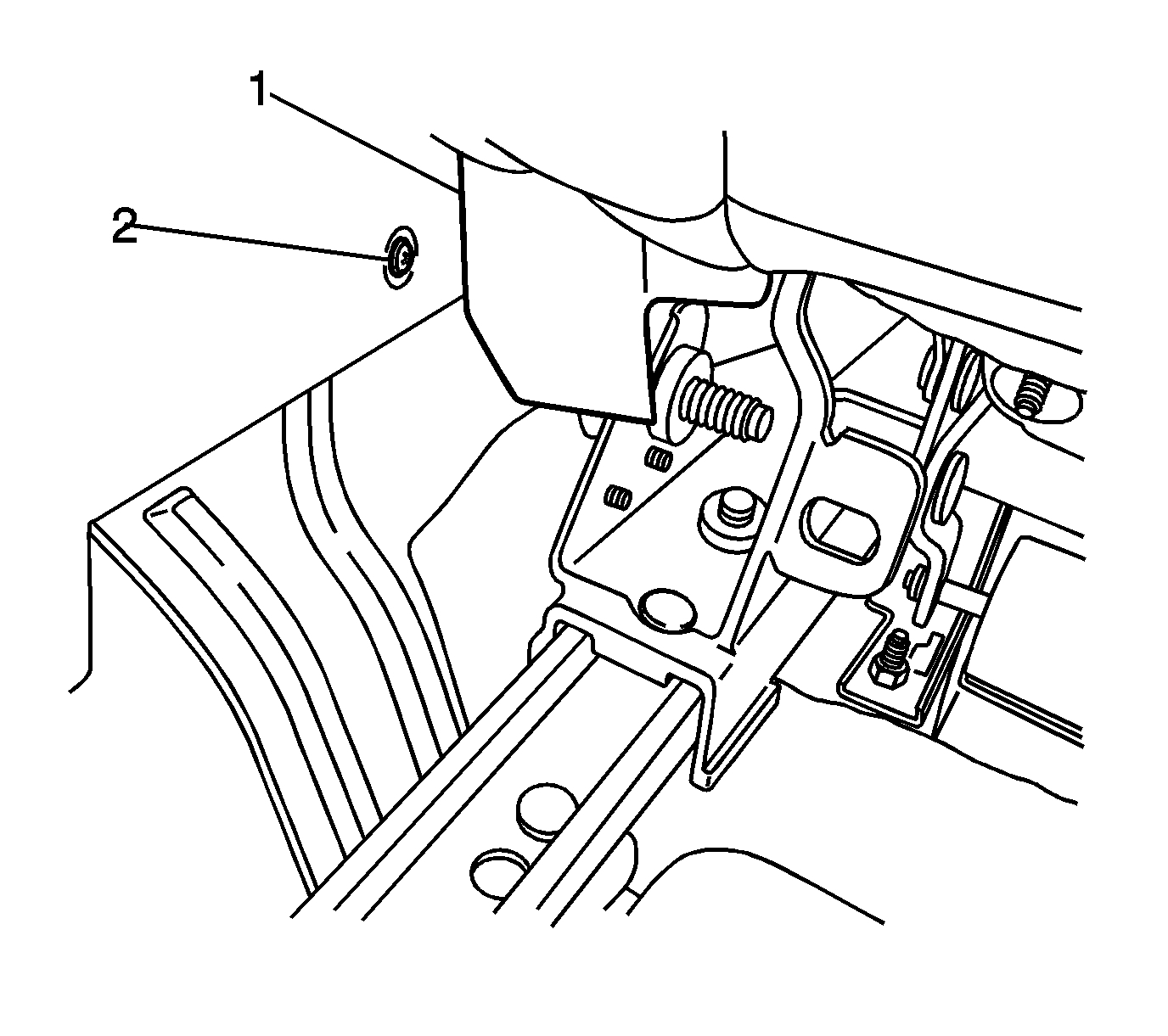

9. Move both front seats to the fully forward.
10. Reposition the inboard seat track trim (1) in order to gain access to the rear console side panel screw (2).
11. Remove both rear console side panel screws.

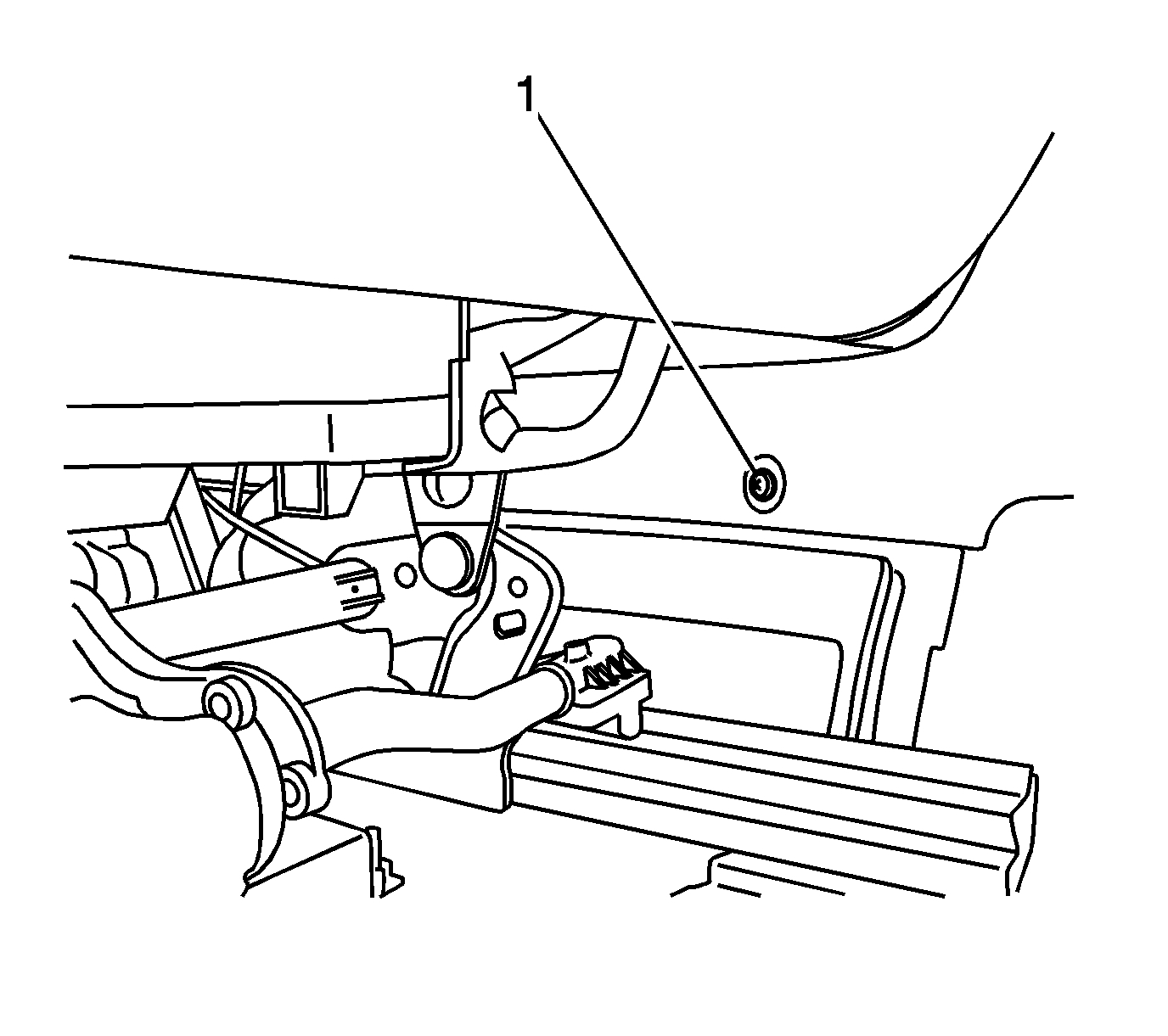

pic 4
12. Move both front seats to the fully rearward.
13. Remove both front console side panel screws (1).

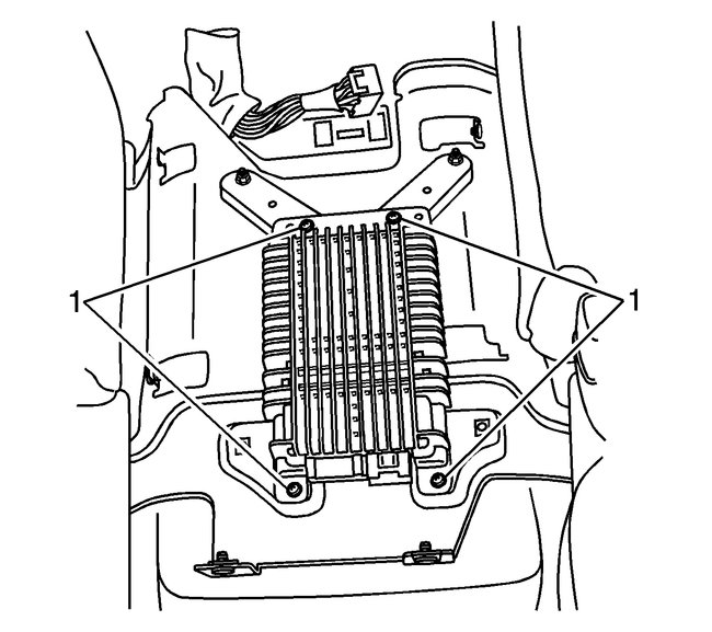

14. Disconnect the floor console electrical connector.
15. Remove the console assembly from the vehicle.
16. Remove the audio amplifier screws (1).
17. Remove the audio amplifier from the vehicle.
