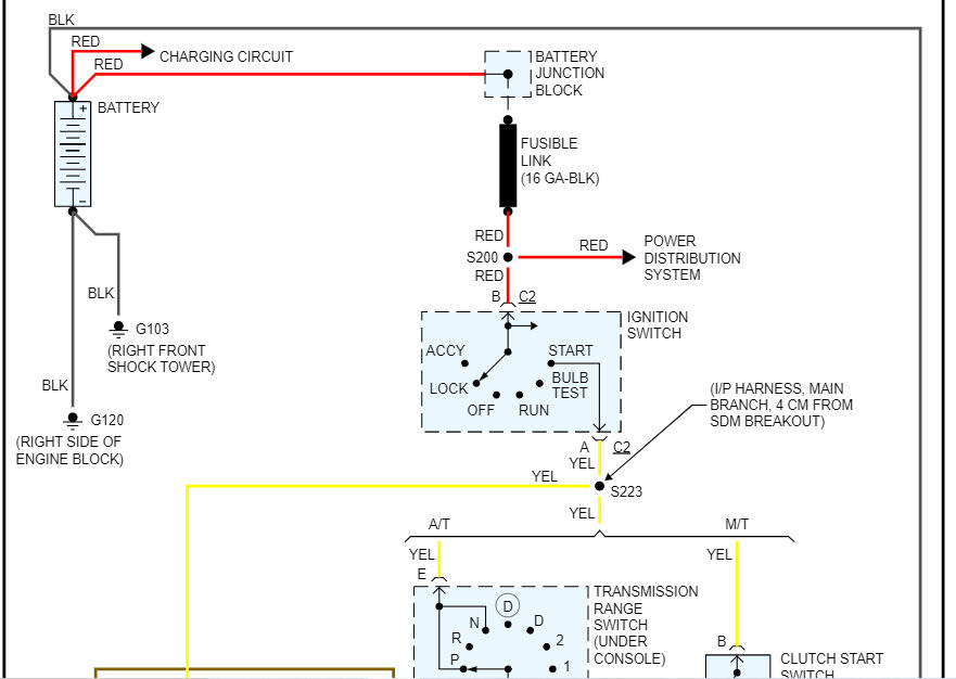

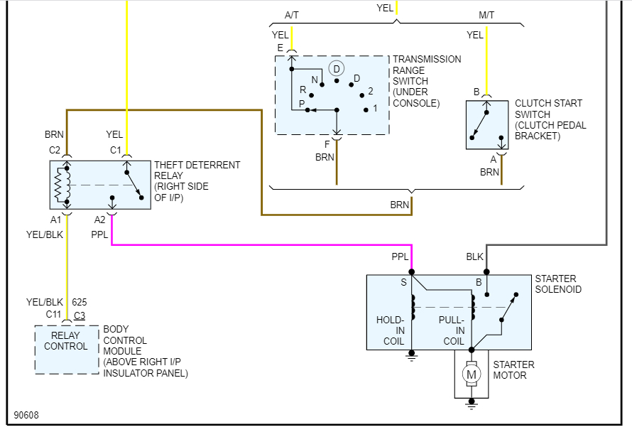

Okay, so, when i turn the key all the lights come on and everything, but there is no sound at all and it's like there is no power going to the starter at all.
Mar 30, 2023 at 12:22 PM
  • 110,240 POSTS
First, check to see if it starts in neutral rather than park. If there is no change, I need you to check if power is getting to the starter motor.
On the starter itself, there will be a heavy gauge black wire. That is direct from the battery and has 12v at all times.
There is also a smaller gauge purple wire that has no power to it until the key is in the start position. So, have a helper turn the key to the start position while you check for power to the purple wire.
I attached the starter circuit wiring schematic below so that you have a reference.
If there is power, the starter is bad. If there is no power, let me know, and we will need to work backward to see where power is lost.
As always, make sure the battery terminals are clean and tight and the battery is fully charged.
Let me know what you find.
