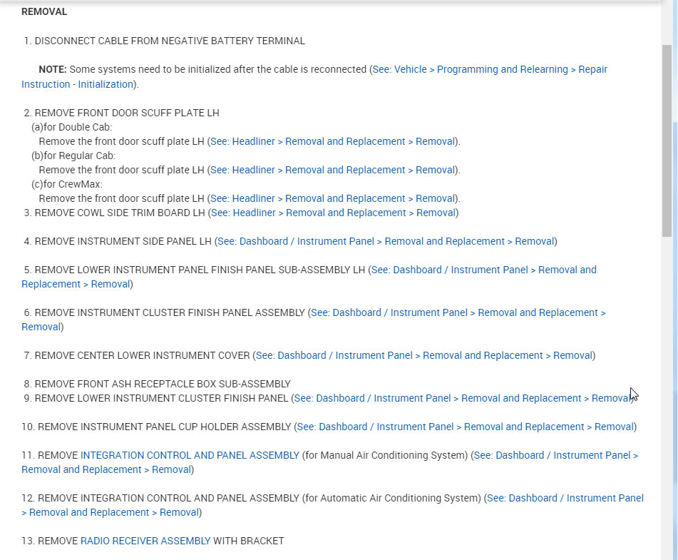

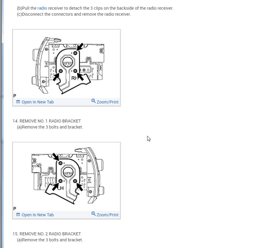

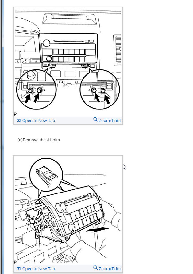

4.7l. no sound from radio unit, checked fuses they okay, removed radio unit, unplugged and plugged it back still nothing, but noticed that there is sound only if CD is chosen, weird, never seen such an issue.
