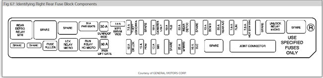

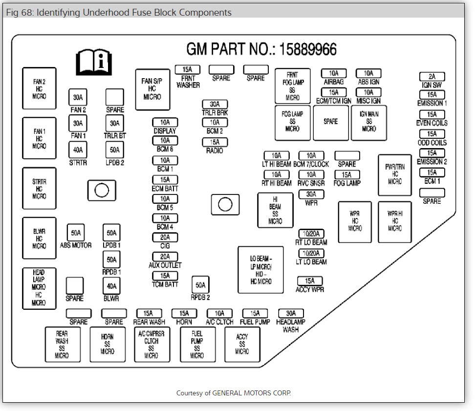

The radio turns on but no sound on speakers even if i start ignition. i had a disturbing sound on the speaker of the desk like blowing noise tototototo.
Jul 8, 2022 at 10:27 PM
  • 55,399 POSTS

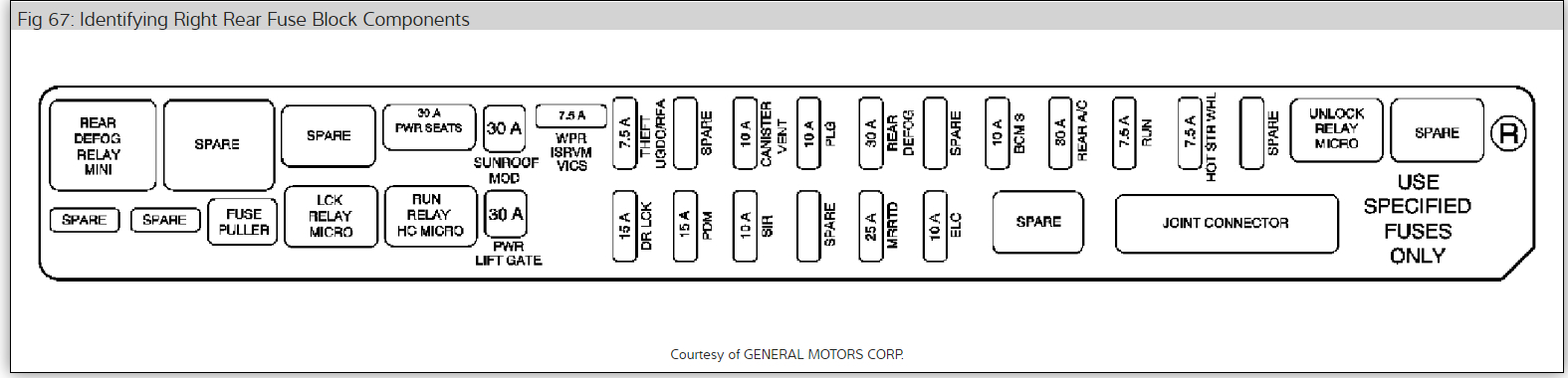

It sounds like the amplifier has gone out, but to be sure let's start by checking the fuses (radio fuse 15 amp - under-hood, RSA/RSE and AMP - under the carpet on rear seat left side.) that run the system. Here is a guide to help and the fuse locations:
