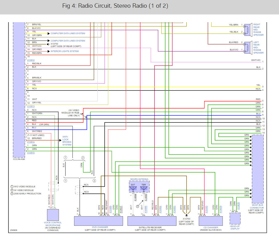

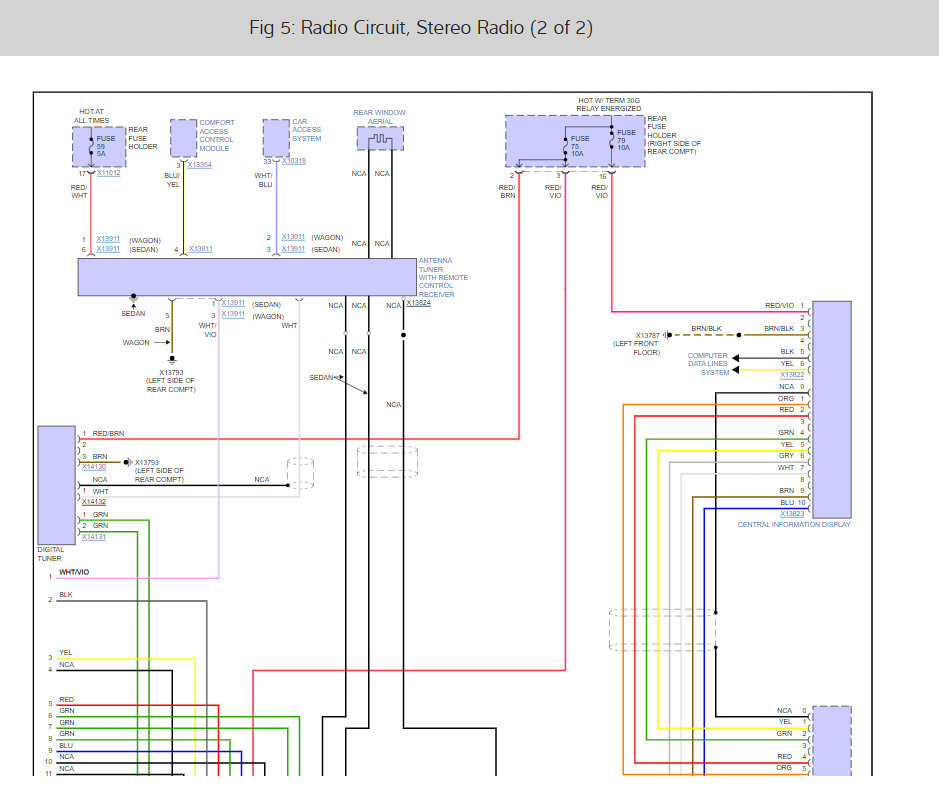

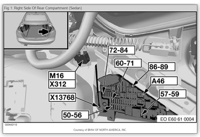

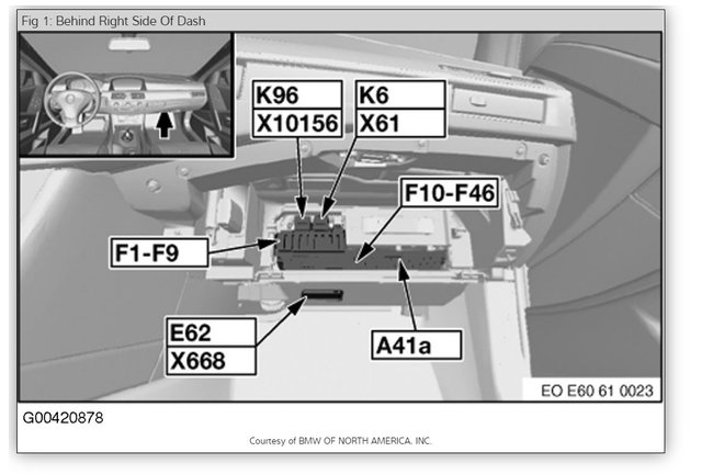

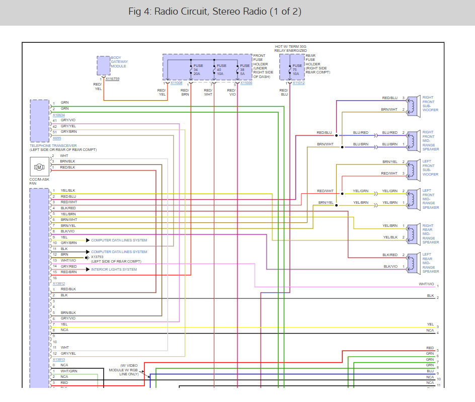

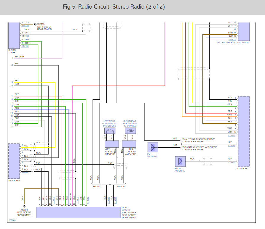

There are five fuses that run the system, #75 and #79 in the rear compartment (right side) and # 34, #40 and # 38 in the interior fuse panel under the right side of the dash. Here is a guide to help you check the fuses with the fuse locations in the diagrams below. I have also included the radio wiring diagrams so you can see how the system works.
