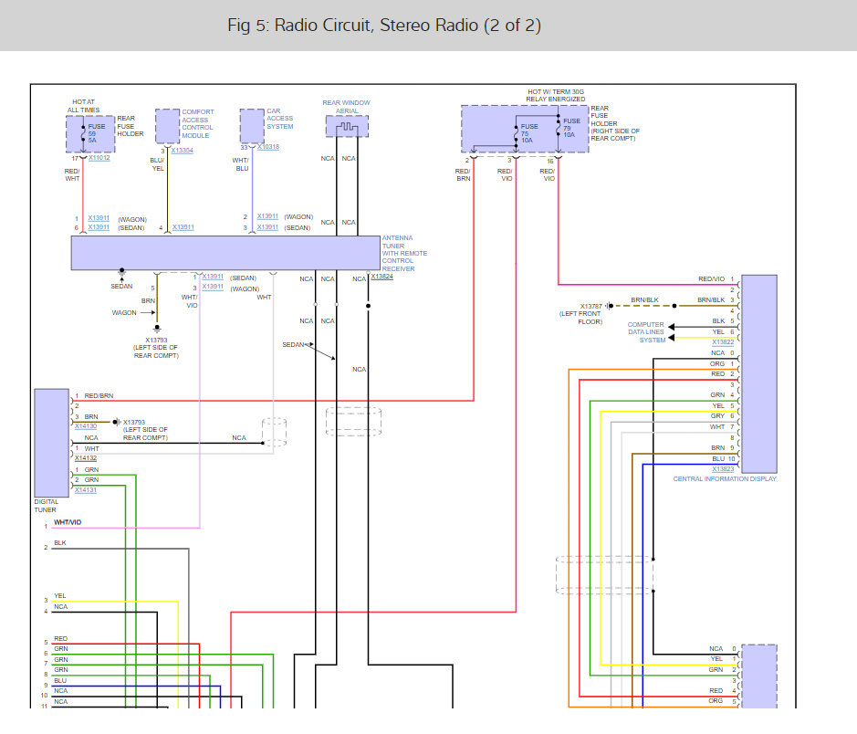

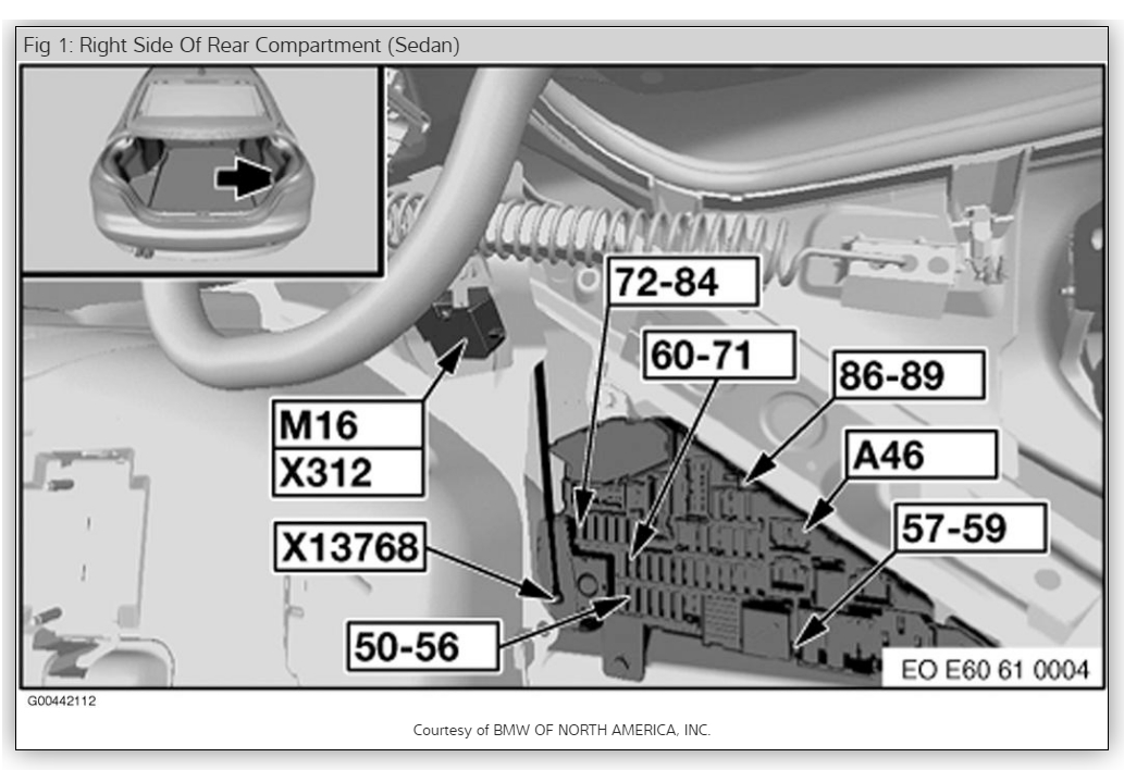

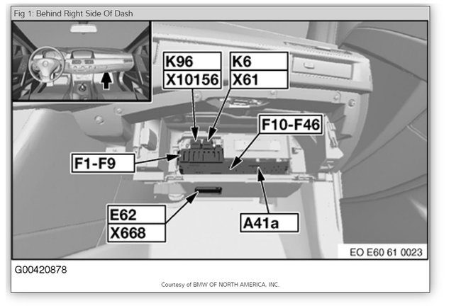

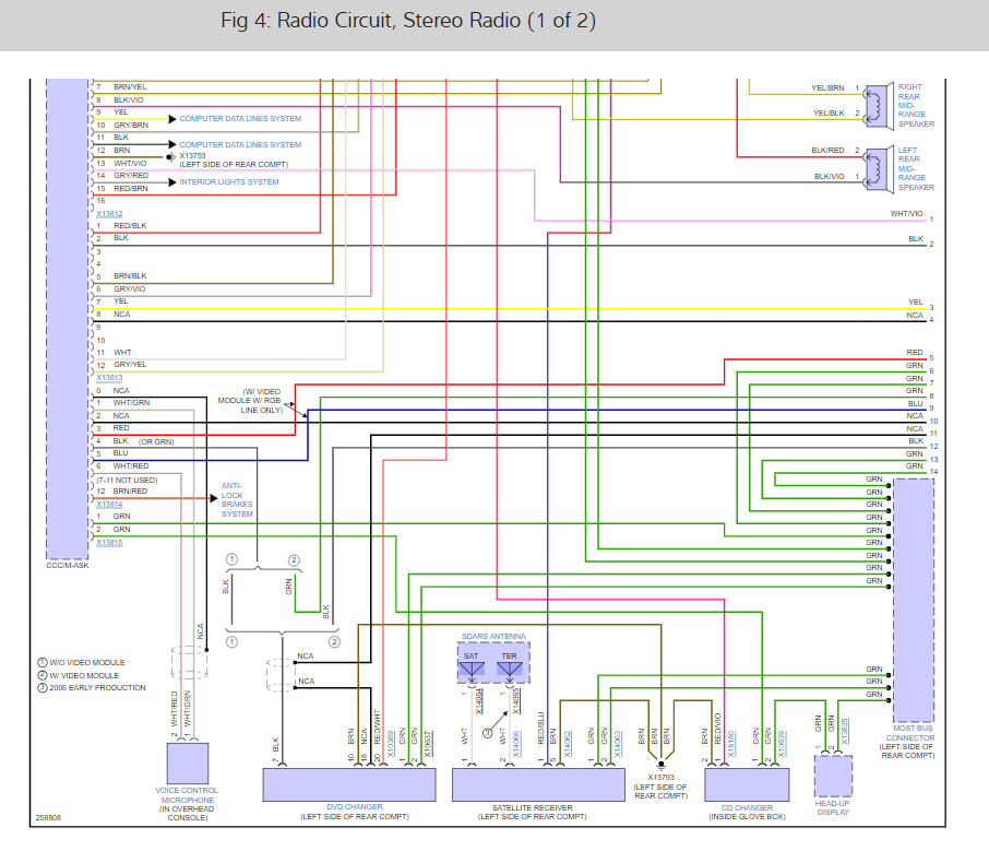

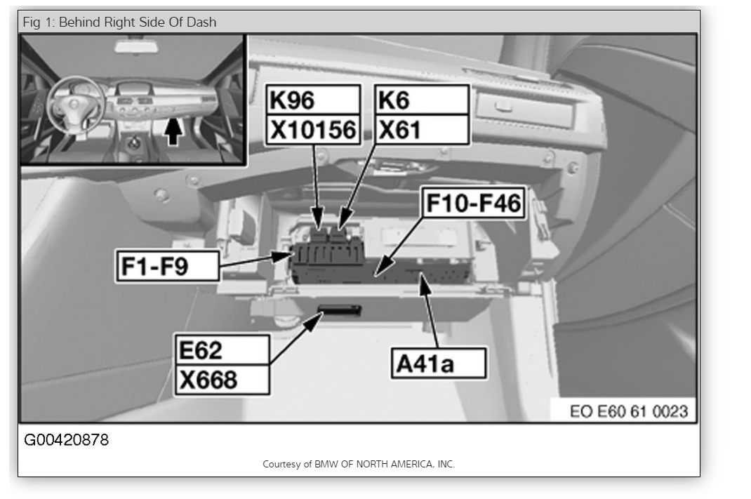

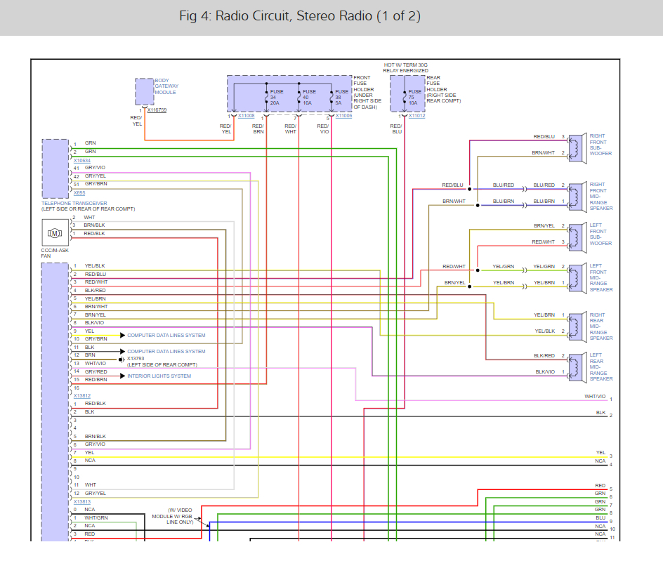

I can pair the blue tooth with my phone, but music only comes out my phone not the car and I don't get any sound when you open door with key in ignition. The car listed above is a 530xi.
Jun 2, 2022 at 4:36 AM
  • 55,817 POSTS

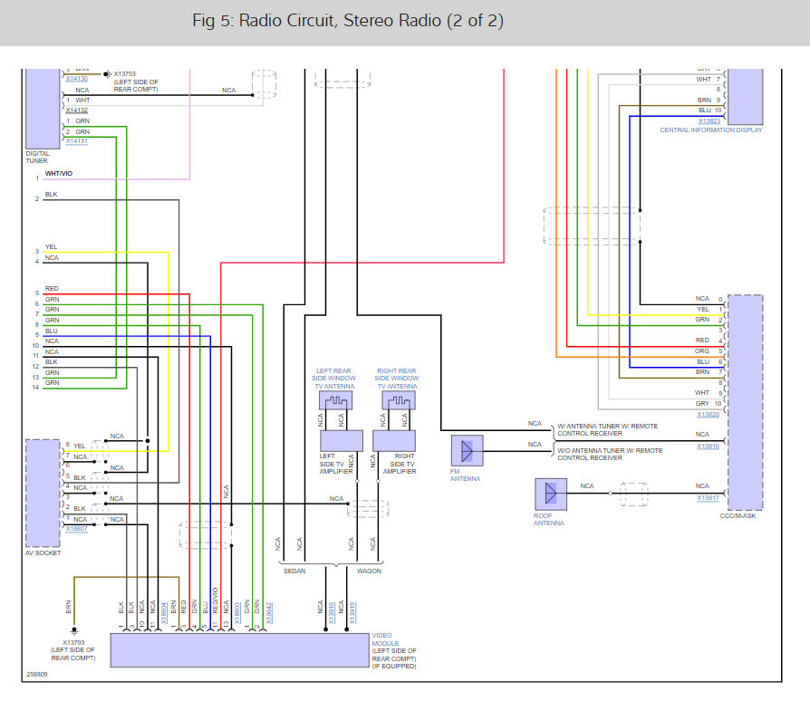

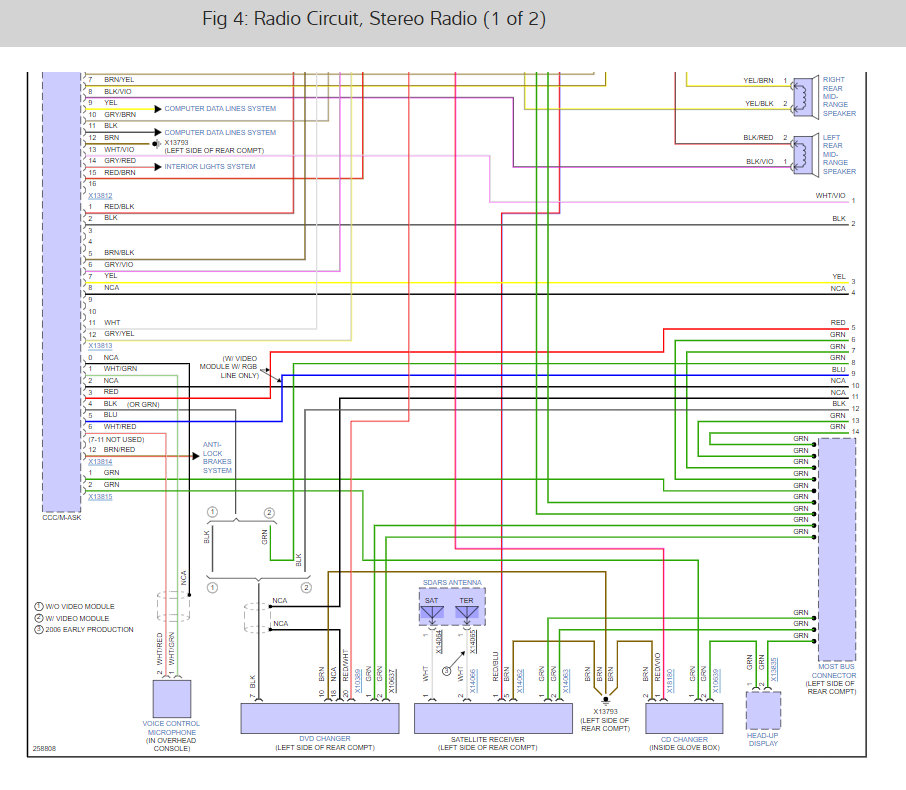

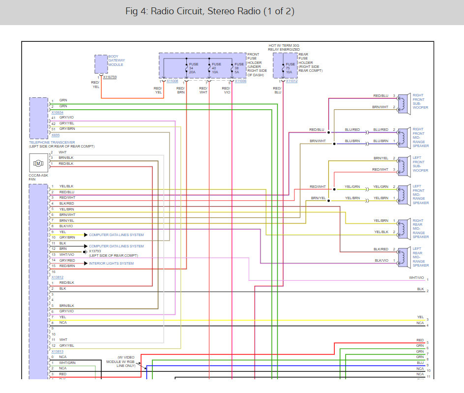

There are five fuses that run the system, #75 and #79 in the rear compartment (right side) and # 34, #40 and # 38 in the interior fuse panel under the right side of the dash. Here is a guide to help you check the fuses with the fuse locations in the diagrams below. I have also included the radio wiring diagrams so you can see how the system works.
