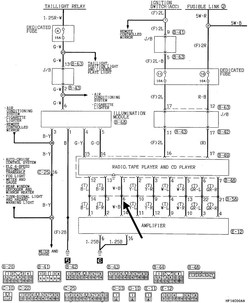

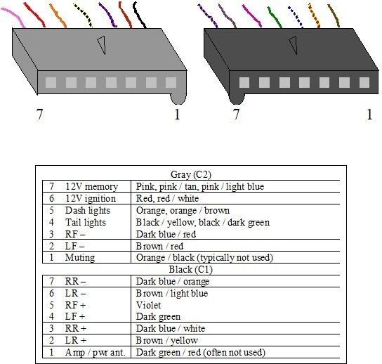

You're in luck that I'm in the middle of building a new radio workbench, and it's going to include an amplifier from a '97 Sebring. Here's the pinout diagrams. This first drawing shows the original radio plugs. The wire you're asking about is in the black connector, terminal # 1. Don't pay attention to the wire colors I listed, just their locations.

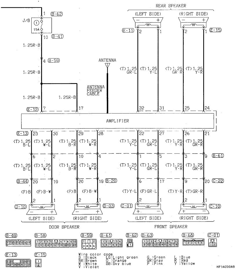

The next two are the diagram for the '97 model. It's the same for '98.

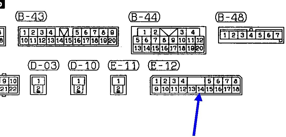

The last one is just an expanded view of the larger amplifier plug. Pin # 14 is the turn-on line coming from the radio. You don't need to even look at the amp if you're keeping it. Just use the wire in the original radio's black plug and connect that to the "Power antenna" wire on the new radio. That's commonly a blue or a yellow wire.
