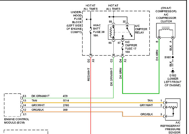

The bottom line is the compressor its not coming on but if I jump 30, 87 compressor comes right on with no problem. Looking at the electrical diagram the wire 63
dark green/white is the signal wire that supposed to command the relay to turn on and off?

Good afternoon,
Let us back up.
As for the relay, with the key on, do you have power at pin 30 and pin 85?
If you do, then the green/white is a ground for the control side. The PCM grounds the relay based on the input from the pressure sensor.

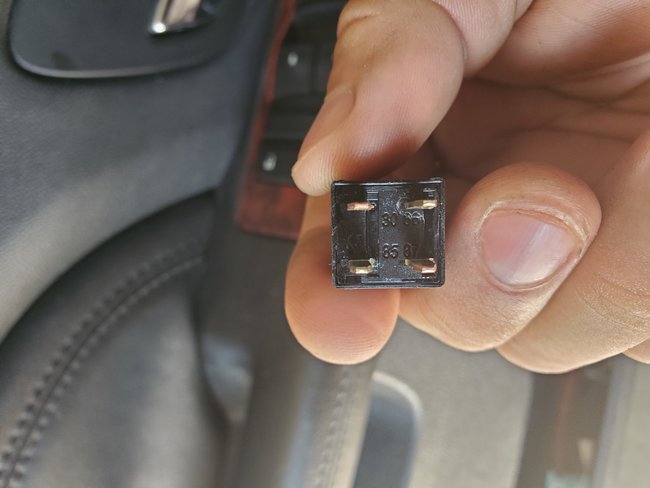

Okay, something is wrong with power off keys out relay clicks and compressor engages, but when I turn the key on relay loses power and compressor disengages. Is there a chance I'm doing the wrong pins on the relay? If I hold is this direction pins 30 and 85 are at the bottom but if I hold the opposite way they are on top?
Sep 2, 2019 at 7:30 AM
You will need an ohmmeter to check for the pin. One end at the compressor and one at the relay. Look for 0.00 ohms.

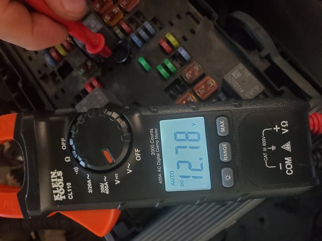

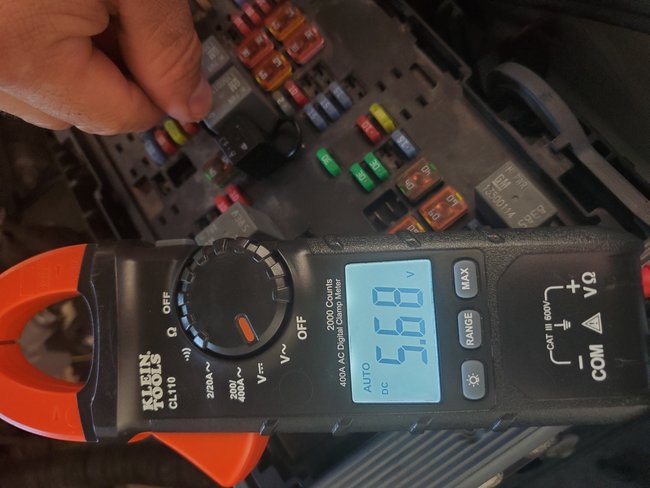

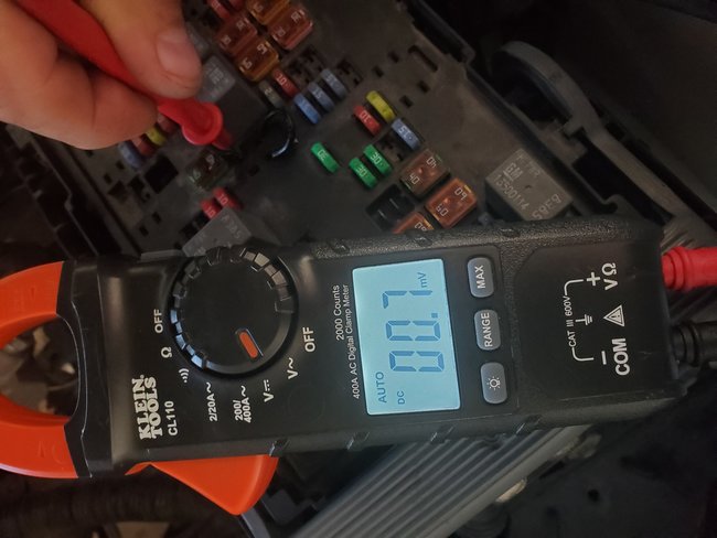

DARKFREELIFE
  • 36 POSTS
Okay, let me explain my self more clearly I took some pictures. This is with the car off.
When relay is out on lin 86 dos not get any voltage. But as soon as I put the relay then it click and pin 86 get a feedback voltage of 5 volts. First picture is pin 30 and 85 I get 12 volts. I do have a spare ECM switch I just bought.

Sep 2, 2019 at 9:15 AM
My last answer did not post.
The 5 volts you see is not a feedback, it is a voltage drop between the relay and the PCM.
This sounds like a wiring problem between the relay and the PCM.
Sep 2, 2019 at 9:22 AM
