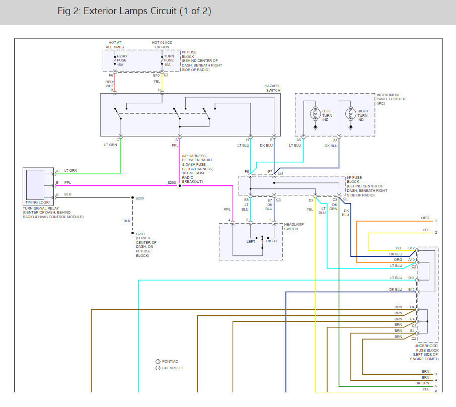

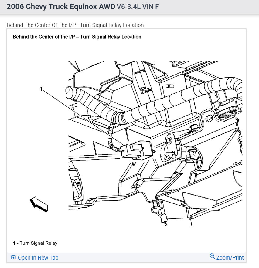

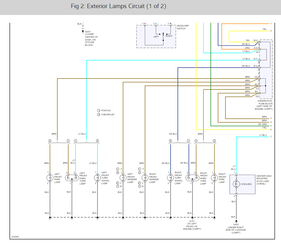

So I had to replace my heater core. Which required me to remove the entire dash everything else is working just fine but my signal lights and hazard lights. I'm just trying to figure out what I I need to do to get them working again. Thanks in advance for any information you can provide. Also it's not showing on the dash panel at all if that helps any in narrowing it down.

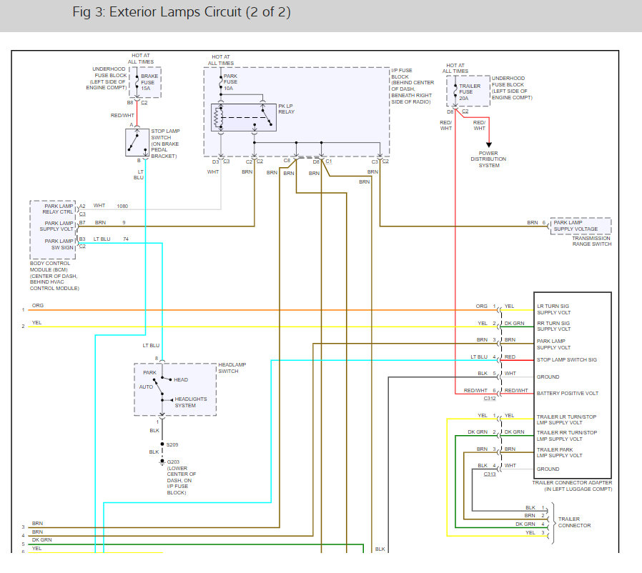

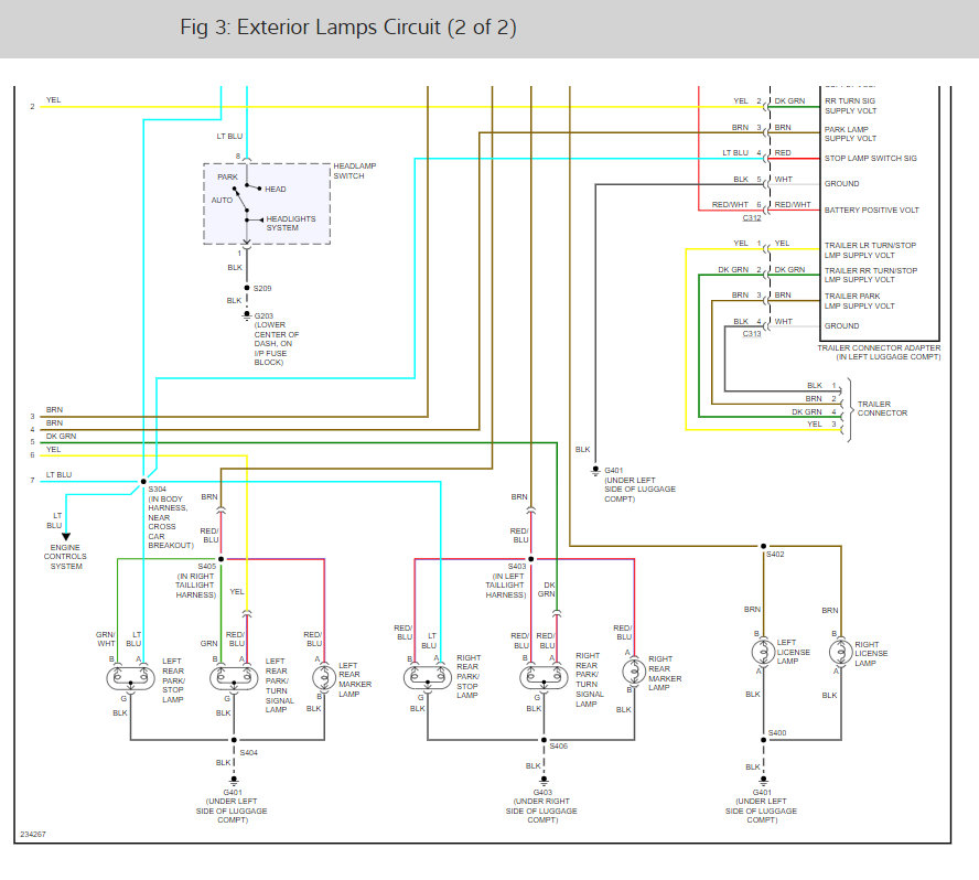

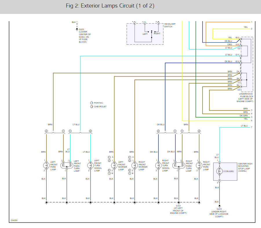

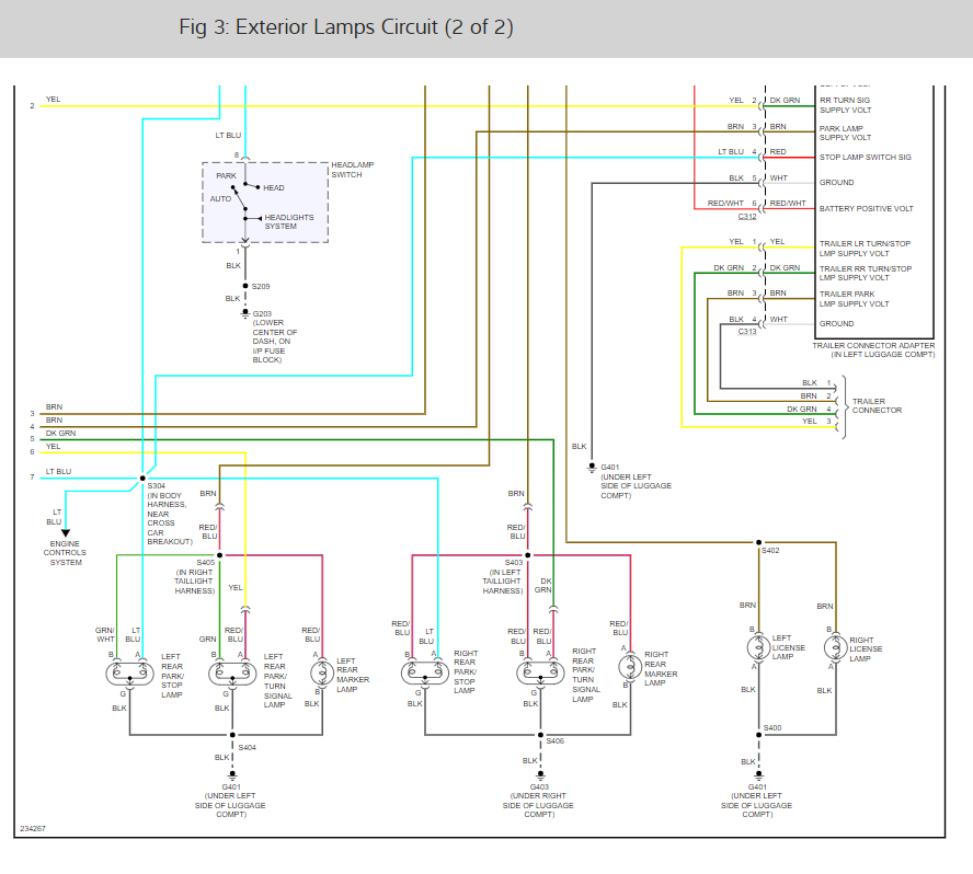

There is a turn signal relay which sounds like it is unplugged there is a wiring diagrams of the blinker and hazard light so you can see how the system works and the relay location so you can check it out. Check out the diagrams (below). Please let us know what you find. We are interested to see what it is.
