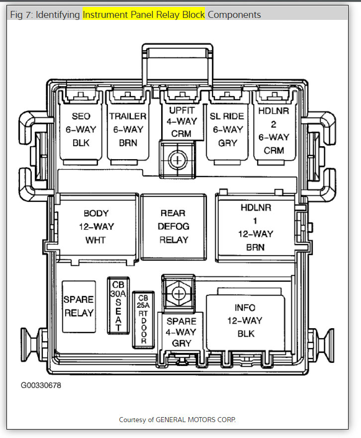

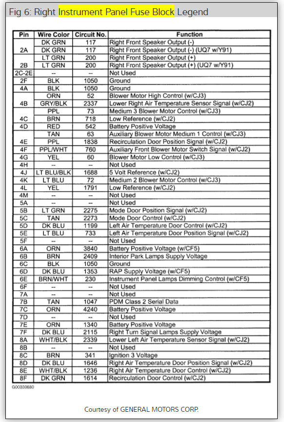

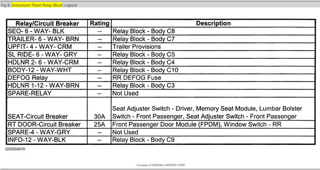

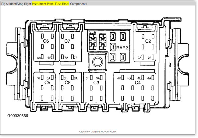

Well suddenly my blinkers and my speedometer do not work. I changed the ignition one relay and the ignition one fuse but nothing happened. What should i do now?
Jan 13, 2018 at 7:41 AM
  • 55,746 POSTS

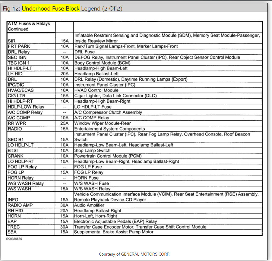

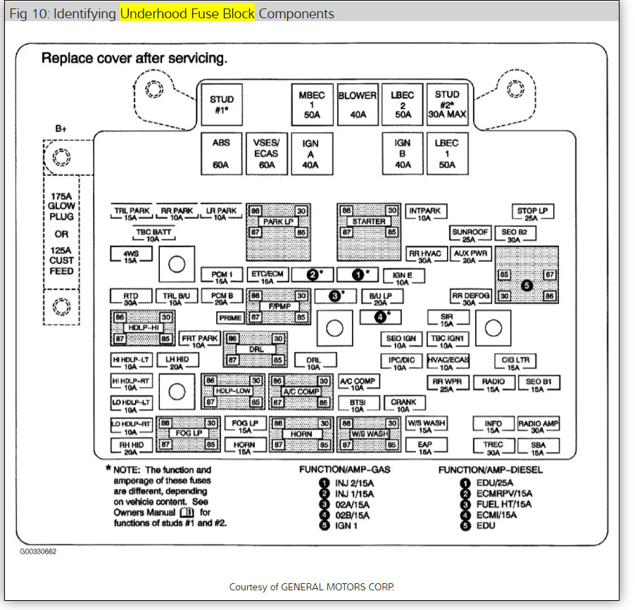

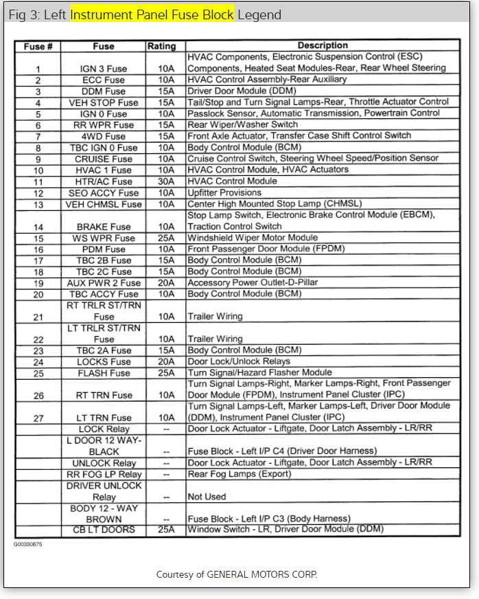

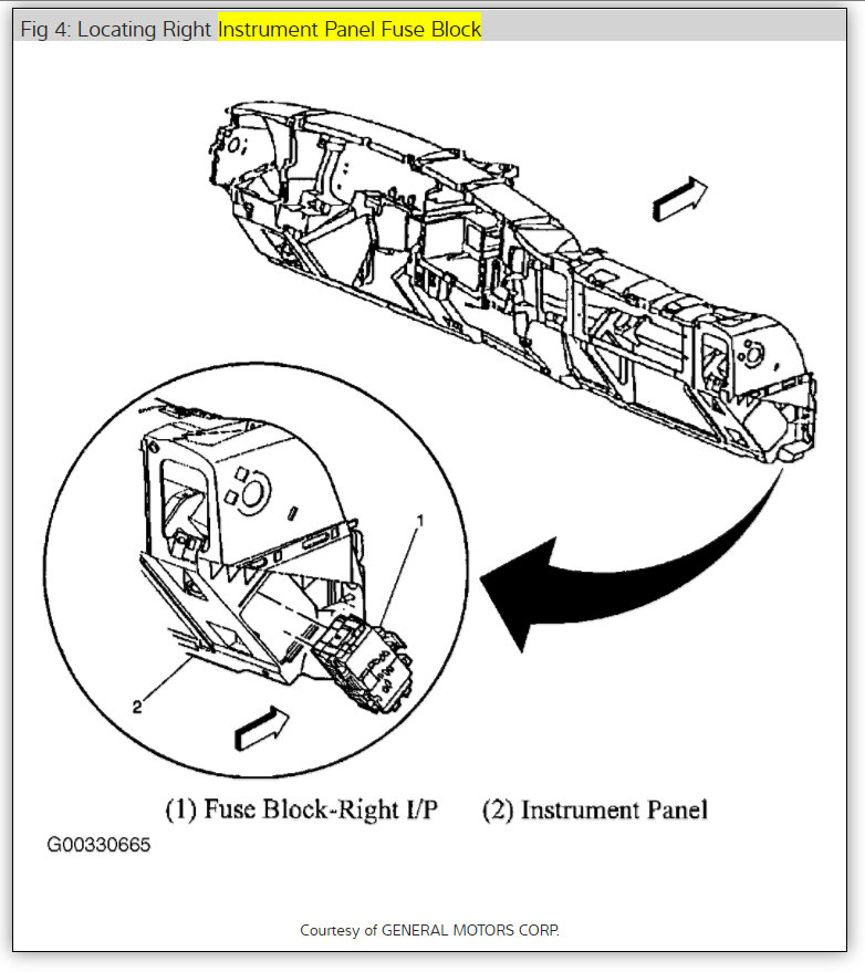

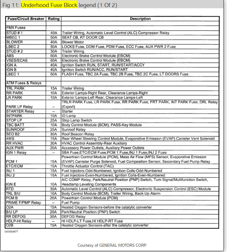

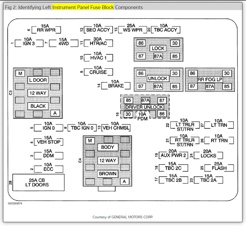

It sounds like you have a BCM fuse that is out. Here is a guide to help you check the fuses:
Below are the fuse panel locations.
Please run down these guides and diagrams and report back
