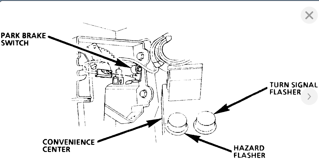

Hello, signals worked, and understanding sound there is none. When the key is in the ignition, the beep is there. Help
Nov 17, 2019 at 8:24 AM
DANNY L
  • 5,648 POSTS
Hello, I'm Danny.
It sounds like you might be having a problem with the turn signal flasher.It's located in the left hand kick panel. I've attached a picture below with its description and location.Hope this helps and thanks for using 2CarPros.

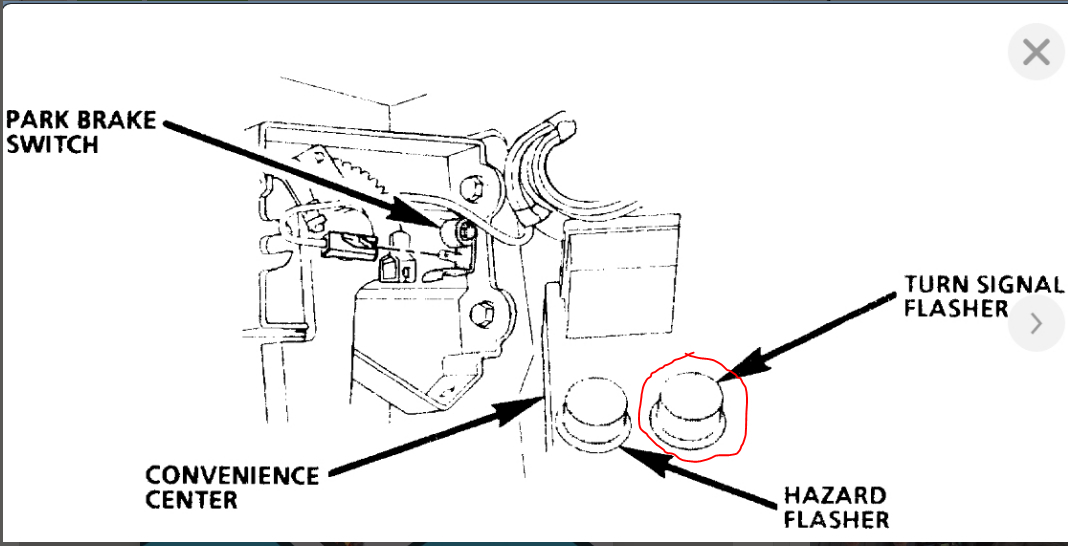

No relay clicks when turning on the turn signals.
Nov 22, 2019 at 8:40 PM
DANNY L
  • 5,648 POSTS
Hello again.
Yes the flasher is also known as the turn signal flasher relay. I've attached the picture again of its location under the dash on the left side next to the steering column. I've circled it in red.That will make the clicking sound you hear when the turn signals are activated.Hope this helps and thanks again for using 2CarPros.
