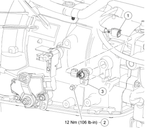

no shift or speedometer, ebrake light staying on on dash, giving o2 sensor code also no shifting when you drive stuck in 1st gear you can shift to reverse but no shifting when you drive and also no speed at speedometer, i repaired chewed wire on o2 sensor by my dog no damage to wires on speed sensor

This sounds like a classic "Vehicle Speed Sensor" that has gone out. Here is the location so you can swap it out. The sensor is on the left side of the transmission case. Check out the images (below). Please let me know what happens.
