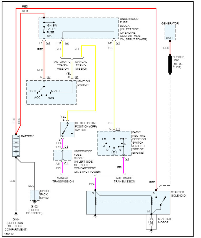

JDIRT14
Security light comes on during bulb test but nothing after that won't even come on when I try to start the car and no crank.
Jul 19, 2023 at 4:50 AM
  • 55,432 POSTS
Is the battery good? You may have a bad connection at the battery as well. There are no interactions with the starter and security system, please see the attached starter wiring diagrams and check out these two guides:
and
Check out the images (below). Please let us know how it goes.
