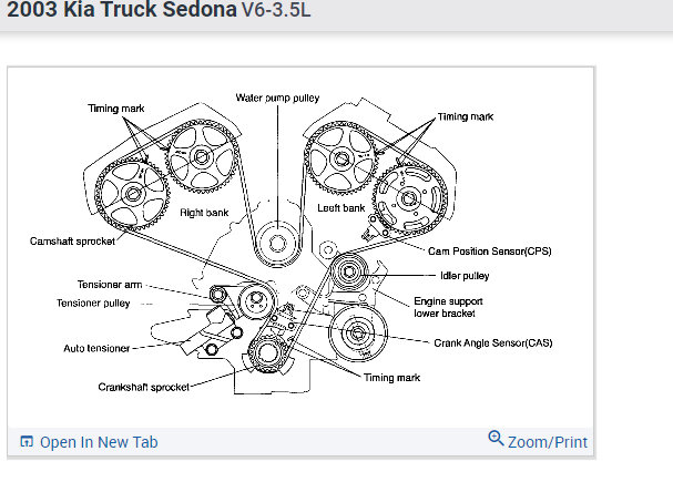

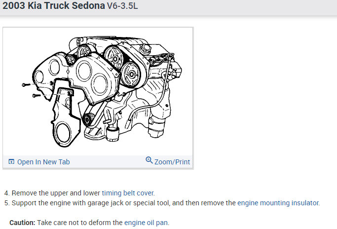

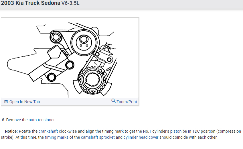

I started getting concerned about it breaking. I want to change the timing components belt idler tension-er pulley and the water pump since it was in that general area.
Jul 16, 2017 at 10:25 AM
SQM
  • 6,383 POSTS

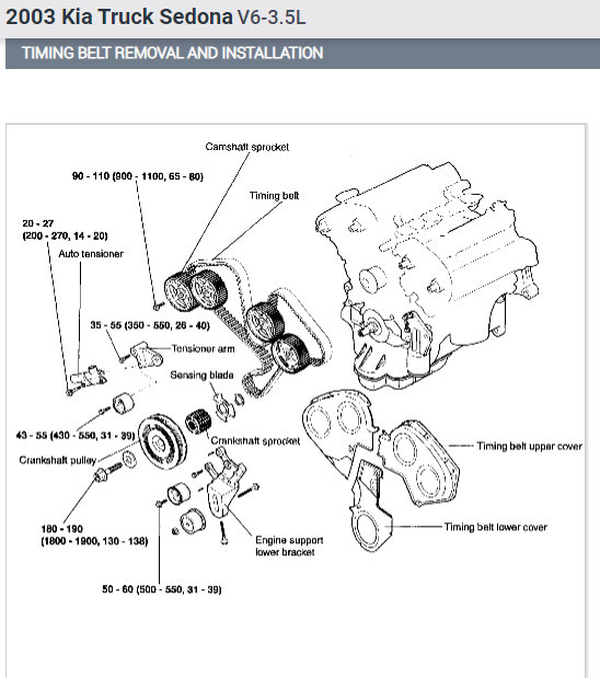

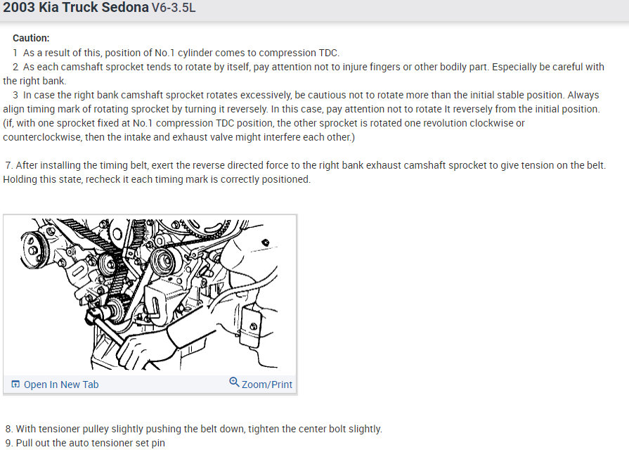

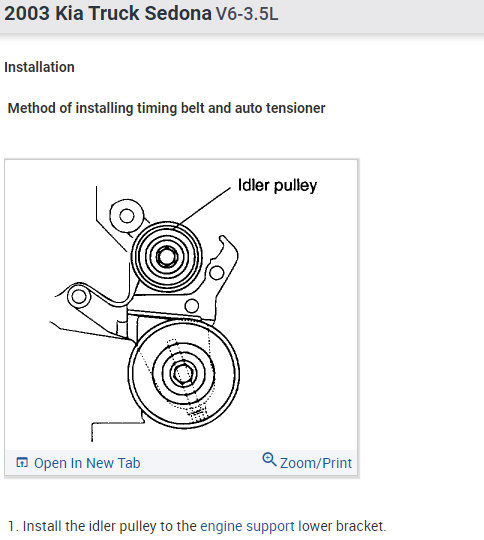

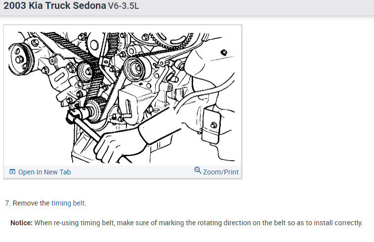

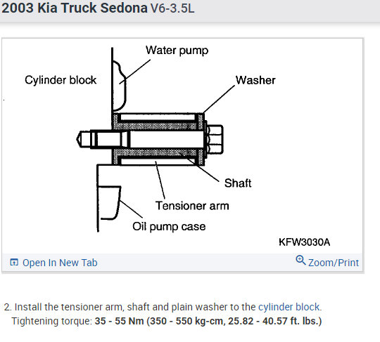

It is a good idea to change out the components as well as the water pump while you are there.
Here is a helpful video:
https://youtu.be/wqN-7xWSzDA

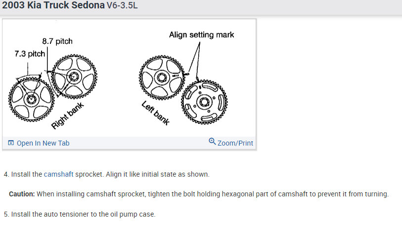

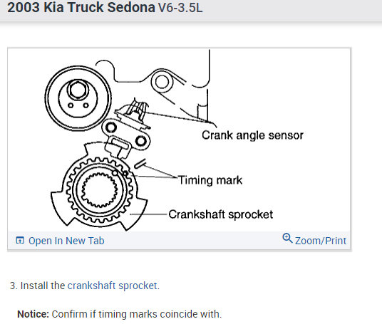

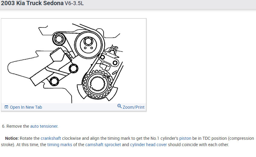

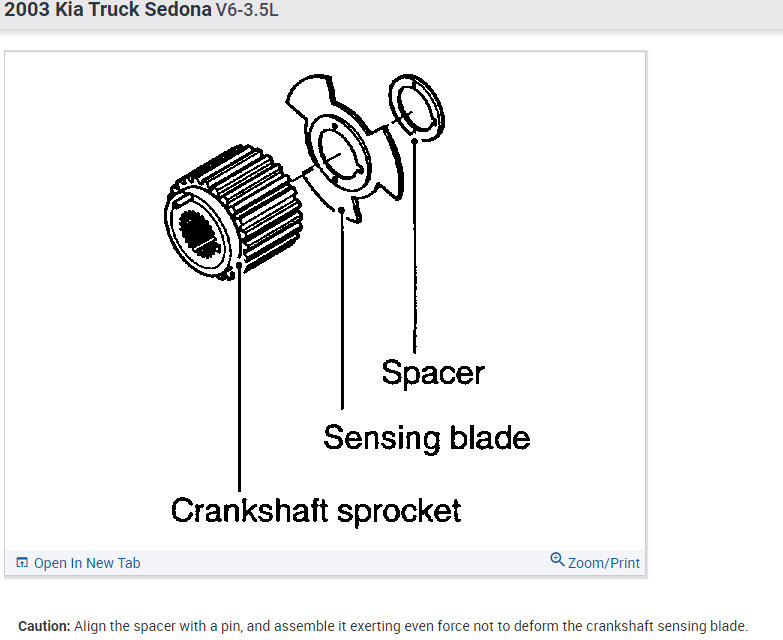

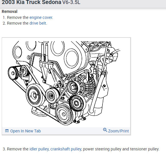

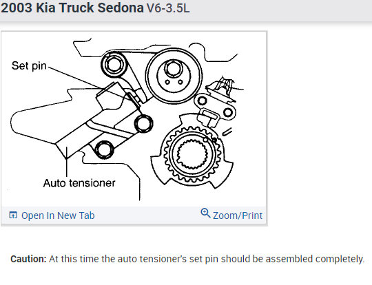

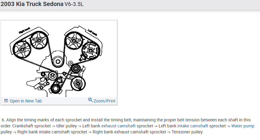

See attached for the replacement procedure.
