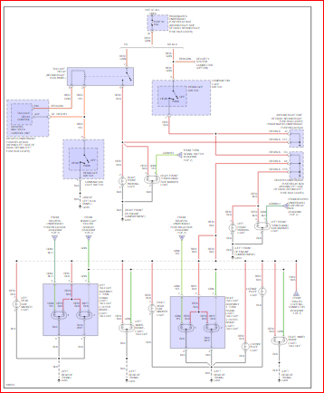

Turn on headlights, no tail light on passenger side. Brake lights and turn signals work on both sides. Switched new bulb and it works on opposite side ( bulb not the problem) switched bulb and holders and same issue. Passenger side still not working. Problem in wiring harness and connector? Why now? There is no fuse in driver side panel for daylights? There is an asterisk by daylight so I assume none is needed. Ideas?

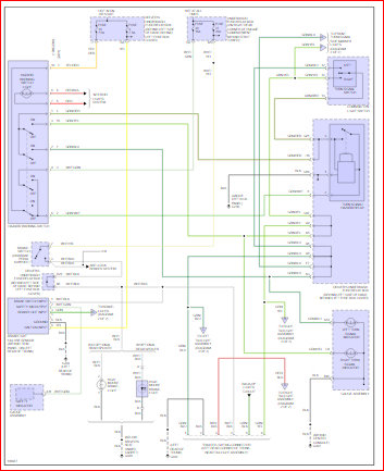

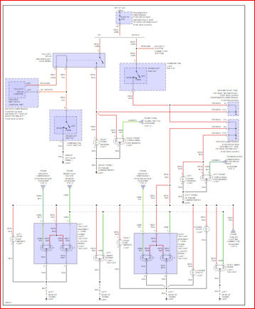

First think I suggest you check is the ground. Look for loose/broke/frayed/corroded wire. I have attached a tutorial for checking wiring and a diagram for your car. Hope this helps and feel free to ask any questions. Hope this helps and thanks for using 2CarPros.
