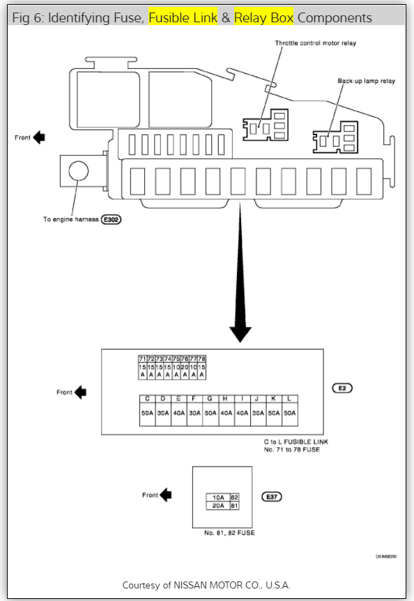

All the gauges in the cluster light up but do no work. The tachometer, speedometer gas or cooling are not working. The electronic prndl lock will not disengage unless I use the manual press button. The climate control and blowers stopped working too. I do have radio. What fuse blew and where is it located?

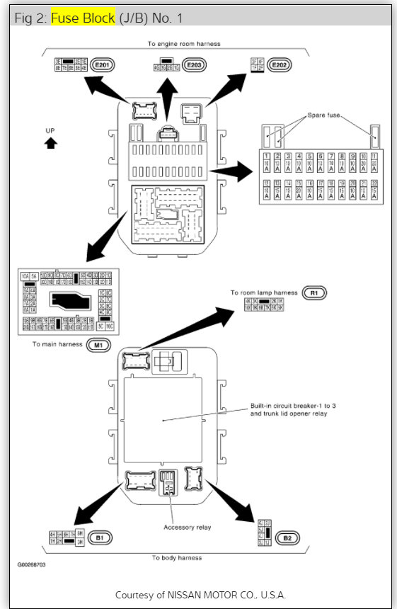

When fuses blows, it is best to check all because it could be multiple and they could be related. A test-light (preferably LED) would be the best aid you need to test fuses.

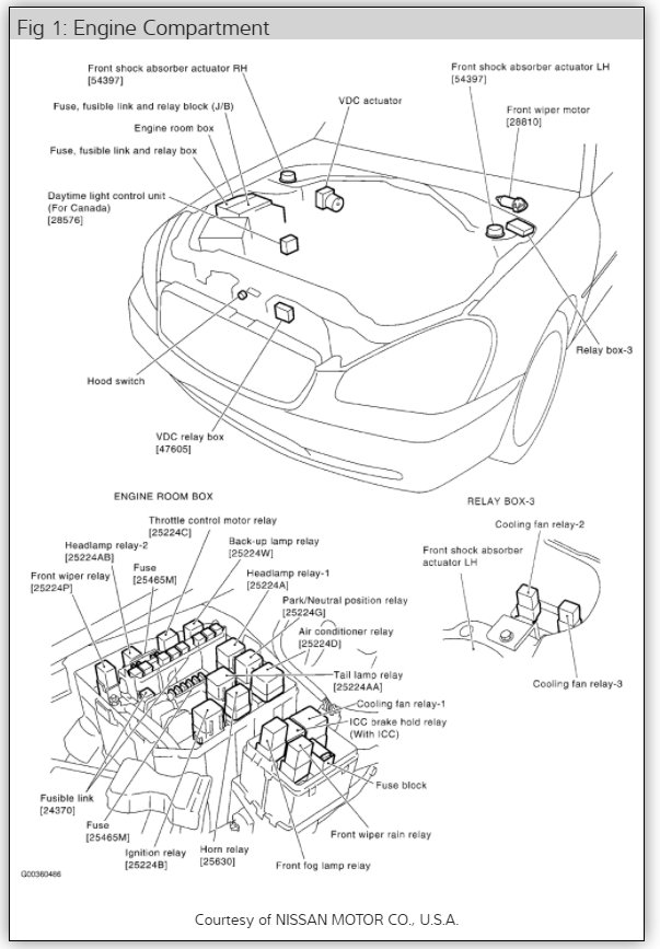

The fuse box and fuse location can be found in owner's manual. Fuse boxes are generally under dash at driver side and under-hood should be next to battery.
Fuses are easily available in parts stores but be sure to get the designated fuse and do not attempt to increase or decrease the stipulated amperage. You could have some spare fuses located in the fuse box if they have not been removed.

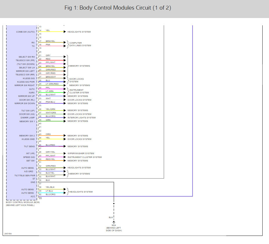

You mentioned the gear shift could not be moved unless you manually over ride it. That could mean the brake lights are not working. Get someone to depress the brake pedals while you check if the brake lights turn on. If brake lights works and all fuses are confirmed to be good, the next step to do is to get a diagnostic scan to check if there are any trouble codes and proceed accordingly.
This system is within body control section and normal scan tools do not work. The fault could be with the Body Control Module (BCM).

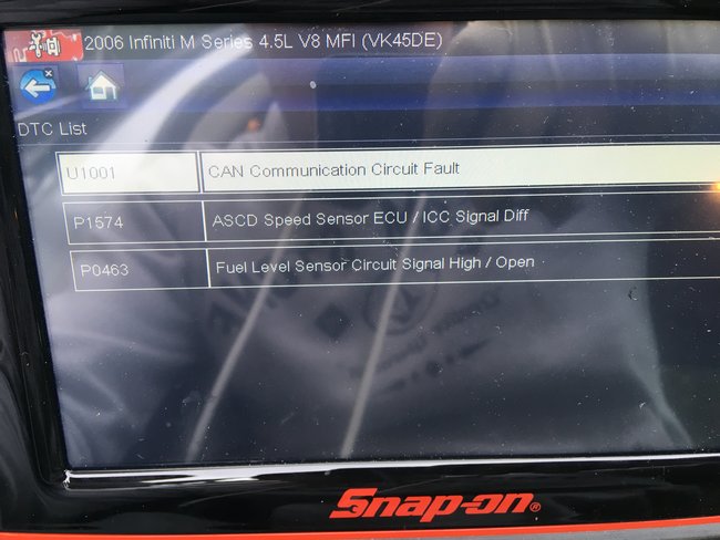

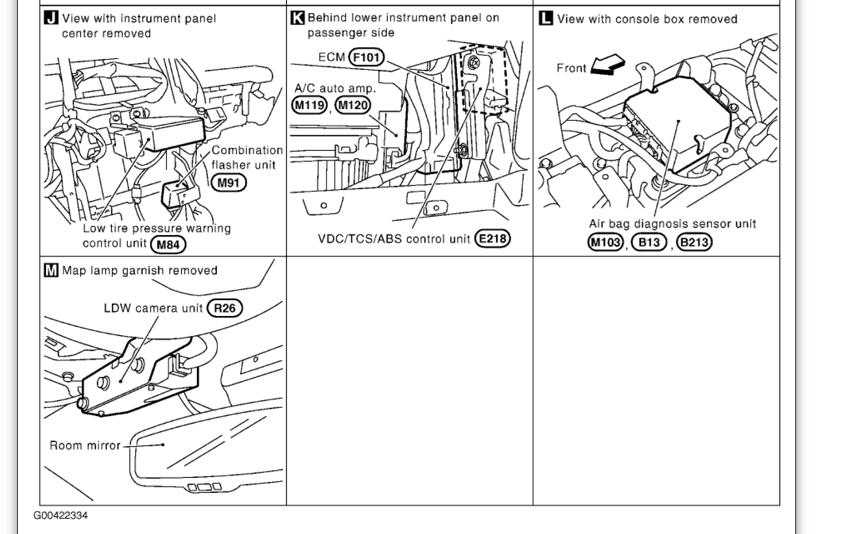

i scanned for codes and this is what i got. how do i get to/ check the bcm?
Dec 2, 2017 at 3:03 AM
  • 55,456 POSTS

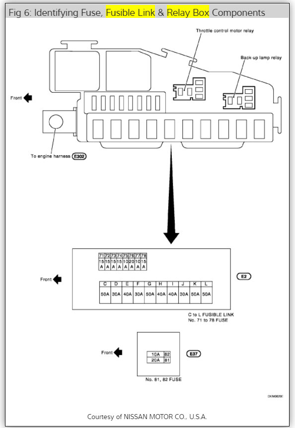

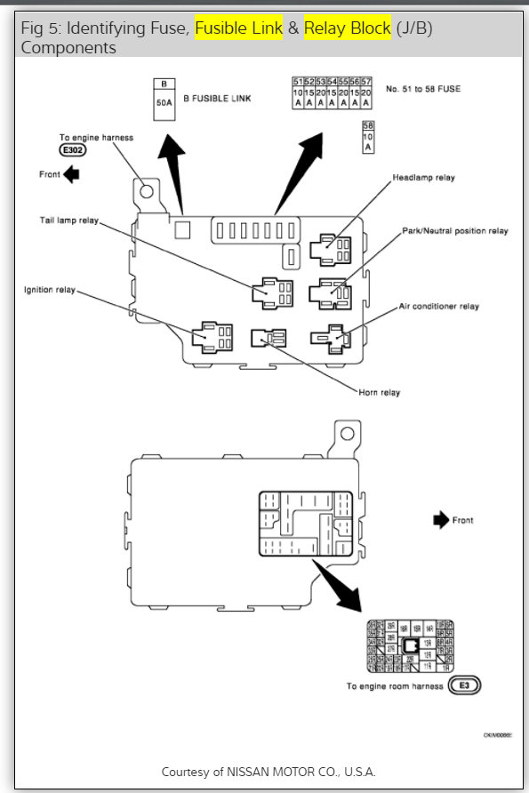

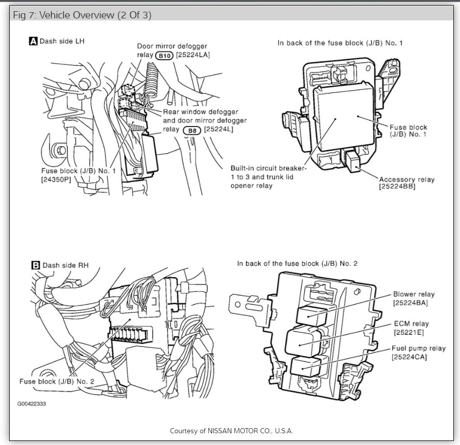

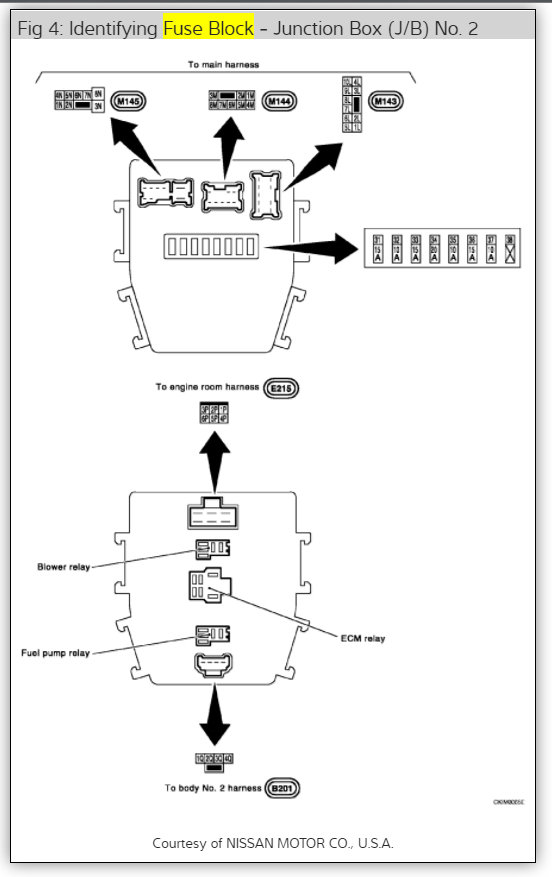

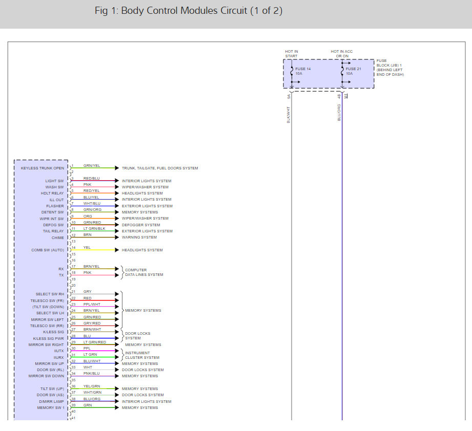

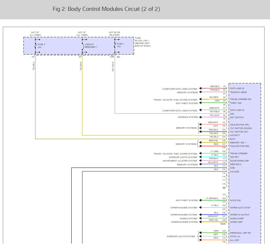

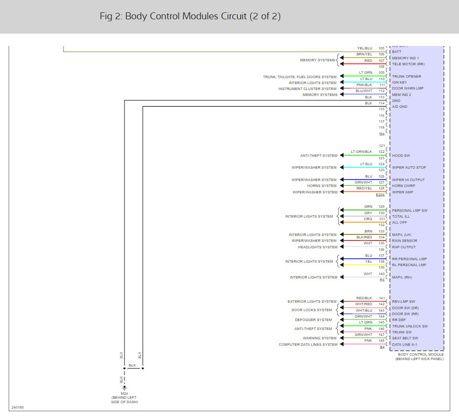

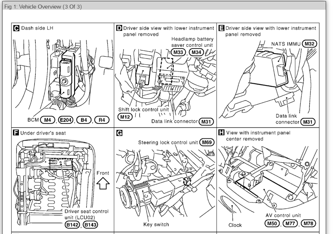

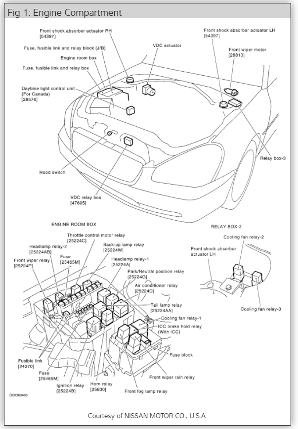

If I can jump in here it looks like you have one of two things that can happen. First is the BCM is out and not communicating with the network. Next is the BCM is not getting power or ground. It does have 5 fuses that run it. Here are two guides and some diagram (below) that will help you check it out. If the BCM is bad a shop will need to program it for you.
and
