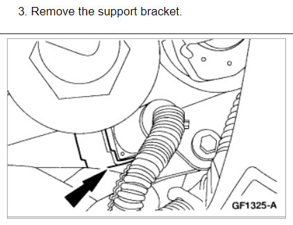

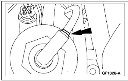

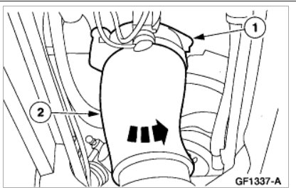

My air ride suspension was working fine until my battery had drained and I had to purchase another battery. then I started getting an error message saying that no ride control has been selected. I try to reprogram the driver half driver too, but I cannot seem to reprogram it. I was try too reset the ride control settings nothing seems to work. can you help me out?
Mar 11, 2018 at 12:55 PM
  • 55,433 POSTS
Yes,

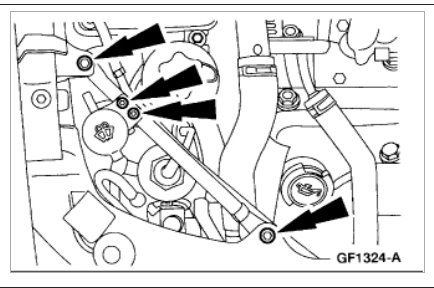

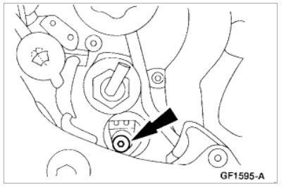

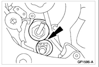

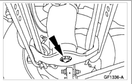

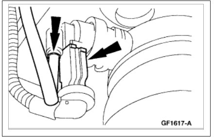

So what happens on these cars is the air ride shocks start to leak which causes the system system to engage for an extended amount of time which causes the error. Does the car sit low on one side or?
Also, I have seen where the pump motor gets water into it and takes out the air pump motor.
Use soapy water to spray on the airbags to see if you see bubbles.
Below are diagrams to help you see what I am talking about.
