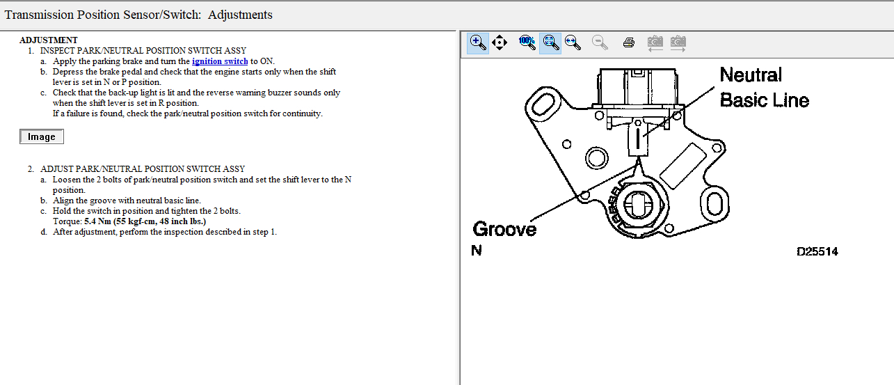

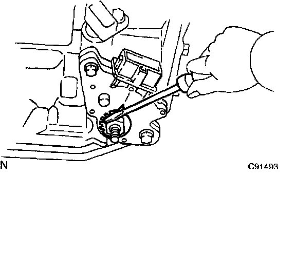

hello again,
Can you please check to see if the selector lever is on reverse, rear reverse lights work? if not perform adjustment as described the procedure and diagrams below.
thank you.
