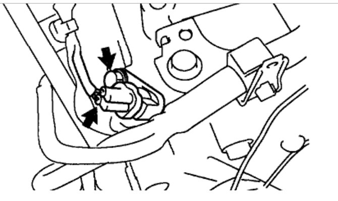

Did you resolve that no reverse problem? I have a 2000 Camry with the same problem, all of a sudden, no reverse. I shift into reverse & engine revs, but no movement, no problem in drive. Automatic

KEN L
  • MASTER CERTIFIED MECHANIC
  • 48,363 POSTS
Yes it sounds like the reverse gear shift solenoid or a speed sensor has gone out and needs to be replaced.
Here is a diagram to show you how to get the job done. (Below)
