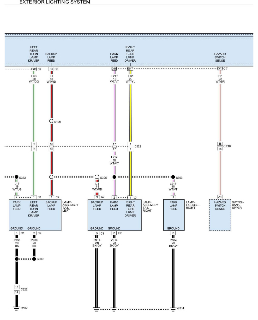

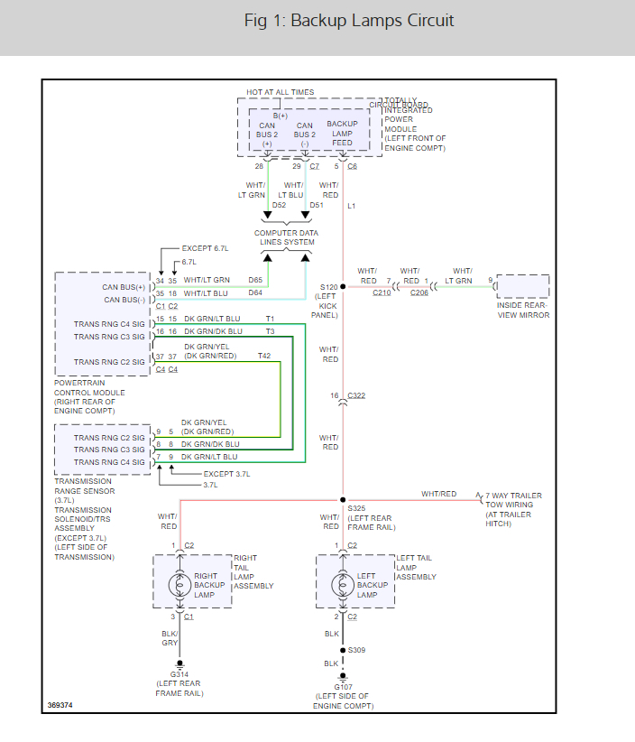

I have no reverse back up lights. I also can't find the NSS to replace it. Can you show me a picture please?

First, I'm attaching a tutorial showing how to test your trucks wiring.
Also, I've attached below a picture of your trucks reverse light circuit.Hope this helps and thanks for using 2CarPros.

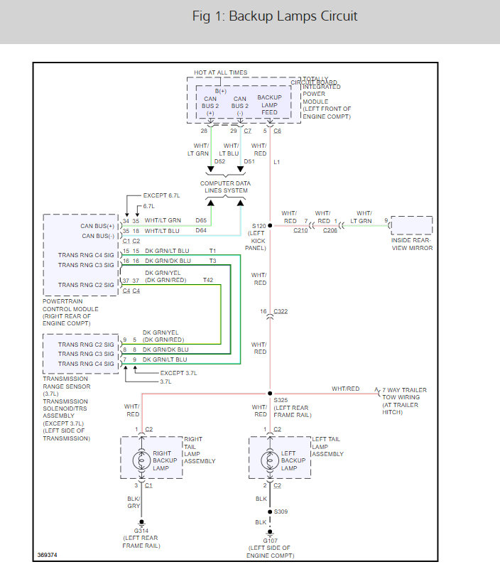

All the wiring looks fine the bulbs are good. Where else should I be looking? Is there a sensor somewhere else like on transmission?

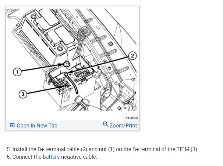

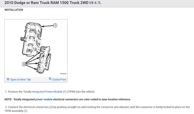

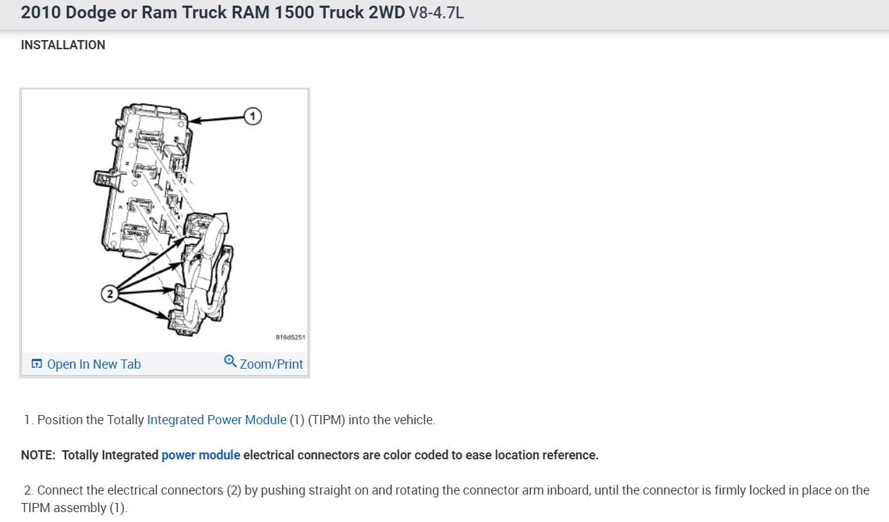

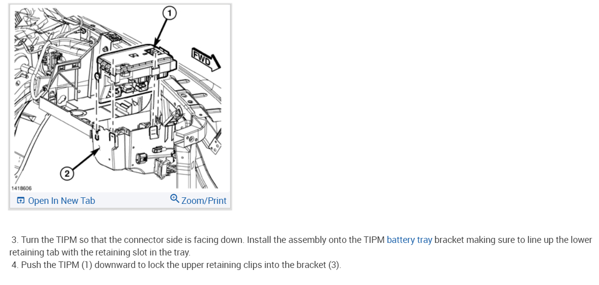

If I can jump in here. it sounds like the TIPM is out. To be sure use this wiring diagram to check for power with the guide on how to use a test light. It easy to replace the TIPM because it self initializes. Here are diagrams and instructions on how to replace the TIPM below.
