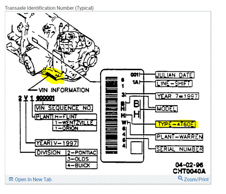

Reverse went out and whining in park and neutral. No check engine light. Changed out filter and still some results. Fluid wasn't really bad for 22127.
Feb 15, 2022 at 9:09 PM
  • 110,248 POSTS

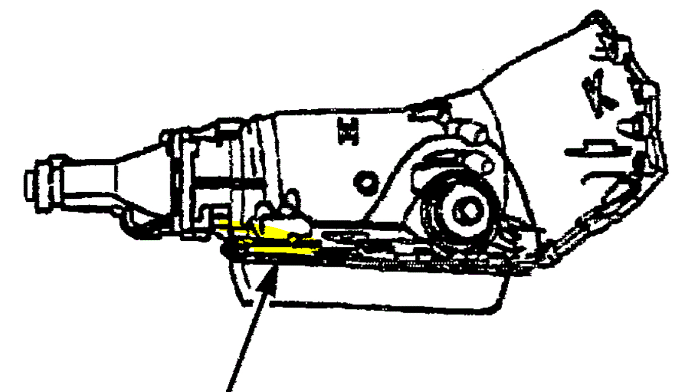

The idea that you lost reverse and are hearing a whining leads me to believe there is a line pressure issue. Reverse gear requires the highest amount of line pressure to operate. By chance, did you flush the transmission cooler?
I will be happy to provide directions, but I first need to identify which transmission you have. It will be either a 4L60E or a 4L80E. If you look at the pics below, it shows where to check to identify which one you have.
Let me know when you get a chance.
