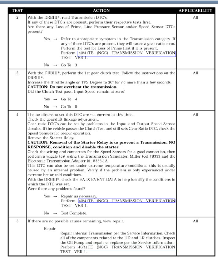

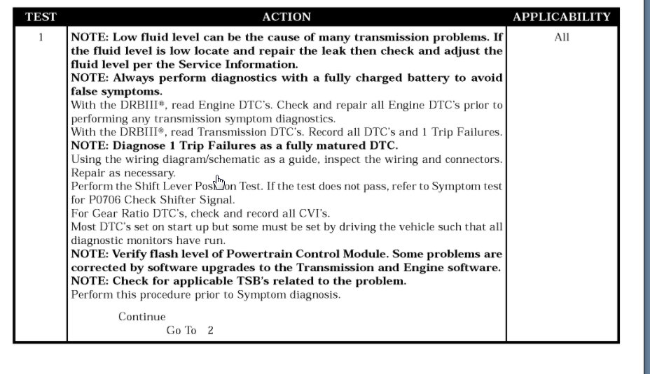

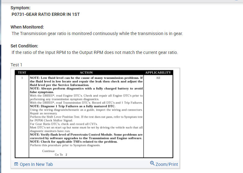

Below is the process from the manual for this code. The P0700 code is just telling you that you have a transmission code so we need to focus on the testing for the P0731 code.
Please run through this material and let us know if you have questions. Thanks
