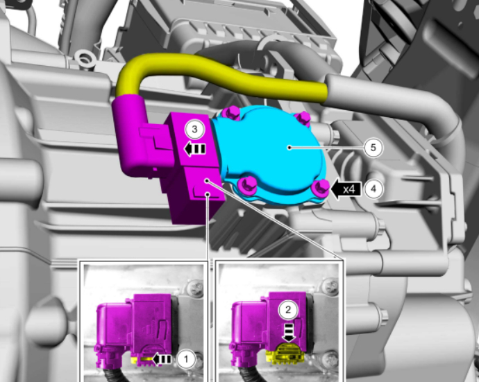

When shift lever placed in Reverse, it does not engage. The car will not move. Engine revs but no movement.
Mar 13, 2026 at 9:26 PM
  • 55,433 POSTS

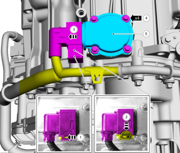

So this transmission is a dual clutch so the reverse is controlled by the shift actuator which fail often on these cars. But can I ask if the reverse indicator is on when you have the transmission in reverse? If not, the transmission range sensor can be bad but if it does light up I would replace the shift actuators, they replace them in pairs. Here is what they look like. I would run the codes as well, this can help you may have a:
P0902 / P090C - Clutch actuator circuit
P07A5 - Clutch stuck
P2831-P2836 - Shift fork issues
https://www.youtube.com/watch?v=LBCpCWEFnTg
