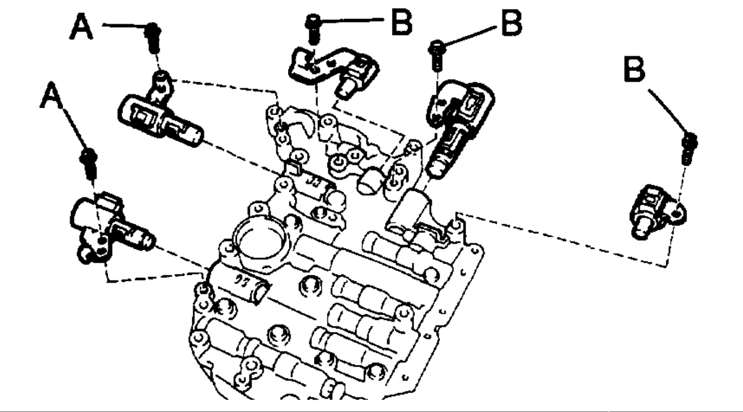

Need to know out of the 5 solenoids which solenoid involves the reverse gear.
Apr 16, 2021 at 3:34 AM
Good morning,

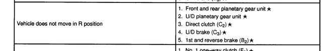

None of the solenoids control reverse operation. This is mechanical and there is no electronic control for engagement.
I attached a chart below for no reverse for you. It is an internal failure in the transmission itself.

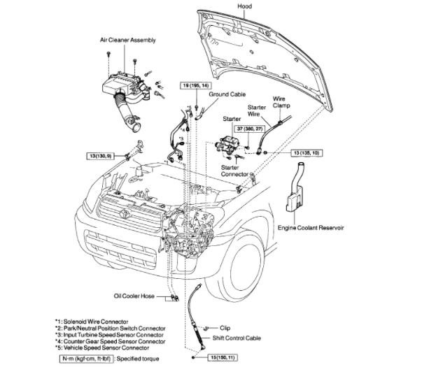

I attached a picture of the location of the solenoids in the valve body for you as well but again, none of them control reverse operation.

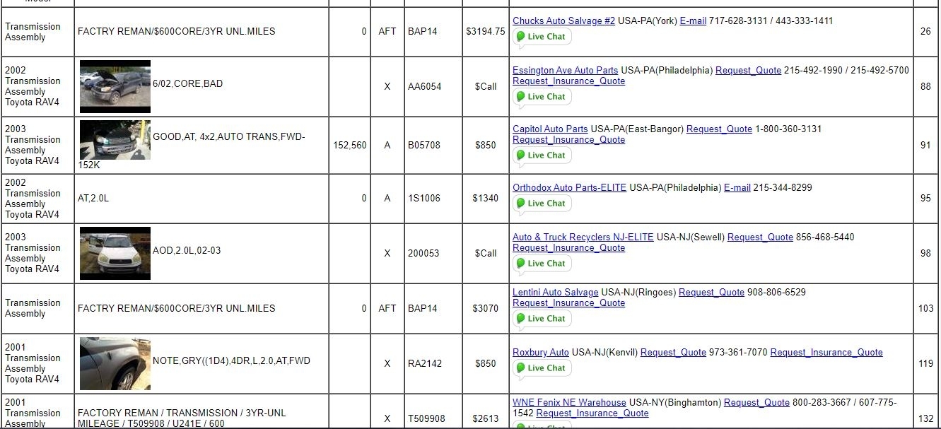

Might as well buy second hand transmission, but I need to know what's interchangeable. can you assist on the year?
Apr 24, 2021 at 12:49 PM

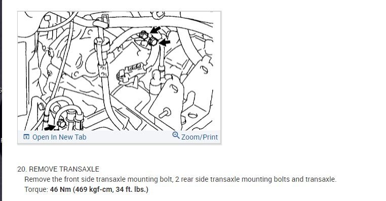

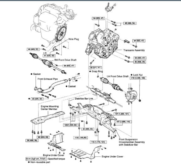

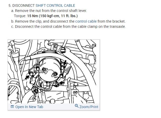

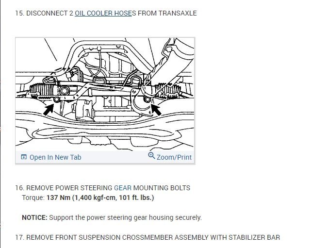

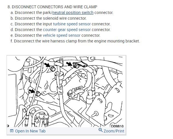

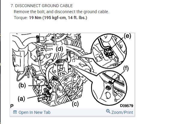

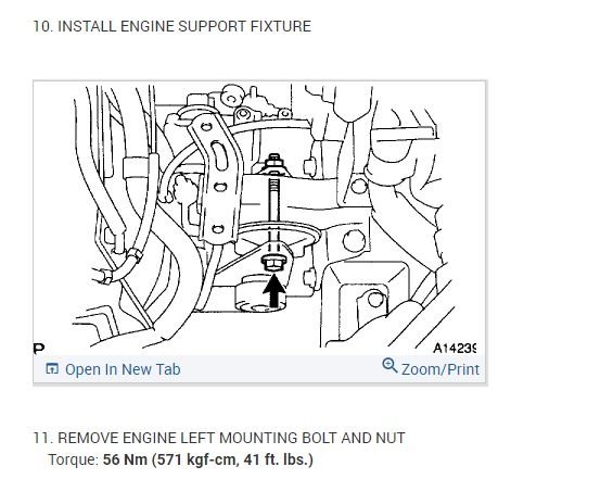

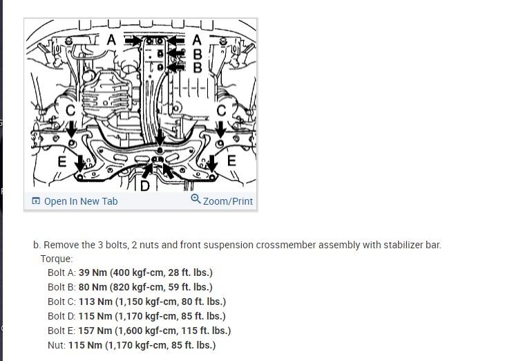

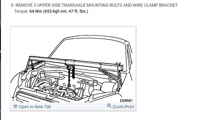

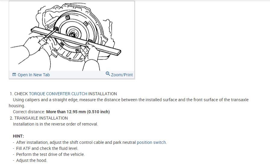

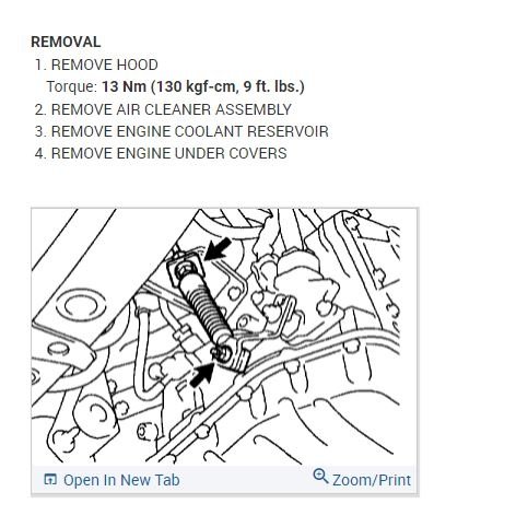

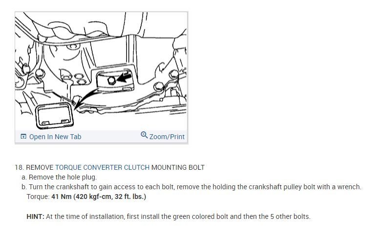

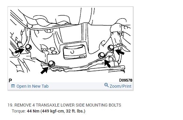

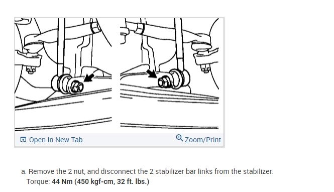

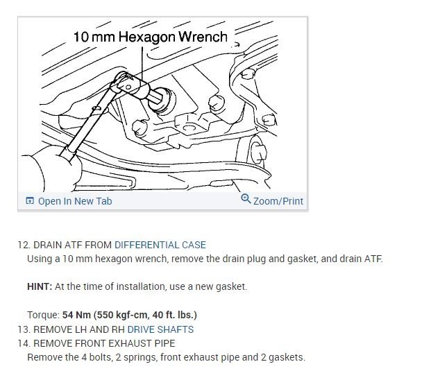

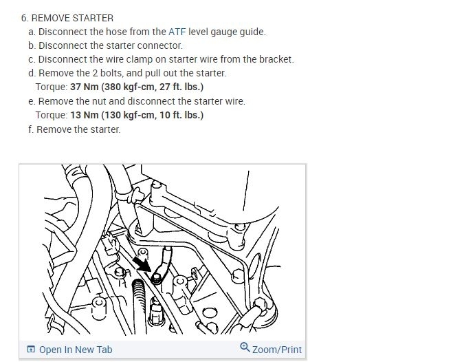

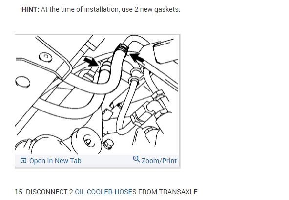

I attached a website for getting a transmission. Enter your information and zip code and it will list all the yards with transmissions for you.
WWW.car-part.com
I attached the procedure for you below.
