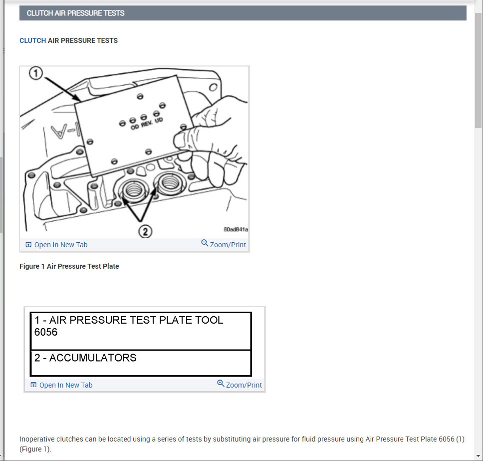

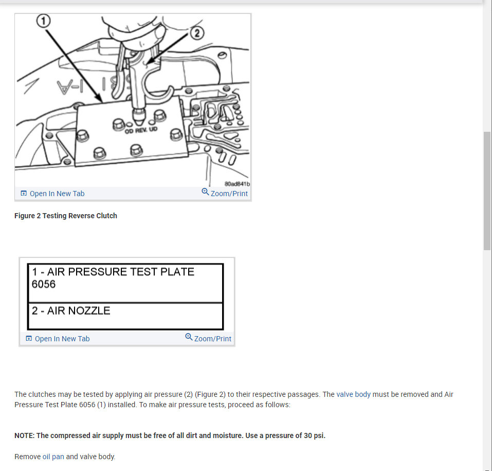

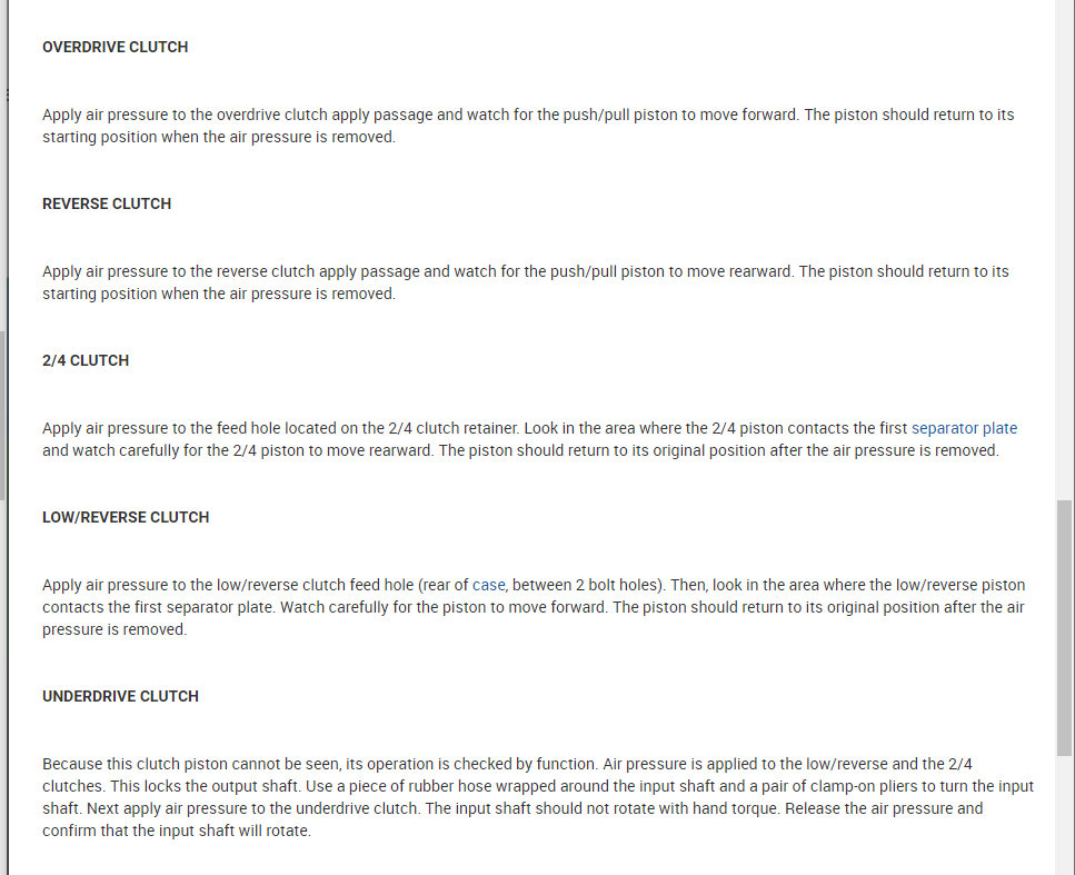

At this point we need to drop the pan and inspect for metal and more then likely it needs a pump, torque converter, and valve body.
This is not extremely common but I have seen it enough on this vehicle to know that this is what will be needed.
To confirm this is all that is needed, we need to do what is called an air check. This requires the valve body to be removed and then apply air to the channels and make sure the clutches clunk and that proves the seals are okay.
