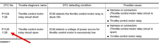

Car temperature went up while driving. There was not enough coolant and the coolant added up. Starting and idle okay. No acceleration. Diagnosis code is P1126 (electronic control throttle control signal system (feedback system).
Jun 4, 2017 at 9:14 PM
HMAC300
  • 48,601 POSTS
we do not have that model in US, it is the throttle control motor relay which is controlled by ECM. i am using data from an Altima. here is diagnostic chart for that code what to check. hope it helps.

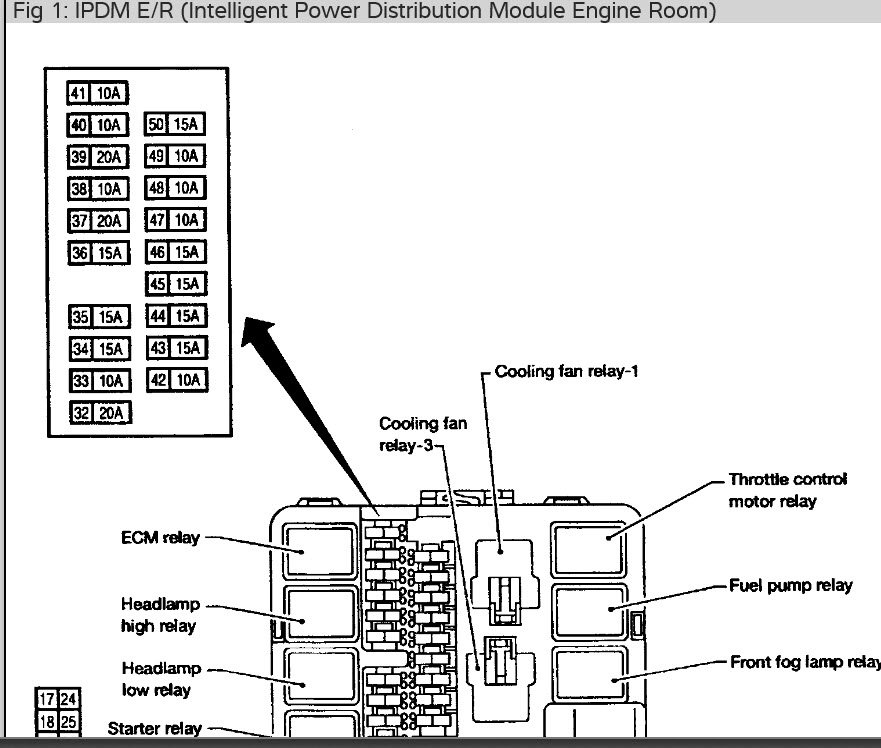

Could you tell me the location of the relay? I couldn't find it under the hood.
Jun 7, 2017 at 12:06 PM
HMAC300
  • 48,601 POSTS
well it may not have one because we are not using the correct diagram if you have a an intelligent power module under hood it is in there see pic. it may be marked on your model.like I said this is from an Altima here in US and yours may not have it which we have nothing for.
Jun 7, 2017 at 10:51 PM
HMAC300
  • 48,601 POSTS
pic wouldn't load
