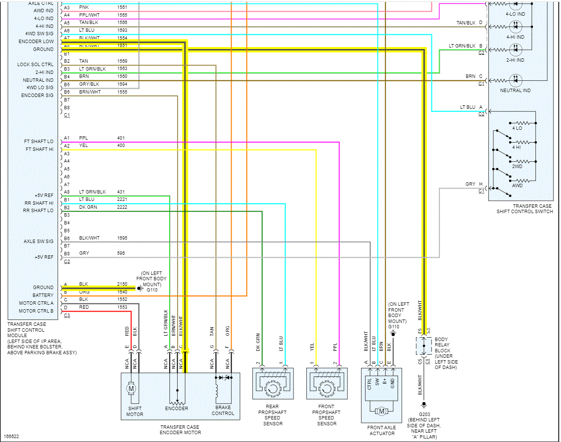

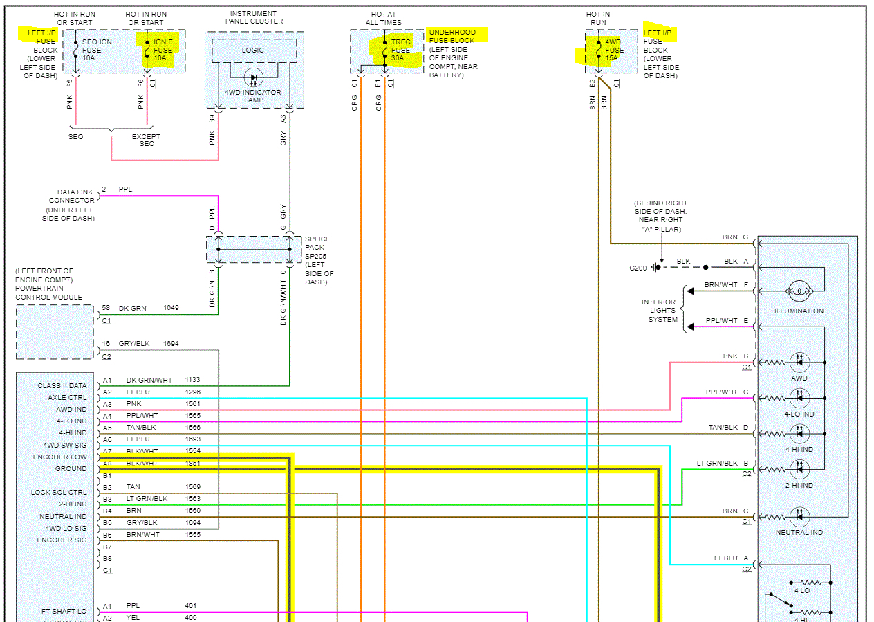

First, I attached the wiring schematic below for the circuit. You didn't mention testing the TREC fuse or the ignition E fuse. I highlighted them below. Their locations are indicated on the schematic.
Next, I highlighted two ground locations to check. Check them as well. Here is a link you may find helpful:

I checked the TREC and IGN-E fuses, they're both good and have power to them.
I think the TCCM ground on the left front body mount is the one I already checked. But I can't find the ground wire that goes to the "body relay block" and then "near left A pillar". I have the whole dash apart but can't see a ground back in that area.
I'll try testing the pin on the TCCM connector if I can find the right one.

Update: I think I found the ground; it looks okay based on visual inspection and I hope that I don't have to take it apart because it's really far back and there's no room to work in there.

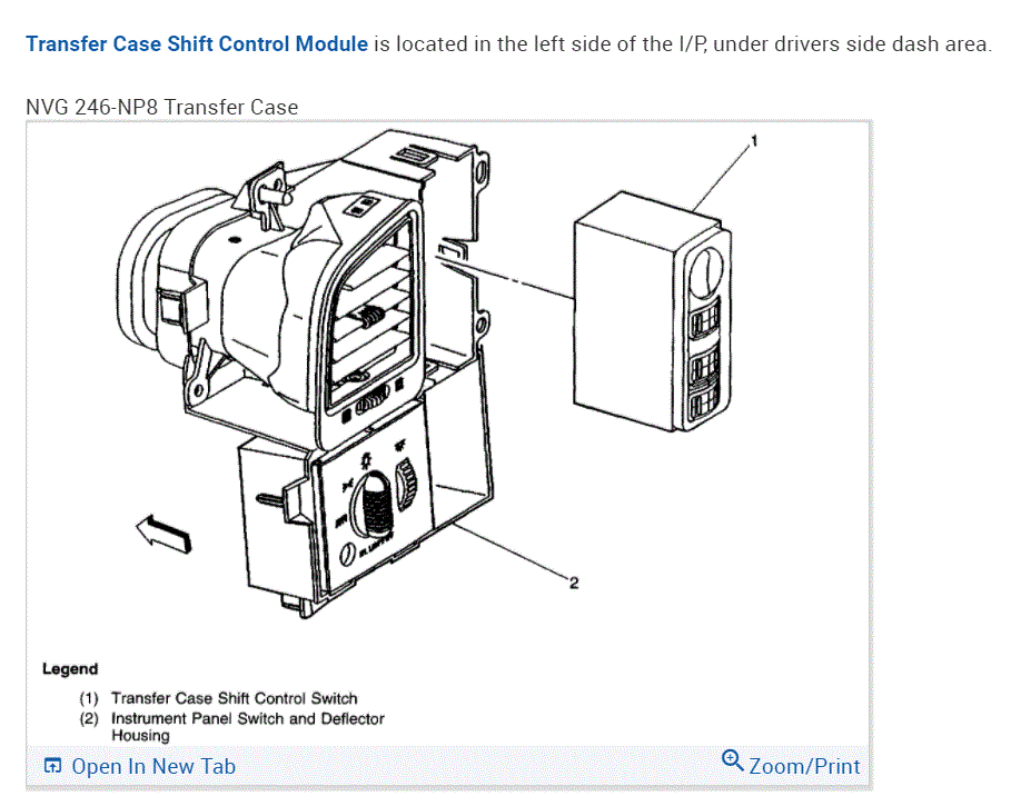

As far as the TCCM, I attached a pic below showing where it is located (at least according to my manual).
As far as your questions, there could be an issue with the module itself or even the switch. But I feel if the switch were the issue, the light wouldn't be on.

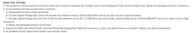

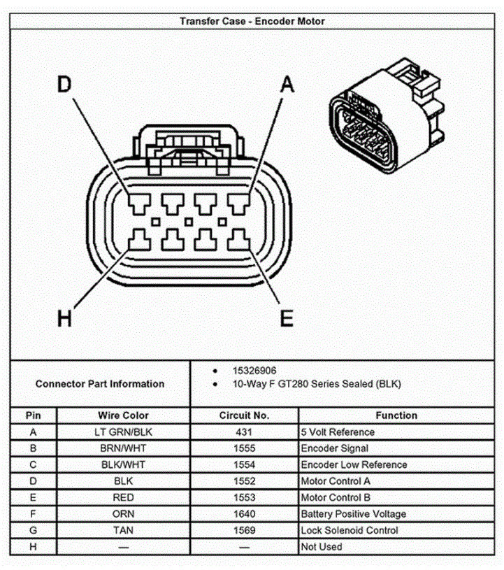

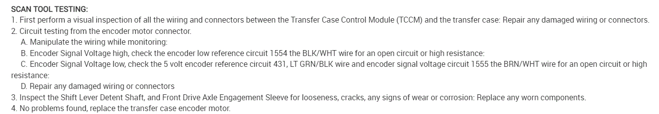

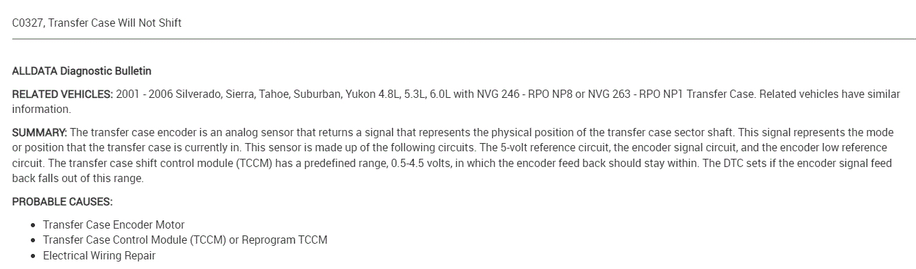

The best thing to do would be to scan the can-bus system to see if there is a code stored. CAN stands for controller area network. Basically, all computers/modules are tied together via a few wires. This type of scan would identify codes regardless of the module in which they are stored. Here is a link explaining how it's done:
Also, I attached diagnostics below for when the transfer case won't shift. See if they help.
