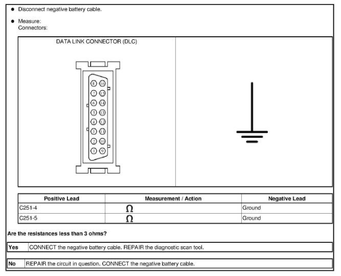

Can not get the starter to respond.
When you activate the start button while holding the brake, error displays on dash Engine Fault Service Now. you OK off this screen and it is followed by the following.
Blindspot left sensor fault Service Required
Blindspot right sensor fault Service Required
Cross Traffic Fault Service Required
Hill Start Assist not available.
Battery has been changed, Starter removed, and bench tested. I have absolutely no response at the starter and i am unable to connect to the OBD2 port, it tells me unable to connect on my mac scanner.

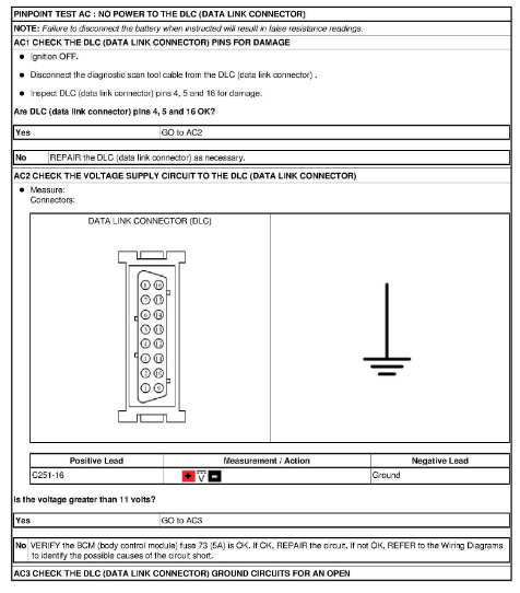

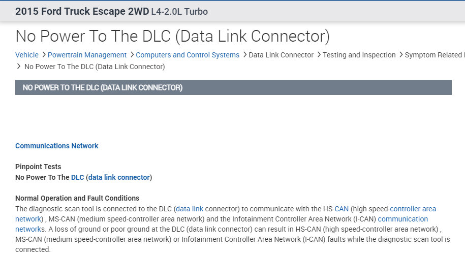

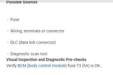

Based on the list you have, my first thoughts are the body control module (BCM) is failing.
If your scan tool is not working, we need to determine why it isn't getting power. I attached the diagnostics below related to the DLC. Take a look through them and let me know if you are comfortable performing them.
Let me know
