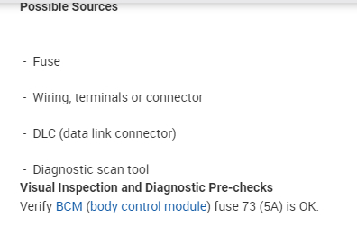

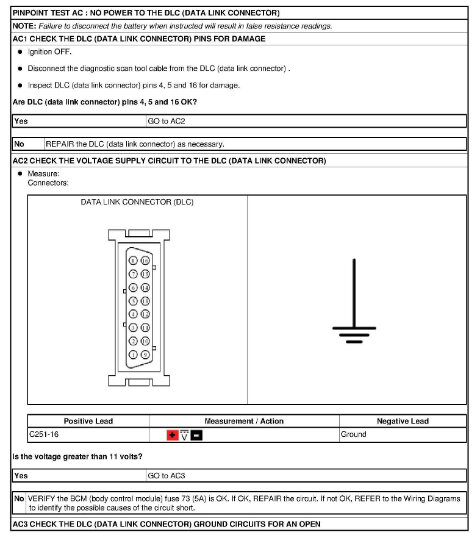

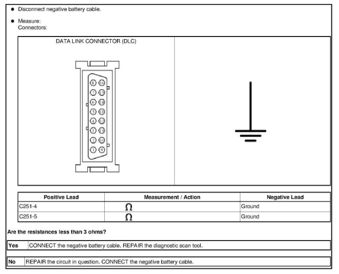

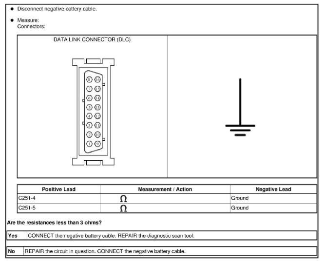

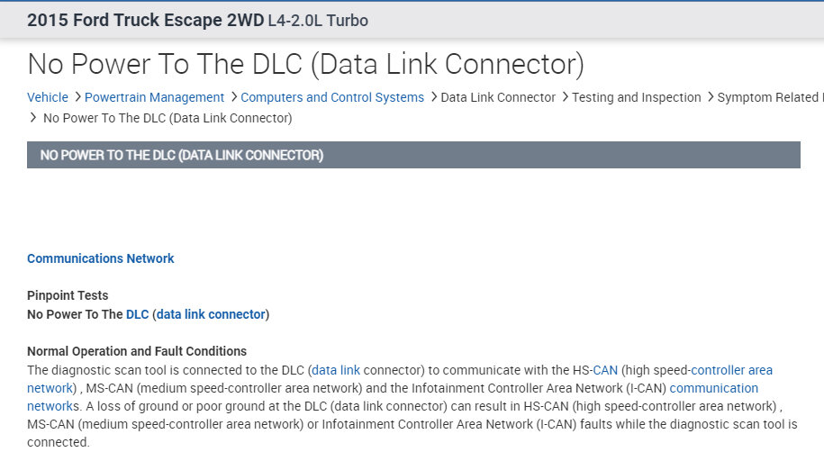

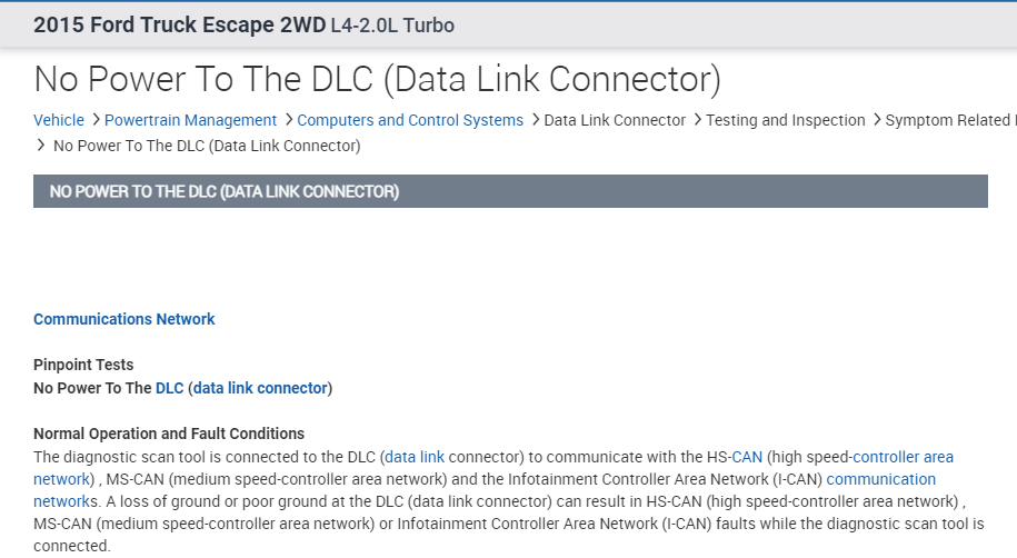

Based on the list you have, my first thoughts are the body control module (BCM) is failing.
If your scan tool is not working, we need to determine why it isn't getting power. I attached the diagnostics below related to the DLC. Take a look through them and let me know if you are comfortable performing them.
Let me know
