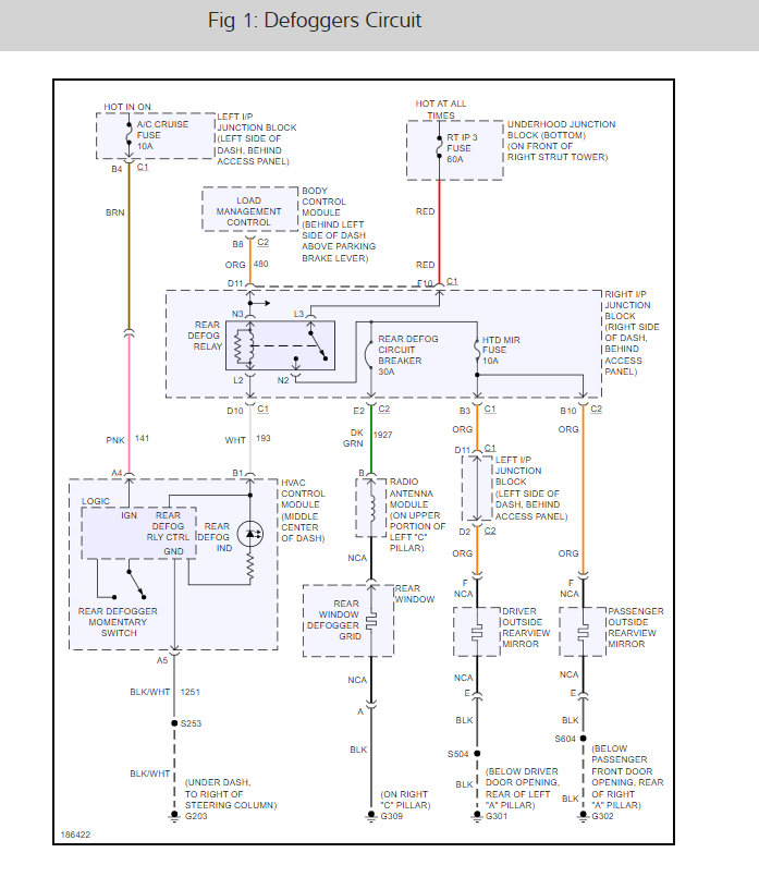

How many terminal on the relay should be hot? And is the heated mirror fuse have anything to do with it? Thanks
Sep 5, 2019 at 11:22 AM
Experienced Mechanic
55,604 POSTS
It should be two.here is the wring diagrams and a guide to help you test the relay:
