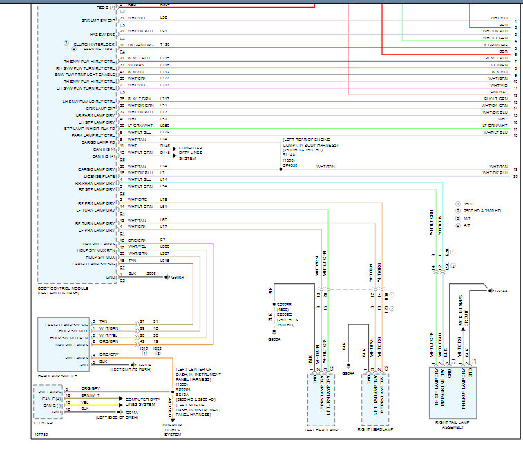

The front half works fine. The trailer connector is getting power and working fine. Taillights and brake lights work fine. Any ideas?

This could be a problem with your vehicle's Body Control Module (BCM). Is your vehicle's Malfunction Indicator Lamp (MIL)] or "check engine" lamp illuminated? If it is can you please retrieve the Direct Trouble Code (DTC) for us. Here is a link below for you to go to if you are unfamiliar with how to do it:

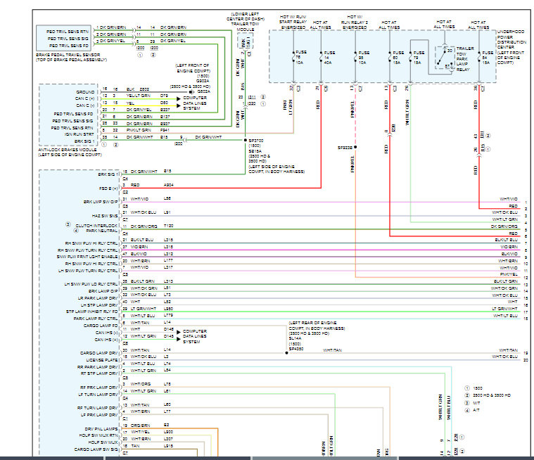

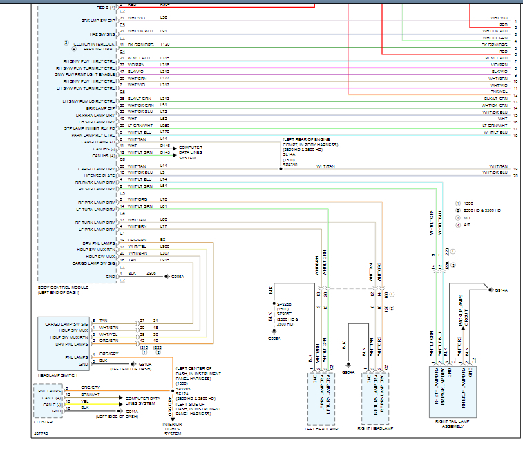

I have included a wiring diagram of your vehicle's exterior lighting circuits for your reference in the diagrams down below. Please get back to us with what you are able to find out.

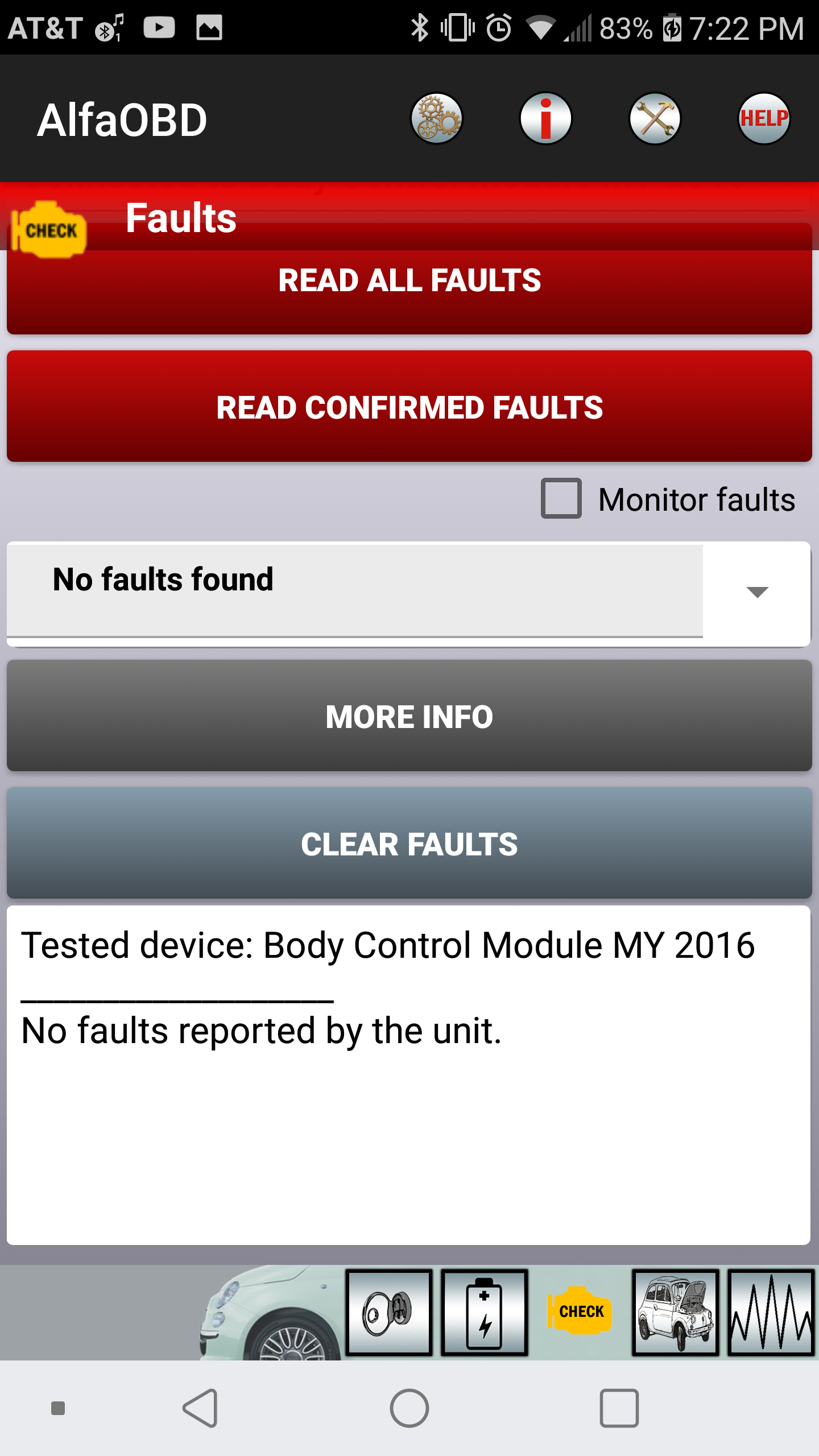

I do not have any trouble code or lights on the dash from it. Appreciate the images but they are blurry to read. If I disconnect the Battery as well for 30 minutes will that help?

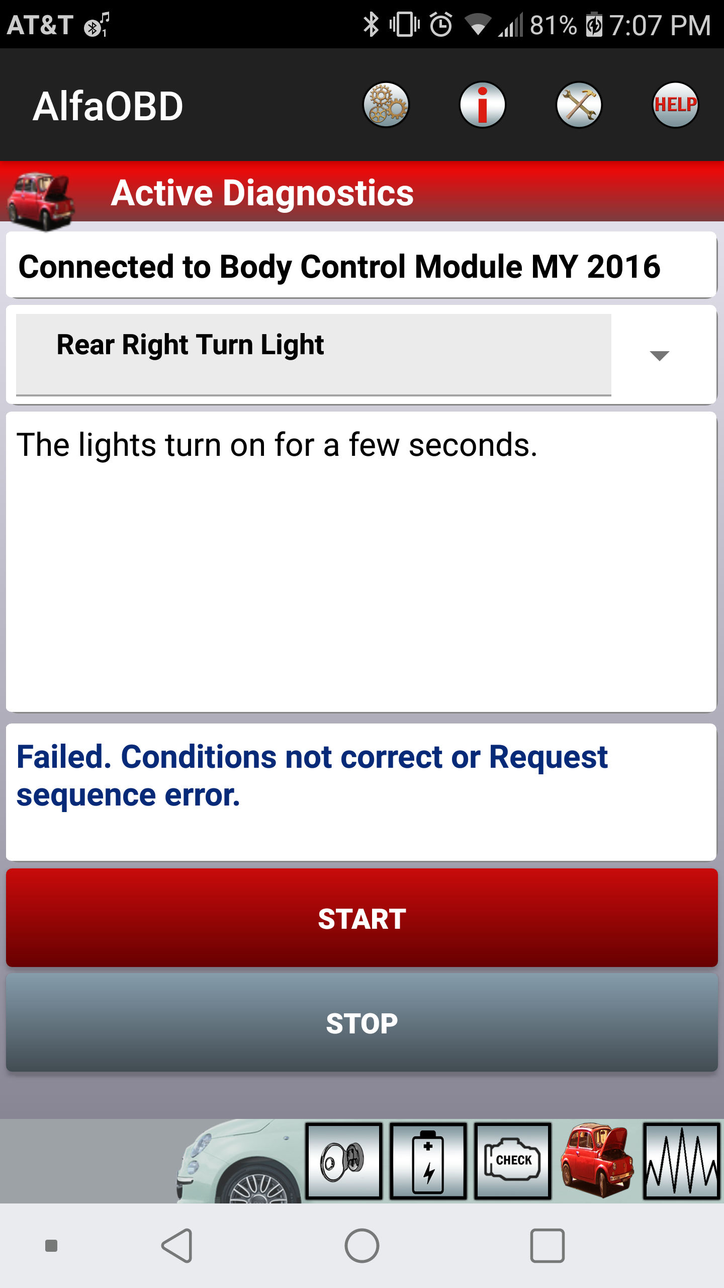

This is what I get through the AlfaODB. I am going to disconnect my battery see if that helps

I fixed it. The combo rear lighting was set to off in the computer switch it to yes and it works now.
