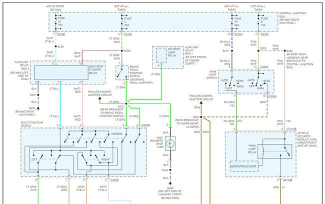

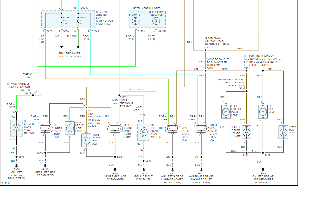

My rear blinkers, brake and hazards are not working. I have checked fuses, and replaced flasher relay and brake light switch. what could it be?
Jun 30, 2017 at 2:26 PM
SQM
  • 6,383 POSTS
This sounds like you might have a wiring issue.
It probably has a short in the harness.
In order to find the short you will have to trace the wires using a multimeter.
Here are couple of helpful articles:
I have attached the wiring schematics for the exterior lights.
